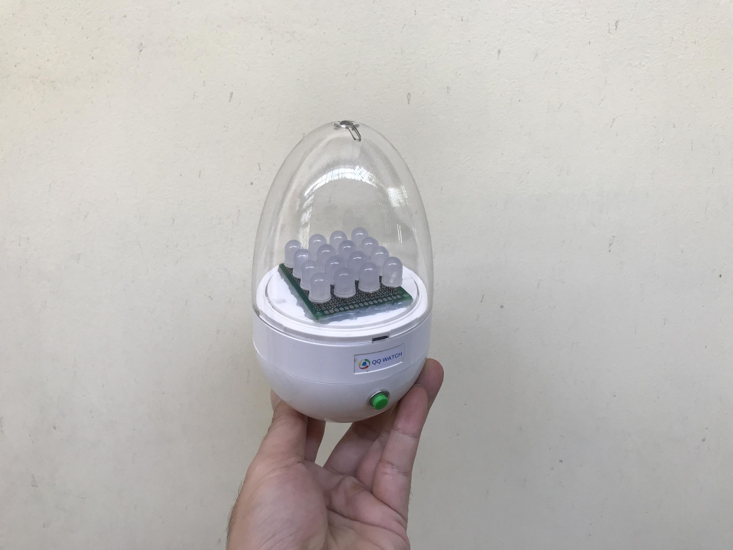

I stuffed 16pcs x RGB leds 10mm and control board into the watch box. ATTiny85 microcontroller was used in this project to control RGB led and one push button for mode selection. The schematic is shown on the image above.

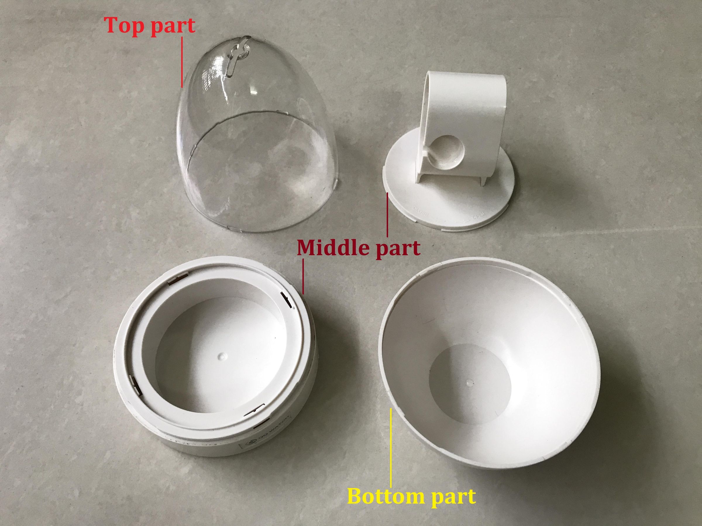

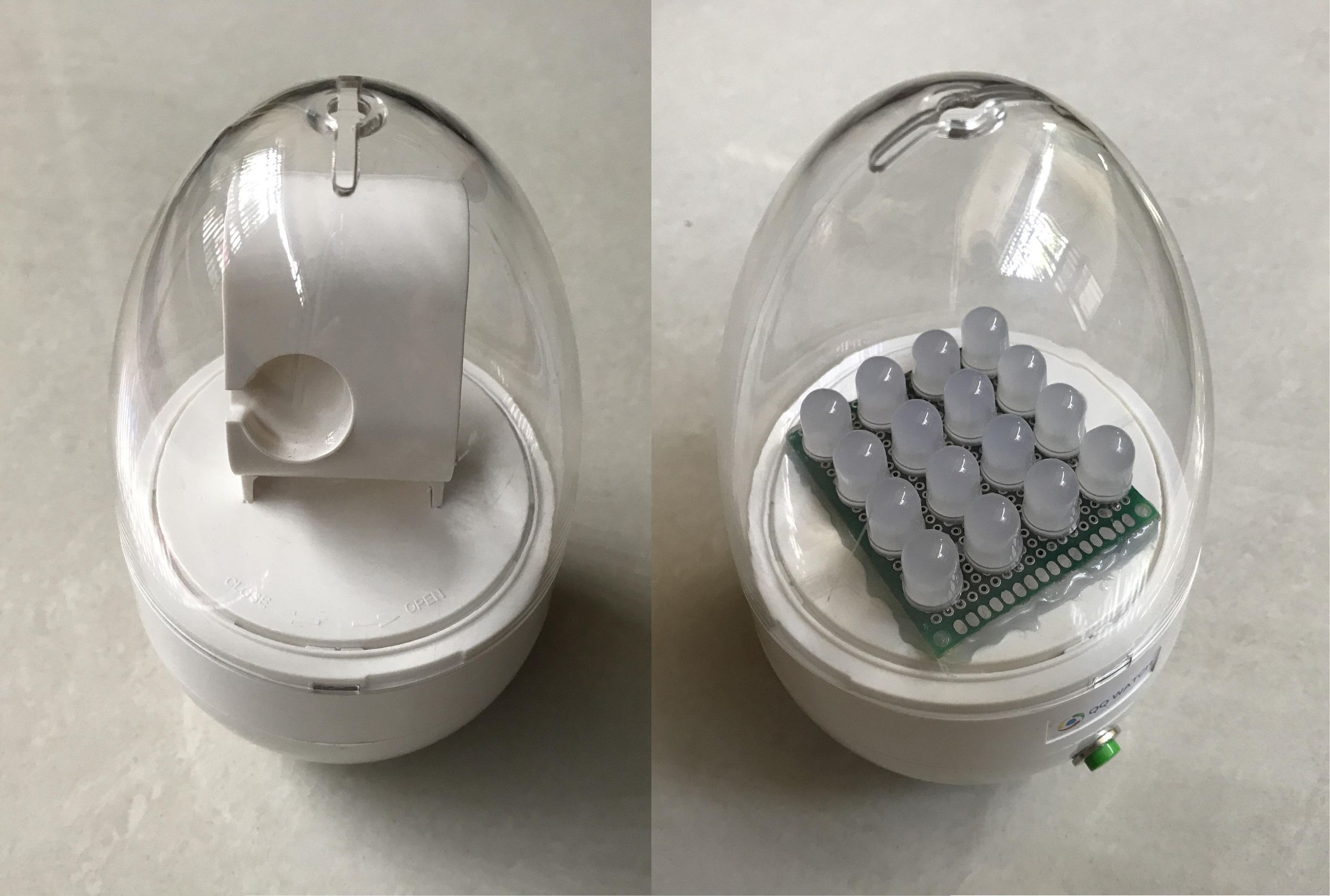

I disassembled the watch box parts and measured the dimensions. It fits with 5x7cm PCB protoboards.

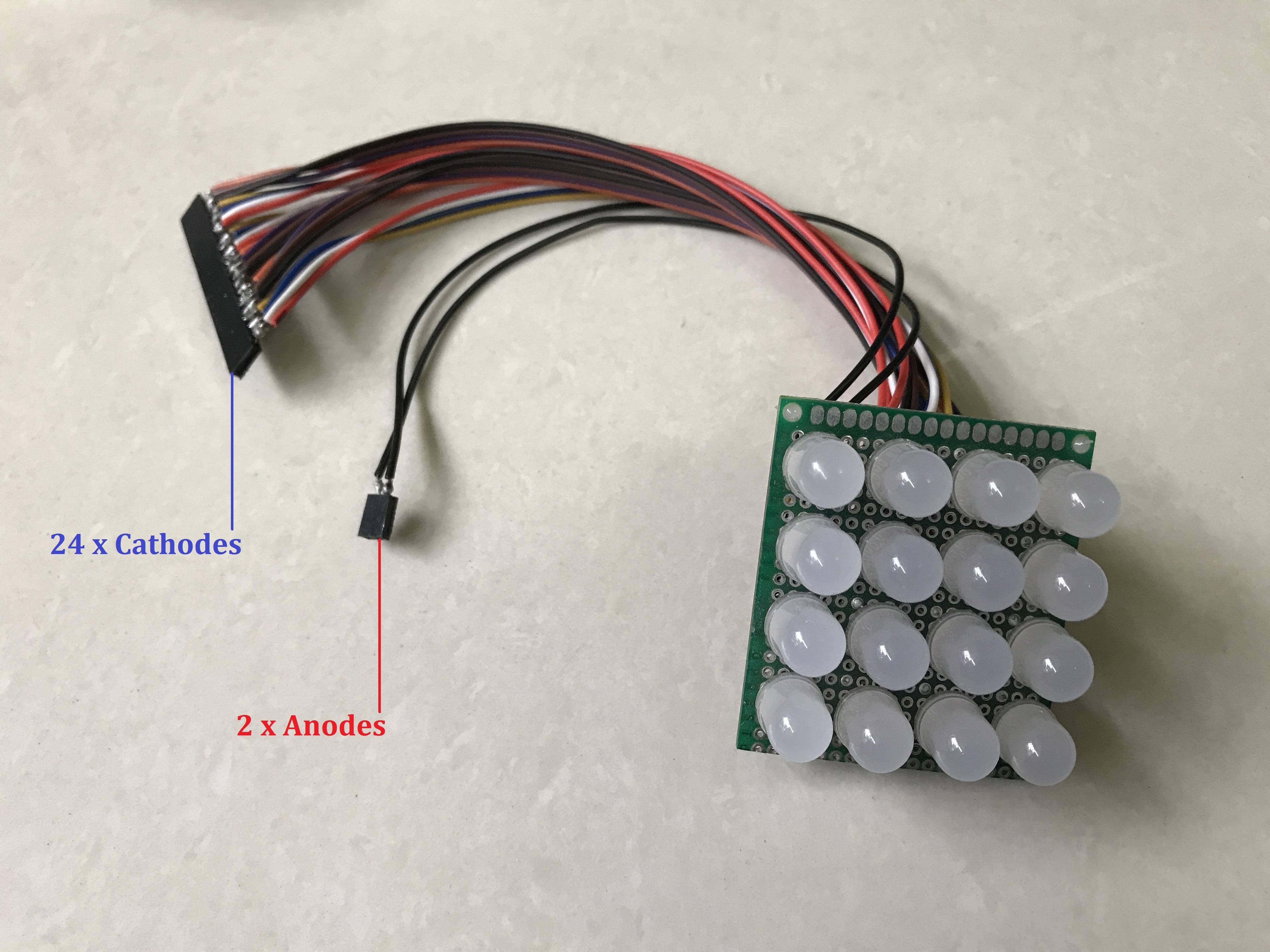

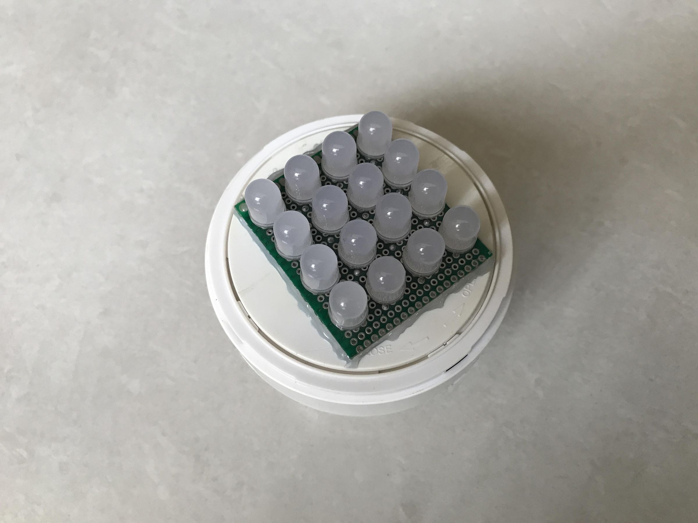

RGB led matrix 4x4 was soldered on a protoboard 5x7 cm.

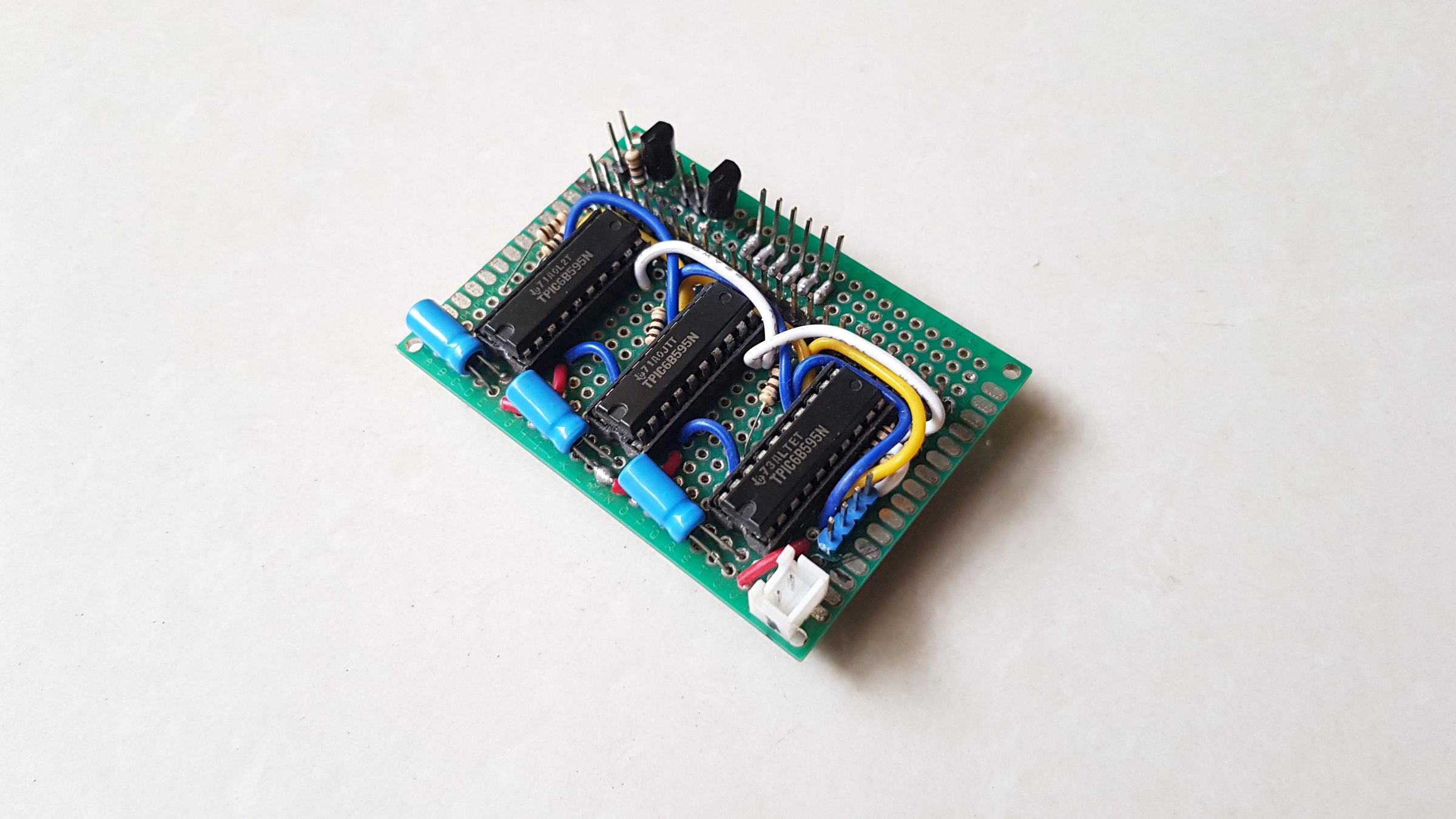

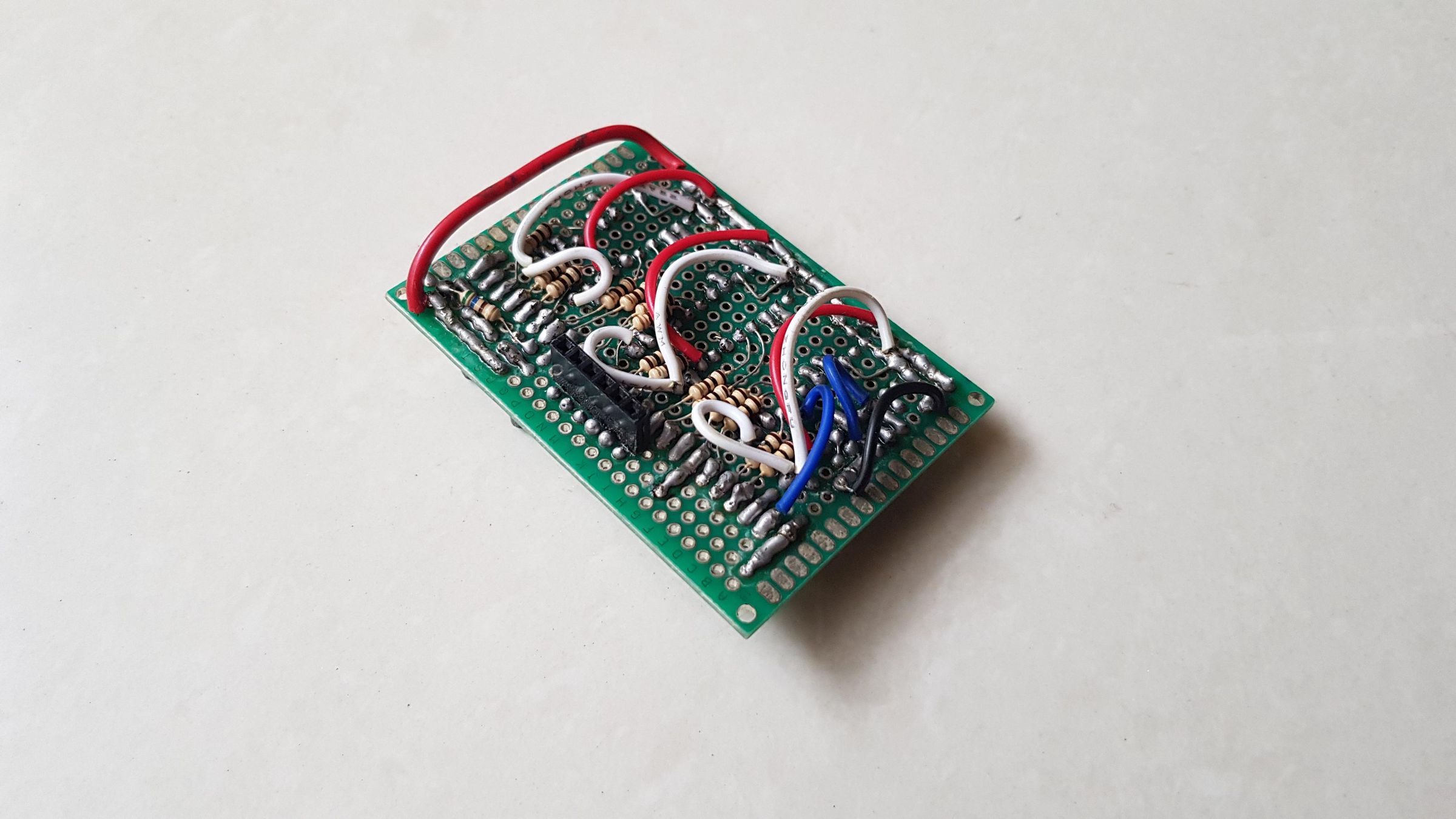

Soldering control component on the remaining PCB 5x7 cm following the schematic on Step 2.
⦾ Top view.
⦾ Bottom view.

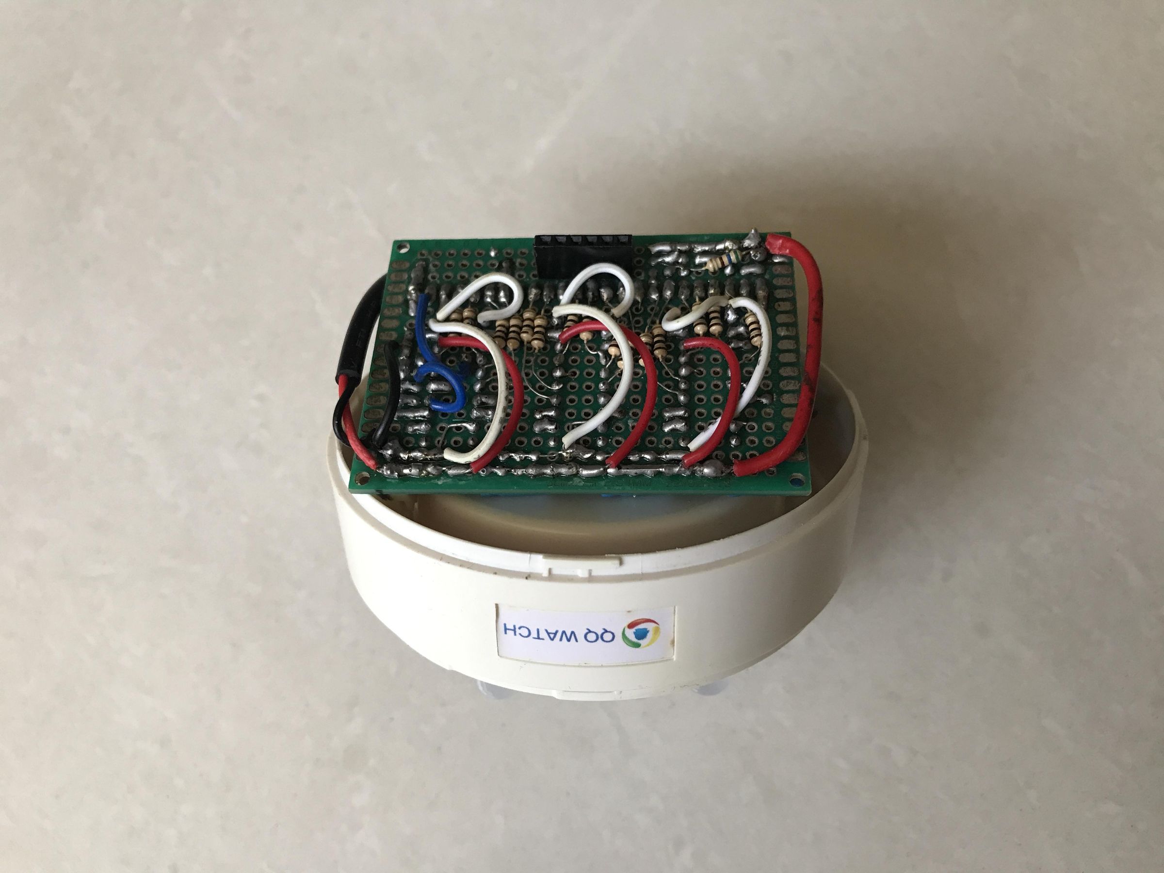

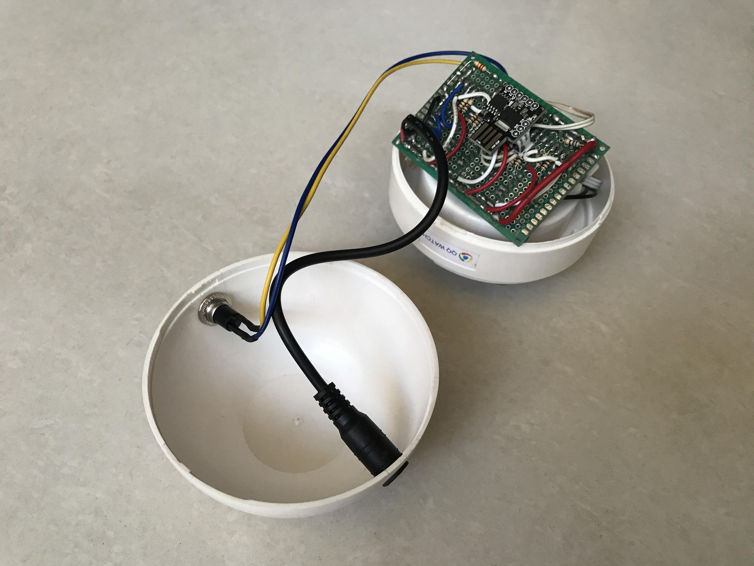

Remove the watch holder and glue the led matrix 4x4 to the middle part's top.
Thread all wires from the led matrix down to the control board which is located at the middle part's bottom.
Plug ATTiny85 on its header.

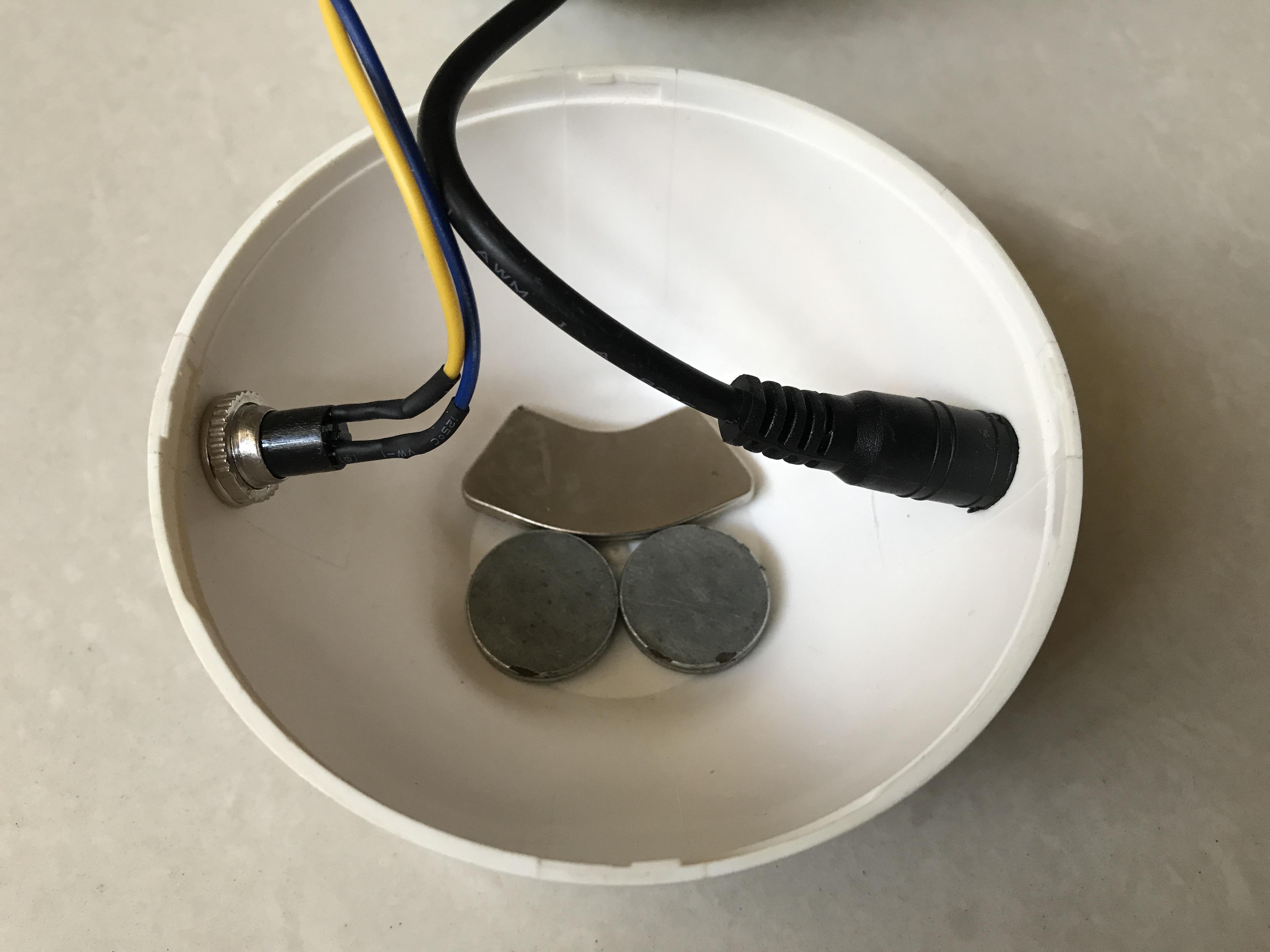

Drill and install one push button and female power plug at bottom part.
Glue some Neodymium magnets.
Assemble all the parts together. DONE.

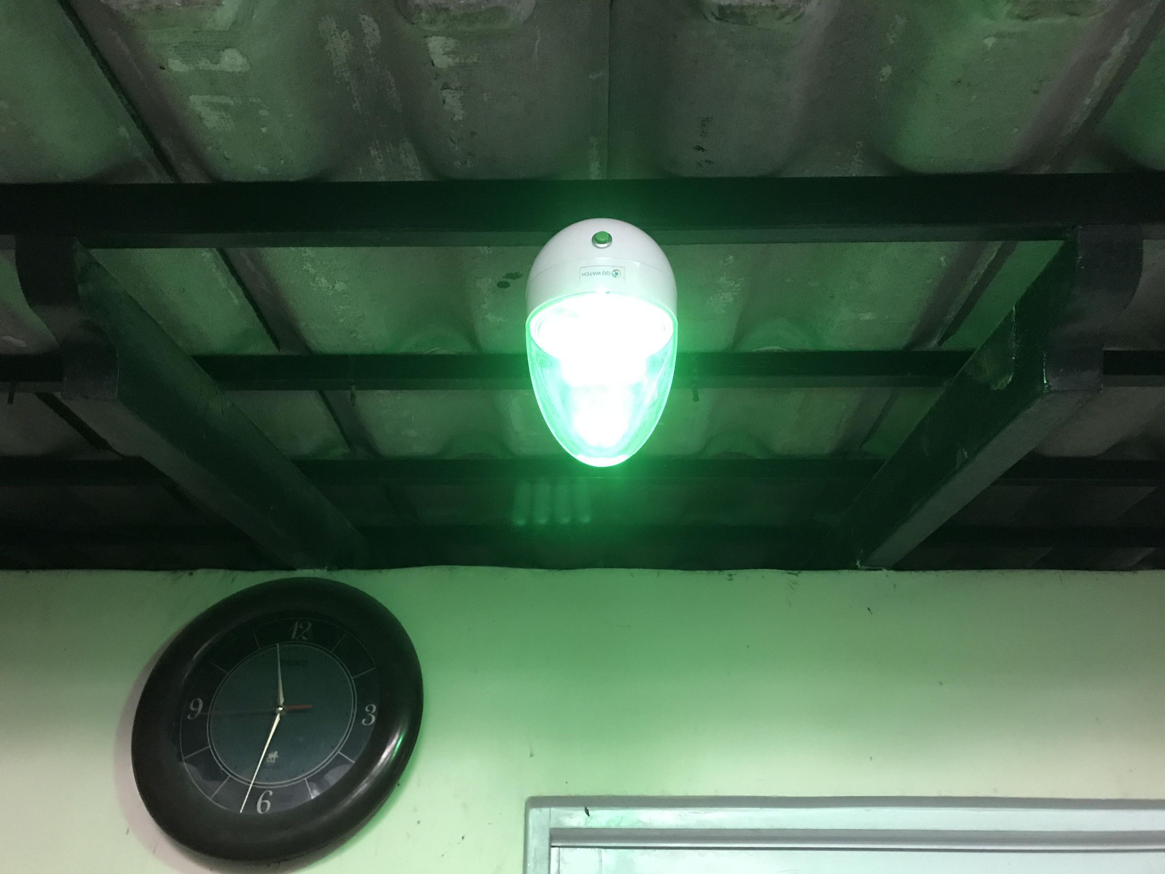

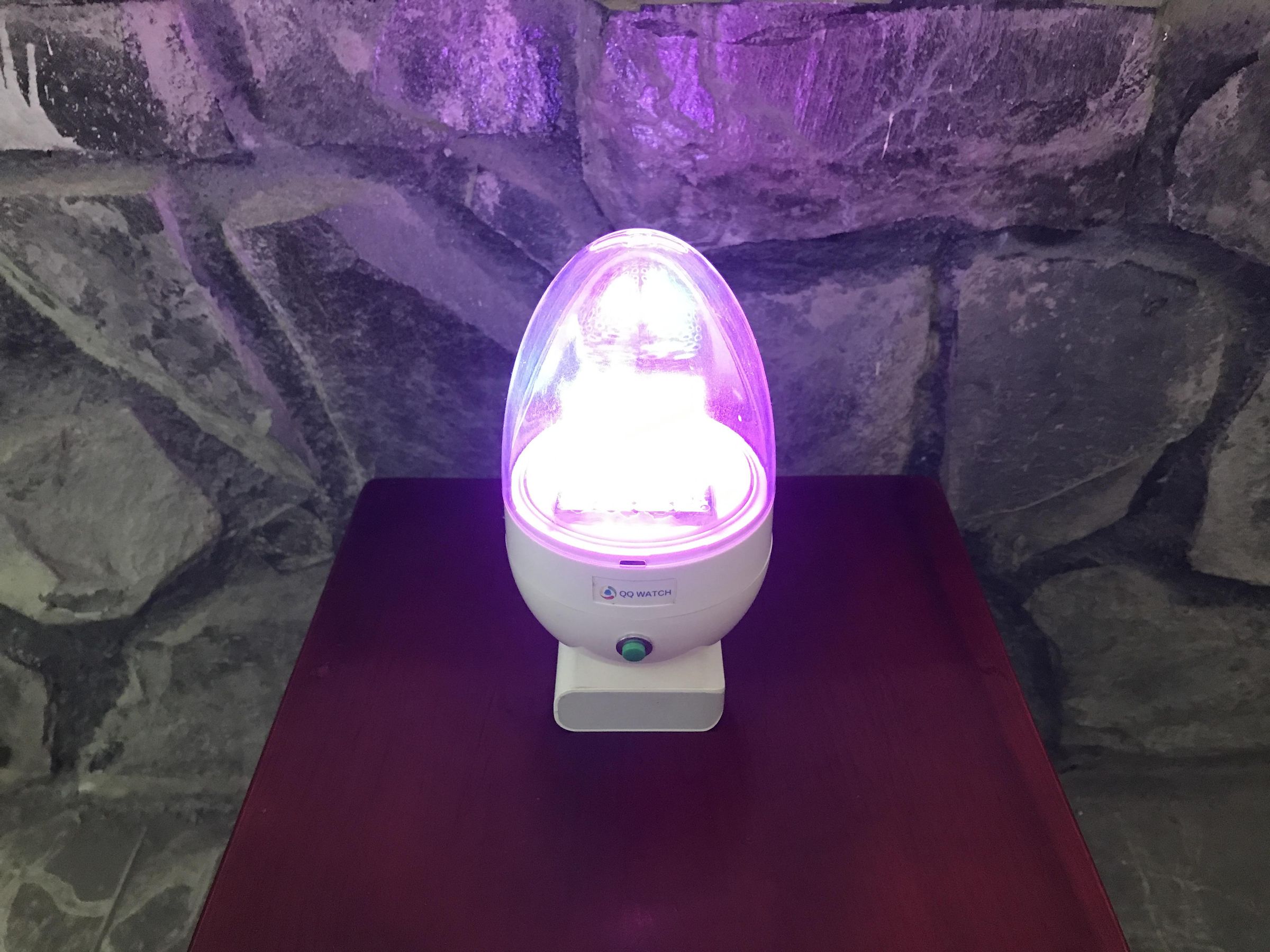

Step 5: Flexible Mounting

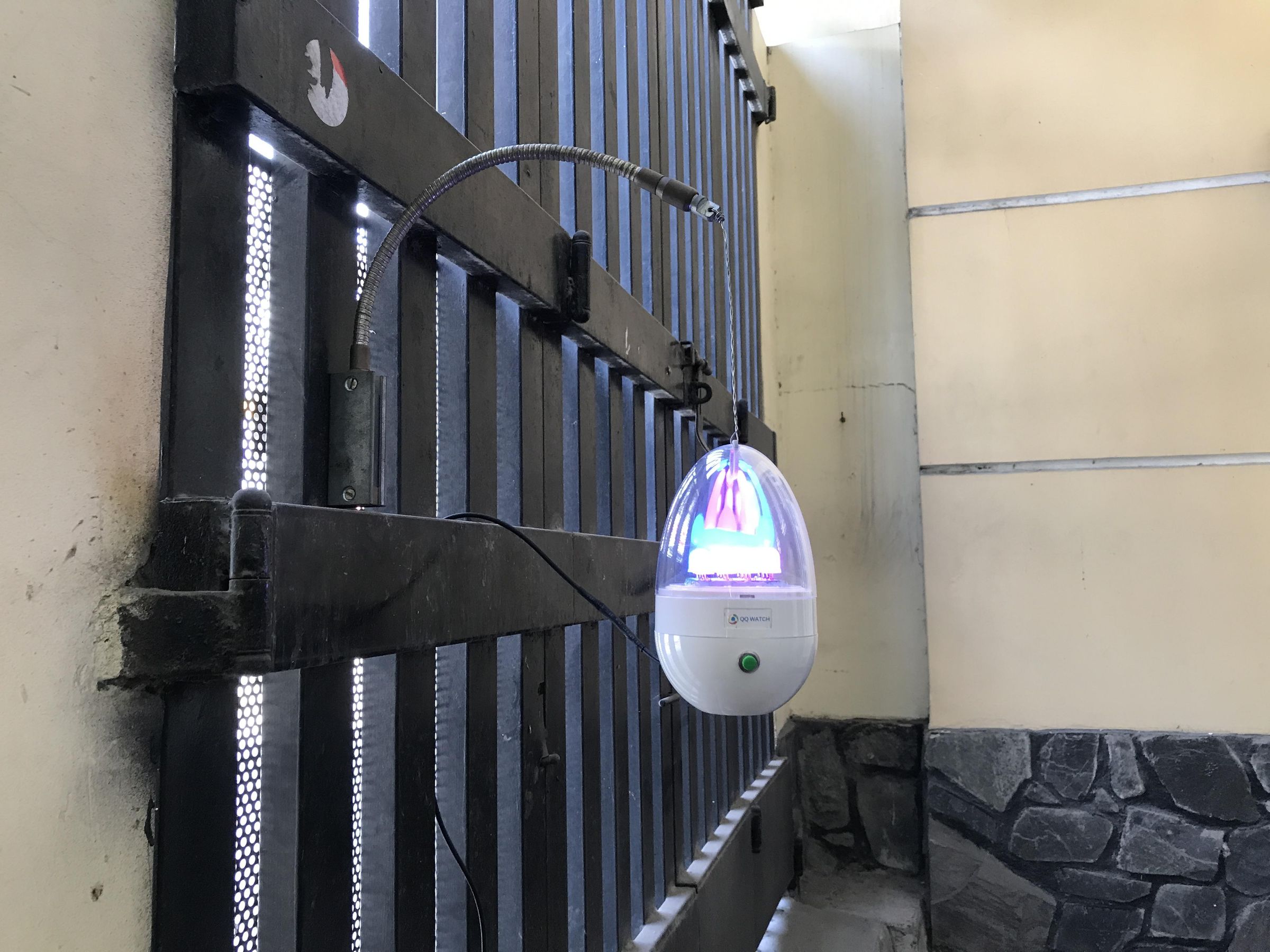

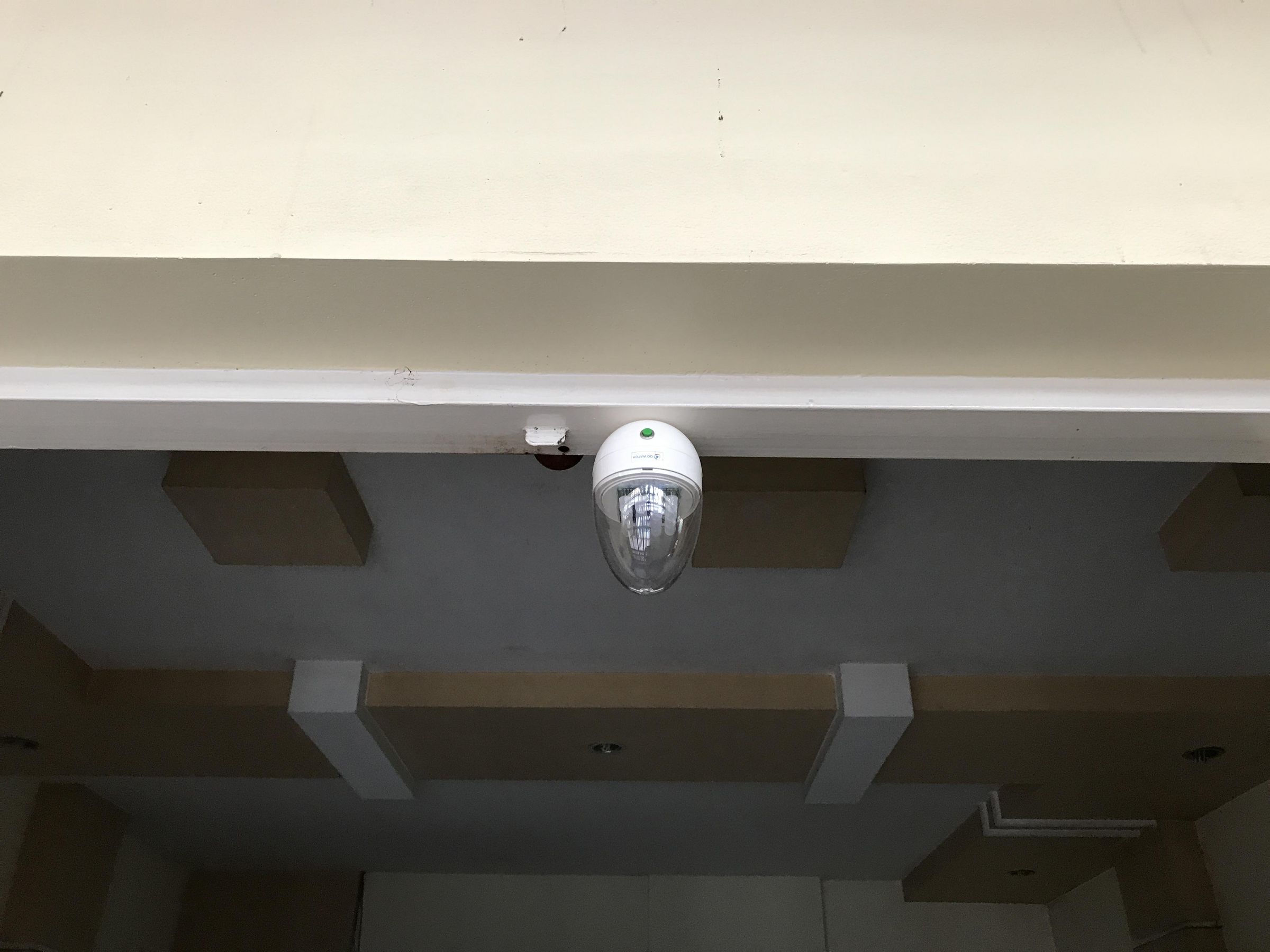

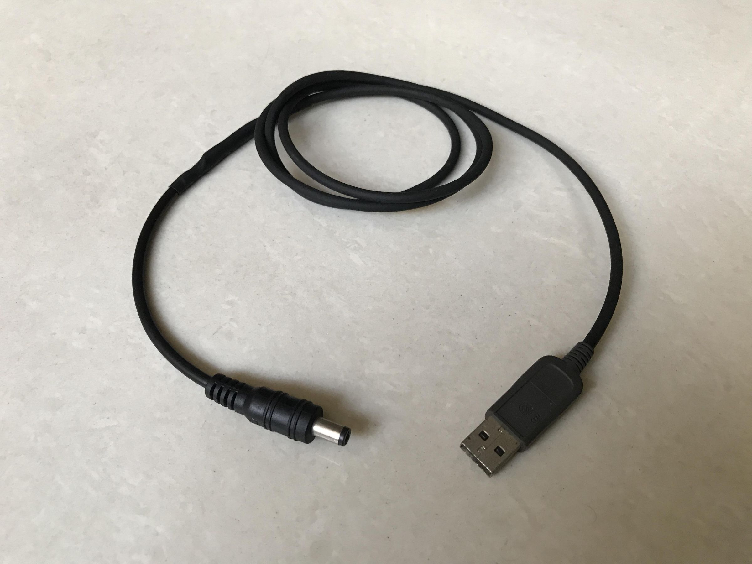

I soldered a USB to male DC plug cable converter so it can be powered from a power bank or laptop.

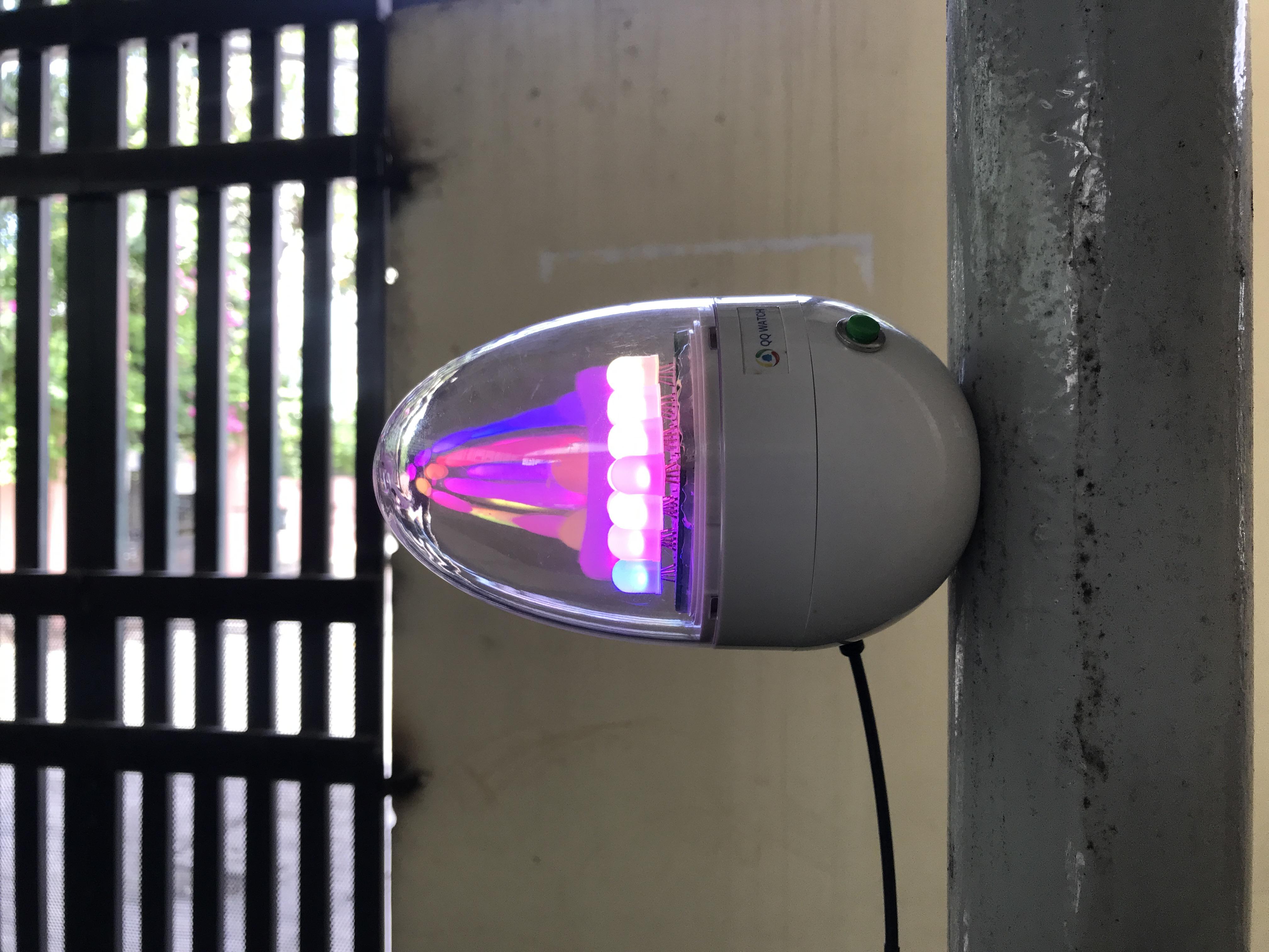

It can be placed in many different poses, such as:
⦾ Placed on a table.
⦾ Mounted horizontally.
⦾ Upside down.
⦾ Or upright hanging.
⦾ It can also turn into a fake dome camera. :-)
