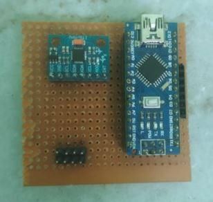

For trial and testing purposes, you can make the flight controller on the breadboard with the help of jumper wires but once you are done with testing, I will suggest you make a PCB of this as it is very important for the drone and any loose wire may lead to problems.

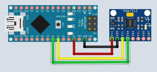

  • First of all, we need to connect our MPU6050 Sensor to our Arduino Nano. These should be connected as given below:-
    • VCC pin of MPU6050 to 5V pin of the Arduino Nano.
    • GND pin of MPU6050 to GND pin of the Arduino Nano.
    • SCL pin of MPU6050 to A5 pin of the Arduino Nano.
    • SDA pin of MPU6050 to A4 pin of the Arduino Nano and with this we will be done on the Hardware end.

And with this step, we are done with the building of the Flight Controller for our Drone. Now in the next step, we will be going to test our flight Controller. Keep in mind that the pins for the Arduino Nano to which the motors will be connected are all defined in the code and the connections will be done accordingly in the assembly part of the quadcopter.

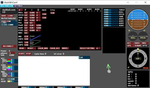

In the previous step, we completed the building of our Arduino-based flight Controller. Now in this step, we are going to test and calibrate the flight controller that we have made. For this, now we need to go back to the folder we extracted. In that folder, we need to open the folder named "MultiwiiConf". It is the folder in which our Multiwii Java GUI app is present. There are folders according to the different configurations of the PC. Open the folder that corresponds to the configuration and OS of your PC. In my case, I need to open the folder for windows 64 bit. In the folder, you will see an application named MultiwiiConf. This will open up the multiwii application. Keep in mind that for this whole process, we need to keep our Arduino Nano connected to the PC. When the application is opened you have to select the correct COM port and hit the start button. After clicking start, you will see that the graphs will start fluctuating and the values for several quantities will also change. Now you need to place the Flight Controller on flat surface and then click the CALIB_ACC button and hold the flight controller stable for 10-15 seconds. This will calibrate the flight controller and now you can see that as you move the flight controller in the air in different directions you will see that the drone showed in the bottom right will move and you will also see fluctuations in the Graphs and different quantities present there.
