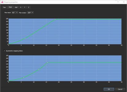

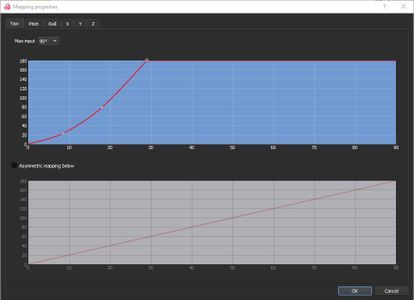

As far as software goes, I use OpenTrack (GitHub), which is decently user-friendly and seems to “just work” (at least with DCS), while still being pretty capable. There’s lots of great things to explore in OpenTrack and you should spend some time with it, but there are three things to be aware of right off the bat:
  1. The Point Extraction settings are easily what I adjust the most. Play with these settings to figure out how they work, then tune it for your particular setup. Having the lights on in the room makes a difference.
  2. LED geometry is important. Weird things happen if this isn’t correct. Fortunately, we can measure accurately in Fusion 360 and also in real life! My settings are shown below.
  3. You will very probably want curves in one or more axis. Play with it, you can do almost anything.
See the pictures for my settings; they probably won't be perfect for you, but should provide a good enough starting point.
