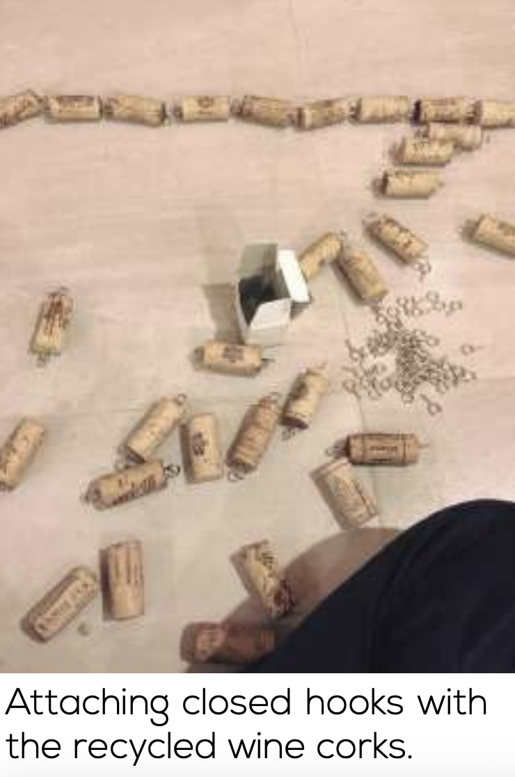

- Screw in 2 closed-loop screw hooks per cork for all the 112 corks. Screw one on the top, and one on the bottom of the cylinder.

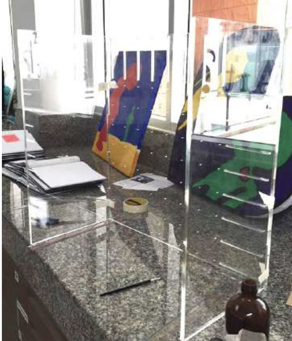

- Design a clear acrylic top piece with holes enough to fit the nylon thread through. For 112 corks (8x8), try a 9×9 grid with 81 total suspension points (some corks are supported top and bottom).

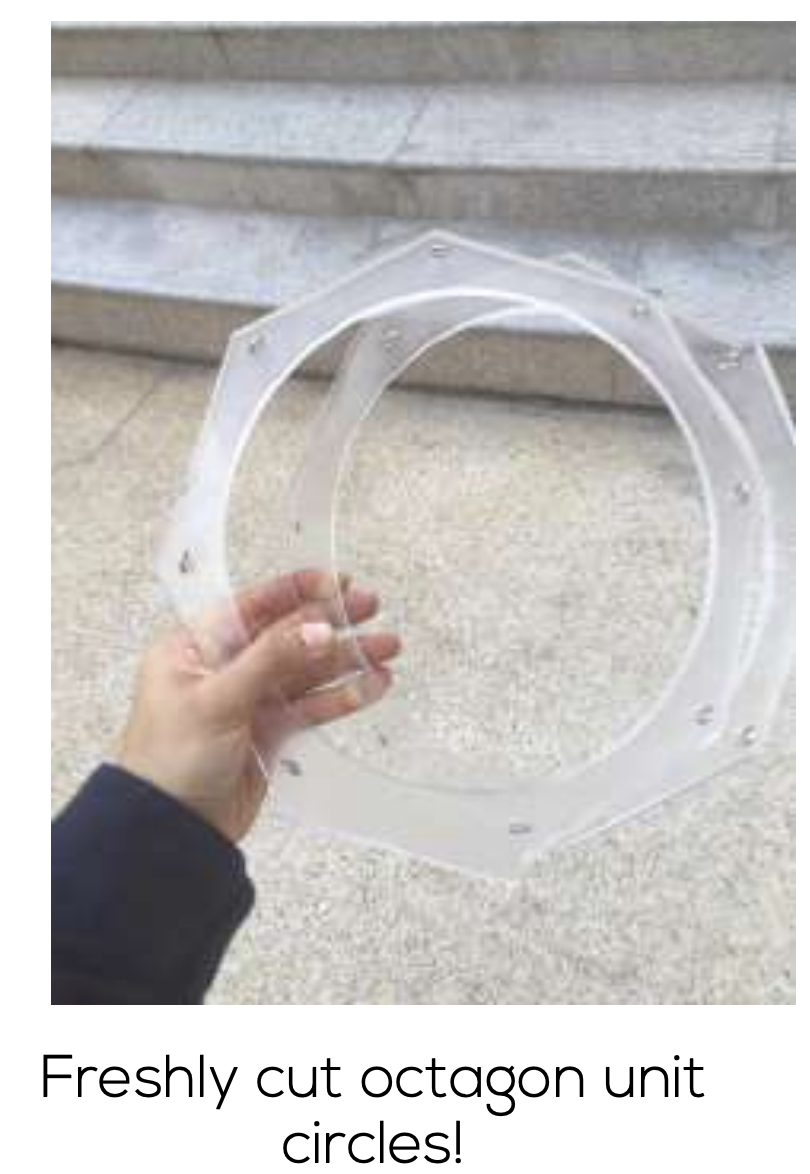

- Design two side pieces to hold the top piece up and a center and also the an (octagon) unit circle - the diameter of the circle depends on the amplitude you would like to waves to have.
- Space holes ~5-6 cm apart depending on cork + hook width.

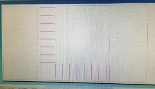

- Cut the panels using a laser cutter.
- Assemble using methylene chloride for clean, bonded edges. My frame was about 60 cm × 60 cm × 30 cm deep.
