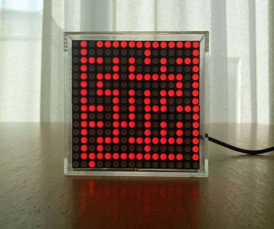

I found a cute touch light at 100 yen shop tried to remodel the accessories :-)
I decided to make the accessories to represent the flip animation in touch light .
It is good to decorate the chest . In addition , it may be held in the hand .

Step 4: Assembly.
Put a notch in the switch size to the exterior of the touch light.
Ready and packing .

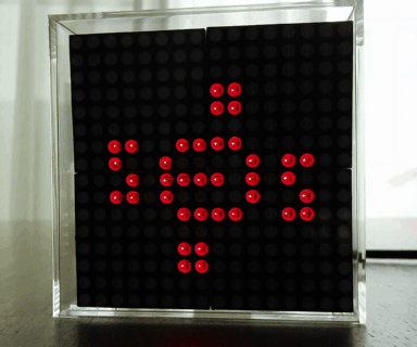

Step 5: 8 Types of Animation.
Animation will change and press the attachment button .
