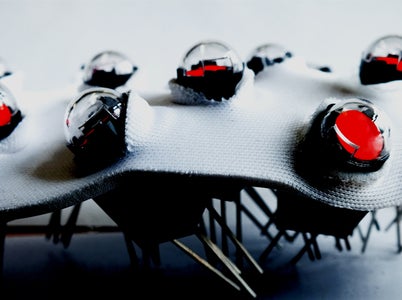

The flip dot dress is a kinetic garment that responds to sound. It is made up out of tiny flip dots, which are electro-magnetic discs that can flip from one side to the other. The design incorporates 600 flip dots in total, which flip from black to red and can be consider a 600 pixel display on the body.

I soon found out that because of the height of the dots (about 2cm) it would be nicer to embed them in a relatively heavy thick material, so that the fabric surrounding the dots wouldn't create a pulling effect.

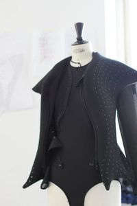

I decide to make a body with a kind of black vest zipped on top of it, whereby the dots would be visible from all around.

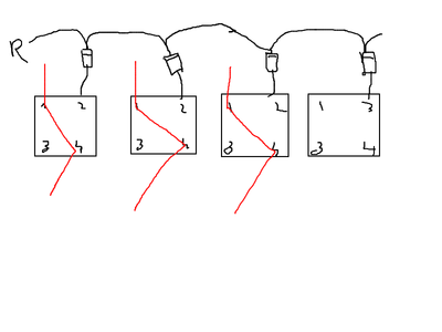

Then it started to become a little more complex. In order to address each dot individually, I had to connect all the dots in a matrix of 30x40. Having the dots placed in a specific lay out that fit my design, made it quite a puzzle to come up with the most efficient wiring diagram.

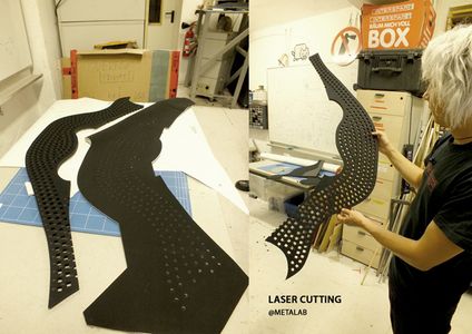

We laser cut the square shapes out of the foam as well as small holes for the circular shaped 'heads' of the flip dots out of the neoprene outer layer of the design.
LARGE SCALE LASER CUTTING WITH A SMALL MACHINE
Working with the scale of the body often results in working with quite large pattern pieces. Since our panels were much bigger than the surface the laser could cut at once, we cut the material in various steps. After cutting one part we had to move the fabric around to cut the next. But of course both cutting sessions need to be aligned according to your file…
The TRICK is to engrave a simple cross outside of the outline of your laser cut pattern, so basically in any left over piece of fabric that the laser can reach. When replacing the fabric to cut the next part of the file, you align the engraved cross again with the head of the laser. You let the laser engrave the same cross again but instead of actually engraving, you leave the cover/hood of the laser open, so that you can see the red pointer moving over the cross, but not actually lasering. Since the cross has two axes it creates quite a precise alignment. (Check with your type of laser cutting if opening the hood makes it cut 'fake' and just move over the pattern without actively lasering. If not, this can be very dangerous!)

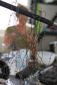

We used these diodes which quite efficiently were soldered into garlands which then could be easily connected with the flip dots.
Step 6: Organized Chaos
Soon the design starts looking like a mess, but make sure to keep the chaos an organized one! Use a lot of heat shrink to make sure there will be no short circuits. All the leads of the flip dots which are soldered to the wires can be bend flat afterwards.

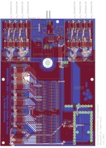

Daniel designed and developed a cool custom made PCB that would drive the flip dots.
The small PCB board of 86 x115mm is integrated in back of the dress, in between the shoulder blades. It has 70 power outputs, a wireless module (XBEE), an SD card slot, and is able to deliver up to 5A.
We hooked up the flip dot matrix to the board, for the 16 and 20 pin connectors we used ribbon wire.
