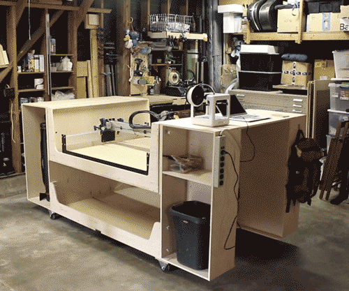

Space is expensive, space saving is not. With this table in my garage, I have a 30 square foot work table and on the under side, a 33" X 33" Shapoko XXL CNC machine when I need it.
The CNC machine is screwed to the underside of the table top, which is attached to two side shelves with shafts and bearings. Four set screws keep the table rigid when it's in either position.

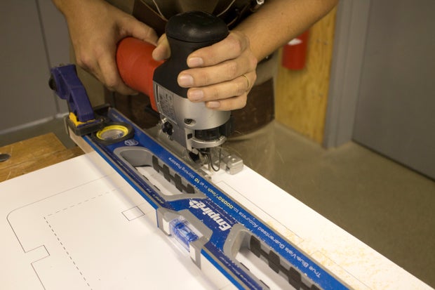

Digital Fabrication by Hand
If you don't have a CNC router, all you need is a hand drill, a jigsaw with a metal cutting blade, a large format print from a print shop, and some patience. Here's a link to my Digital Fabrication by Hand instructable, showing you how to be your own CNC machine: https://www.instructables.com/id/Digital-Fabrication-By-Hand/
I'll provide PDF drawings in the next step that you can use as templates to cut out your own parts by hand with a jigsaw.

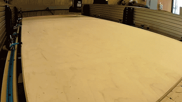

Step 4: Cutting Panels
I used the 4X8 Shopbot I'm lucky enough to have access to at our shop in Pier 9. The panels are larger than the cutting area of the Shapeoko CNC (obviously) so I wasn't able to use it for this project.
There are total of six 48X96in X .5in panels that make up the shelf, and two 24X36in X .25in panels for the spacers on the sides. I laser cut the quarter inch panels.

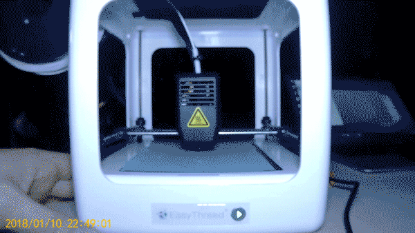

Step 5: 3D Printing
The thumb screws are made from 1/4-20 hex bolts and 3D printed handles to save money. I used the EasyThreeD printer I mentioned in the intro and the parts came out fine. Not the best quality printer I've ever used, but totally acceptable for simple prints like this. I think this would be a great printer for a beginner- the interface and controls are dead-simple, it's very quiet, and fits on a desktop. For reference, you could print something about the size of a coffee mug on this machine.

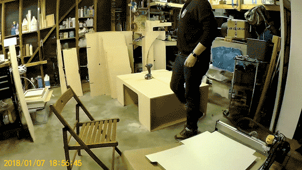

Step 6: Assembly Method
The assembly method is something I've used before on projects like this. The panels have a kind of large finger joint profile, and the face of each finger joint has a 1/8" pilot hole drilled in it. I hold the parts together and use a hand drill to trill a pilot hole into the panel that's perpendicular to the hole. That way I know the hole is straight (having used the pilot hole made by the CNC), and I can prevent the plywood from splitting due to the pressure made by the screw.
With the pilot hole drilled, I use countersunk square drive screws because they sit flush with the panels and are very hard to strip (and they look cooler than philips head screws).

Step 11: Finished Product / Lessons Learned
Overall I'm very happy with the table, but given the weight and the small amount of shear material stabilizing it in the long dimension, it wobbled more than I was comfortable with. I made some small quick-release chalks for the overhanging edges of the shelves that keep it very steady.
A good way to build it might be to have eight casters- four where you see them in the pictures, and another four at the outside corners. Also, there's no point in using any fixed casters at all- swivel casters all around would do (I just used what I had lying around in the shop.
