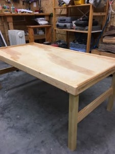

Step 11: Finished Product
This table should bring years of fun and activity to my 2 year old grandson.
Step 12: Addendum to Original
I had enough material, minus the legs, to make another table. I purchased (2) 36 INCH 2"X2" and cut them into four 18" legs and glued them to bottom of table and nailing them with nail gun. Then I braced the ends with some scrap wood I had using my KREG jig. This table seems very sturdy. I plan to clear coat it with spray polyurethane. This table will stay at my residence for my 2 year old grandson, while the blue table went to his house.
