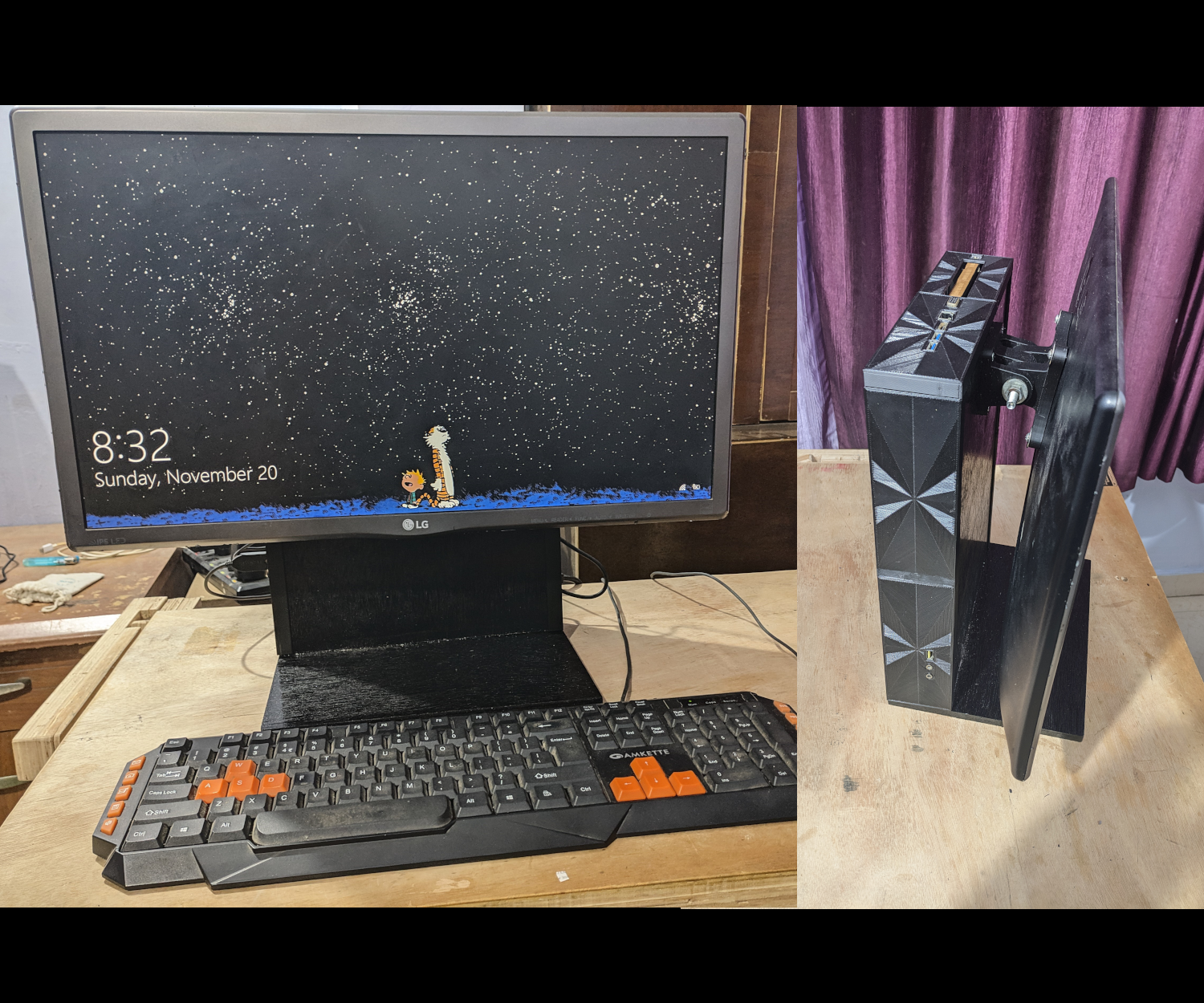

If you have a small work space like me then flip-top tables are amazing, you can have different tools attached on different sides or have one side clear for any other use. I came across Jeremy Fielding's video (https://www.youtube.com/watch?v=OQaFaHDDHqw) and loved the design.
This is my version of the table using only a single sheet of plywood.
The pieces can be joined in 2 different ways; one with a flat base if someone wanted to add wheels for it to be movable and other with a shelf. I'm making the shelf version for my use.
