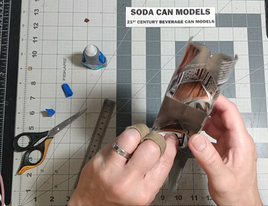

Step 1: Cut Out Main Hull
Use the templates provided to cut out the main hull as shown.
Step 2: Fold the Hull
Next, Fold the newly cut out hull piece in half as shown in the photo
Step 3: Install Hull Formers
Trace and cut out the middeck and rear hull formers. Install them inside of the main hull piece as shown
Step 4: Stern Former
Use the templates provided to trace and cut out the stern former. Install it on the rear of the hull piece as indicated
Step 5: Mid Deck Former
Trace and cut out the mid deck former. Glue the mid deck former into the center of the hull piece as shown.
Step 6: Prow Former
Use the templates provided to trace and cut out the prow former. Install the prow former on the front of the hull as shown
Step 7: Rear Deck Former
Trace and cut out out the rear deck former piece. Install the rear deck former on the hull near the stern former as indicated
Step 8: Main Deck
Use the templates provided to trace and cut out the front and rear main deck pieces. Glue them into position on the main hull as shown
Step 9: Prow
Trace and cut out the prow former then install it on the front of the main hull as indicated
Step 10: Display Stand
Use the templates provided to cut out and make the hull base. Also cut out two hull supports and glue them to either end of the base as shown.
Step 11: Rear Deck & Forecastle
Use the templates provided to trace and cut out the forecastle & rear deck pieces. Glue the forecastle and rear deck pieces into position on the main hull as indicated
Step 12: Rudder
Use the templates provided to cut out a left and right rudder piece and glue them together. Install the completed rudder on the rear of the stern as shown
Step 13: Captain's Balcony
Craft the Captain's balcony out of the templates provided and glue it into position on the rear of the hull as indicated
Step 14: Making the Masts
You will need a package of bamboo skewers and wooden dowels to complete this step. Use the templates provided to cut the main mast, foremast, bowsprit and Mizzen mast pieces to size and install them along with the crows nest as shown in the photos
Step 15: Sails and Rigging
Install the bowsprit sail, the foremast and main mast sails. Glue the Lateen sail into position. Then add the rigging pieces as shown to finish off you Spanish Galleon soda can model.
