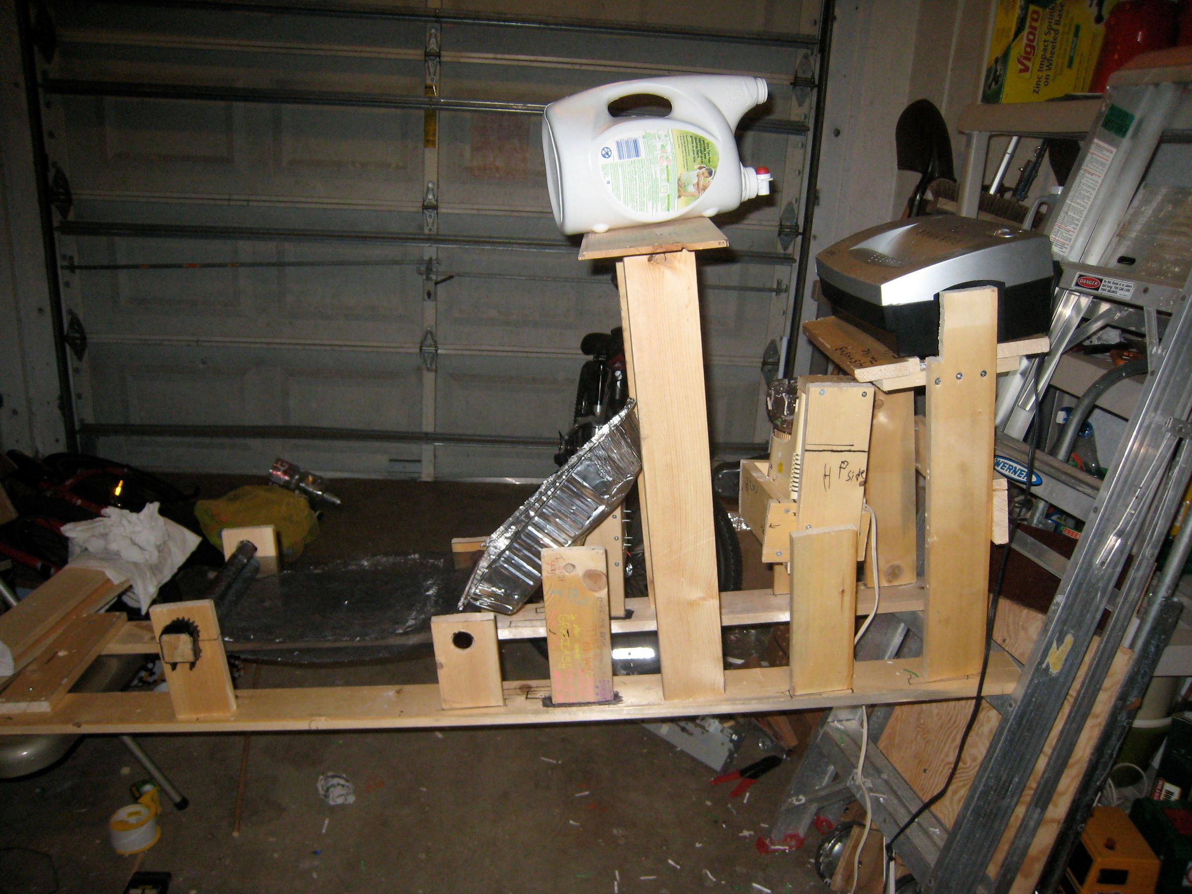

Next, going to the back of the frame, we have the guide wheel and the guide blocks. These keep the arm straight as it is being loaded and dropped. Otherwise, the arm would derail a lot more.
A note about the guide blocks:
Make them small as possible, but make sure they can still guide the arm until its wheels hit the track. Otherwise, The arm will get puched over and on top of them, slowing down the arm a lot. If you see or hear bumping, look carefully at this back area w/ a video camera or just your eyes to see why it's doing that.
Remember, smooth transitions.
Everything moving should always be on a wheel, and only touching a wheel.
If you need more help with the guide blocks let me know. I had no idea what the problem was at first.
The third clip in the video shows this problem well- the arm kind of rolled over and on top of the guide blocks because they were too high. The arm slowed down a lot, and the ball spit out the back.
Drill a hole horizontally and squarely directly through the track. Keep the hole in between the main track supports and the diagonal track supports.
...That should be about 2 inches from the end of the track. Again, not critical.
The guide blocks can be any shape you want, but look at the picture notes below for shaping. Avoid contact with the arm as much as possible, they are only there to guide.
Cut them low but long out backwards.
Drill the hole accordingly, so that their position is similar to the one pictured below.
Slide the bolt through one hole, screw everything on in this order:
nut, washer, guide block, wheel and bearings (Go together) , guide block, washer, nut.
slide the bolt the rest of the way through the other hole. Center the wheel in the middle of the guide blocks and the wheel with the guide blocks in the middle of the tracks.
Everything should be centered. Finally, put a nut and washer on the outside bits of the bolt that protrude from the tracks.
By tightening these outside bolts, you can change the alignment of the tracks and narrow or widen the distance between the drop channels.

Once everything is square, true, straight aligned or whatever you feel like saying, We can put this beast together.
Step 13: Put Everything Together
After looking at the dozens of picture I took, It should be pretty easy to figure out how to put everything together.
All you are really doing is putting the arm in the drop channels.
First, obviously, just lay the arm in between the drop channels (Just the middle of the treb)
Line up the holes in the arm with the drop gap.
Use a wrench or hopefully a driver of some sort to drive the CW bolt all the way throughone drop channel, through the arm and out the other drop channel. Center the bolt in the arm, with the same length of bolt coming out from either side. Next center the arm itself in the middle of the drop channels, so there is the same amount of space between the arm and the drop channels on either side.
Bolt on the CW boxes. You may want to keep the weights out while you are doing this.
Use the order of bolts and washers on either side shown in the first picture (From inside to outside the order is) : drop channel, washer, bolt, washer, CW box wall, Washer, bolt, Bolt, washer, wall of CW box, washer, bolt.
Just make sure there is a washer on any side of a bolt that will be touching wood.
Place the weights in the box and screw on the top. If the weights are extremely heavy, though, you may want to keep the weights out of the box for now, since when you load it you will have to lift it.
The sling and pouch should already be tied together and to the arm...
If not look at step 10.
Finally, thread the Axle through the other hole in the middle of the arm. Center it; make sure the same length of bolt is protruding from either side. Then bolt on the wheels. (Order from inside to outside.) Short arm, washer, bolt, washer, wheels and bearings, washer, bolt.
The tighten the bolt against the short arm and the bolt on the very outside. Keep everything tight.
Make sure the axle bolt is short enough to clear the frame easily.
