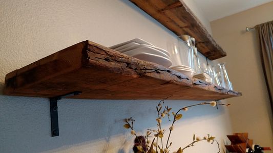

Step 4: Both Shelves After Linseed Oil and Polyurethane
These are the products that brought the beauty out of this old wood. Mostly the linseed oil though.
Step 5: The Finished Product
I was thinking about doing some kind of pun regarding the "Finnish-ed Product" here, but it's a stretch because my wife's grandfathers' oars that are displayed here actually have the Swedish crown depicted on them. Enjoy!
