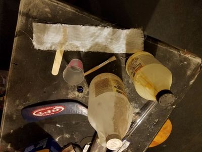

Step 3: Step 3 - Assemble the Tail Switch
This step, of all steps, I imagine the most people will want to do differently than I did. I happen to have a lot of composite materials just laying about, so this made sense for me to do, but I can think of other, easier ways to make a switch. Having said that;
Flashlights are wired such that the body of the flashlight is battery negative, and the button switch in the tail cap of the flashlight just connects the body of the flashlight to the actual battery. This simplifies wiring, as you then just need to connect the lamp to the body and to battery positive.
The easiest way I could think of to get a threaded flashlight tail cap, complete with switch, to work with my saber, was just to stick the back half of a flashlight on the end of the tube. I accomplished this by cutting the flashlight body in half, and then wrapping epoxy/fiberglass composite around that to make it all one piece. Detailed instructions below:
- Cut Flashlight in half (Photo 1)
- Mock flashlight up with handle tube using some internal brace (I used a slightly smaller tube to hold it nicely)
- Assemble your composite materials and mix up your resin.
- Carefully wrap your fiberglass cloth, wetting out with epoxy as you go.
- [Optional] Using teflon tape, apply an over-wrap to the still-wet epoxy composite. This will squeeze out excess resin, and give you a nice tight layup.
- Sand off the teflon tape.
