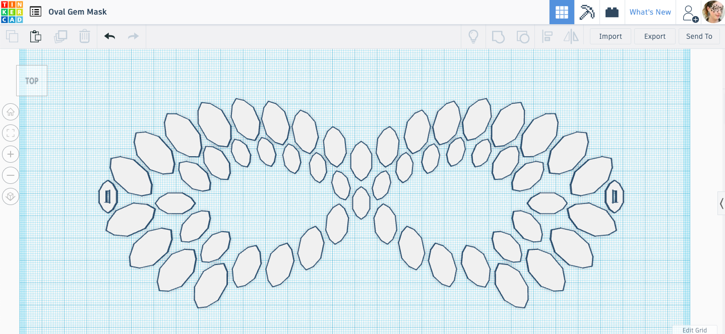

Step 1: Mask & Base Design
I designed my mask using Tinkercad.
First, you need a mask design. The step by step below will show the new gem mask I designed but here is also a look at what I did with the stars and moon.
Once you have the mask design, you need to create a flexible base. The Base will be made up of the base of the design itself (the gems) plus lines to connect everything together. You need it to hold up when it is pulled and tied on your head. I found if you didn't have lines connecting it properly, it would pull the mask out of proportion. A main thing to keep in mind is you need support straight across the mask as much as you can.
So, to start, you need the base of all the gems.
Then you need the lines to connect the gems. I already imported some mask shapes to work with and shrank or enlarged them as need be.
Lastly, I connected bits that needed some more support. You want to support going up and down the middle (green), and going from left to right (red) since it will be pulled tight by the ribbon. Then, just add in any little bits if you feel the mask is hanging too much (blue). I had to go through a few prints to get all these little bits right, so you might not get it 100% right the first time.
Some might be wondering, why don't you just do a solid base below the gems. I did this for two reasons, 1: I wanted to try to not make it as invisible as possible and 2: I wanted it to be able to breathe as much as possible, if it covers completely it will get way too hot.
Make the base .2mm high so it will be just 1 layer when printed and make sure the rest of the mask starts .2mm up from the bed. I needed to do this for the multimedia extruder I had, but if you don't have this, just make sure the base is .2mm thick and then the rest of the mask goes up from there. Then you can just group the whole design together.
