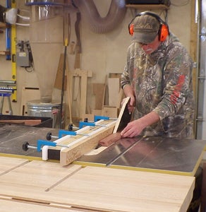

Step 4: Cutting the Rabbet
The only thing that should be seen from the side of the frame, is the "show" lumber selected. To accomplish this, there's a shallow rabbet cut inside each edge of the frame material. This Rabbet needs to be cut to accept the material chosen as the backer material.
The rabbet is cut using a 3/4" dado stack in the table saw and a sacrificial fence because my material was slightly shy of 3/4" and the blade needed to be slightly buried in the fence.

Step 6: The Miters
Cut miters on each piece ensuring that they are 1" longer than the artwork on the inside of the miter. This will allow for 1/2" gap between the artwork and the frame. The measurements for these cuts will depend on the artwork you intend to frame.
Cutting the miters can be the frustrating portion of any picture frame build. A miter gauge at the table saw, miter saw, or even hand cutting the miters will work. I've created a sled for the table saw that I find works really well for these cuts. This video and Instructable documents the sled build.

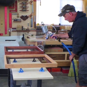

Step 9: The Finish
I started the finish using General Finishes Arm-R-Seal, a wipe on polyurethane. I then followed that up with a few coats of General Finishes High Performance. I block sanded with 400 grit sandpaper between coats.
The sprayed finish is a film finish so add coats until the desired look is achieved.
