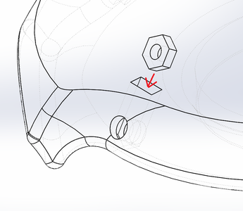

Step 1: CAD Design
Design Criteria
This project has evolved over time but there has been one constant throughout. I will be using my favorite little toy: the 3d printer. Without a 3d printer a "prototype" build like this would be impossible. There was tons of trial and error along the way. And not to mention, most of the geometries I designed would be tough to fabricate if not impossible with classic diy techniques.
I tried to design with other potential building techniques in mind. I am interested in trying to "tumble mold" the shell or even just injection molding. With this in mind, I tried to design with uniform wall thickness and zero negative draft.
I kept modifying the CAD design until it could be 3d printed in vase mode. This greatly reduced the print time, cost, and weight of the shell (and as a bonus vase mode looks fantastic).
A couple of lessons I learned along the way are:
  • Do everything you can in your design to keep the nozzle continuously flowing. For example, the completed part needs a few holes and has a decorative wavy top layer. If these features were modeled the 3d printer nozzle would have to stop its flow, move, and begin flowing again. This results in weak spots and strings. Instead I found it better to model “witness indents” where holes will go and cut them out of the completed 3d print later.
  • Large diameter vase prints will have a tendency to warp. It is beneficial to include ribs or undulation to add strength to the shape.

As I mentioned earlier I was able to set up almost every print to be done in vase mode. With the only exceptions being the tweeter mount btm and top.
Connecting the parts
The main body shell btm and top will be glued together with a sealant. Creating 1 large sealed cavity for the woofer and electronics.
Button head cap screws will be used to mount the arms to the main body and tweeter mount. The tweeter mount btm has pockets sized to fit a hex nut. Simply slide the hex nut into the pocket and it is ready to receive the mounting bolts.
Screw posts are used in the main body to receive the mounting bolts. Glue the posts into location with a sealant.
