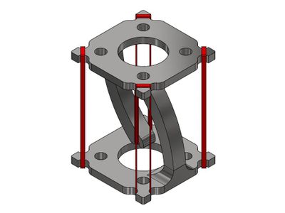

The table has two identical 3D-printed parts. You will also need 5 elastic bands. Rubber bands were used for this version. Each is ~ 7" long before stretching.
Step 1: CAD
The table was modeled in CAD. No support structure is needed for the print. I worked the overall sizing to existing rubber bands I had on hand.
Step 2: Center Band
Since I used the same size bands, the center band had to be doubled up. Assembly as shown.
Step 3: First Stability Band
While holding the parts as shown, add the first stability band.
Step 4: Second Stability Band
Add the second band to the opposite side.
Step 5: Last Bands
Add the remaining two bands
Step 6: Finished Assembly
You have now finished the table. As the video shows, it is stable and will bounce around when a force is applied to the top.
