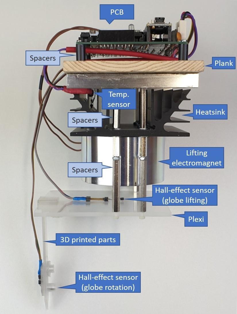

Step 3: Electromagnet Assembly
This assembly contains everything we need, except for the coils used for globe rotation and the led strips.
The electromagnet is quite powerful and produces a fair amount of heat. To keep everything safe, a quite large heatsink is placed on top of it. Additionally, a temperature sensor is fixed to the heatsink. It will be used to continuously control temperature.
Above the heatsink comes a wooden plank (used to 'hang' the assembly in the wooden lantern without the need for any nuts or bolts). Just underneath, notice an aluminum corner profile to keep the plank in position. Threaded spacers connect the plank with the base of the heatsink.
Underneath the heatsink, using the same holes (which you will have to drill, of course) we have another set of threaded spacers arriving at a plexiglass plate, holding the sensor we use for vertical position measuring (hall-effect sensor).
The plexiglass measures 90 x 105 mm. The back edge extends 67 mm from the hall-effect sensor (electromagnet center) position. Note that this last dimension is important as this is where the 3D assembly holding the globe rotation hall-effect sensor will be attached to the plexiglass. We'll discuss this later.
Also, you will have to cut the plexiglass plate and drill holes in it. Carefully measuring and making a few sketches first, will prove to be a big help !
Important: make sure that the spacers (and the bolts underneath the plexiglass) are not magnetic.

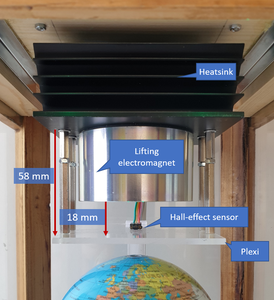

Step 4: Lifting Hall-effect Sensor
Several ways exist to accurately measure the distance between globe and electromagnet - more correctly, to measure the deviation between desired position ('set point') and actual position. A common method is to use a light source at one side of the globe and a light detector at the other side. But in our case, as said, we use a hall-effect sensor measuring the strength of a magnetic field (which depends on the globe position) and converting this to an electrical voltage.
Actually, this sensor will not control the position of the globe with reference to the electromagnet, but with reference to the sensor itself. But because this sensor is fixed in position, this will ultimately determine the setpoint: the position of the globe with reference to the electromagnet.
As said before, the vertical distance between electromagnet and sensor (or plexiglass plate) is critical.
With the electromagnet I used (height 40 mm), the plexiglass plate is 58 mm away from the heatsink (which can be obtained by stacking 15 mm and 40 mm threaded spacers, adding a nut in the middle). This gives a 'gap' of 18 mm between electromagnet and hall sensor.
A question you might ask: doesn't the magnetic field of the electromagnet influence the sensor reading ? Well, yes... but this is not a problem, because while we read out the sensor value (every millisecond), the electromagnet is always in the same ('ON') condition (you can verify this by looking at the scope screenshot, above). So, it's attribution is constant and can be discarded.
This hall-effect sensor needs to be placed exactly beneath the center point of the magnet. If not, you will introduce oscillations in the system and your globe will start to 'swing' in a horizontal direction, which is something the electromagnet cannot control. You will have to figure out how to determine that position. When doing it visually, take into account a thing called 'parallax'. Suggestion: once you have determined that spot, put a small dot on the bottom side of the plexiglass. This will then help you position the hall sensor.
The hall-effect sensor is placed into a receptacle with precision contacts, glued to the plexiglass plate (I used Loctite superglue). This allows for easy fine tuning the sensor position because the sensor leads are not soldered. Assuming we're using an SS 495A sensor, the stamped side must be facing down (the Arduino program assumes it).
When gluing the receptacle, make sure the plexiglass plate is clean and dry. We'll deal with the PCB connection later.
Step 5: Temperature Sensor
The temperature sensor continuously measures the heatsink temperature: when it passes a set threshold, magnet and coils will be shut off.
You will need to mount the sensor in such a way that it makes good mechanical contact with the heatsink. How to do that will largely depend on the heatsink used.

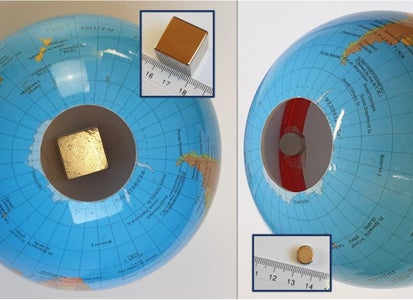

Step 6: The Globe
I was able to find a globe for use as piggy bank. This has the advantage that there's a big opening at the bottom (and the disadvantage there's a slot for throwing in money, too). In this case we'll use this opening to position a strong permanent magnet (Neodymium, 20 x 20 x 20 mm) inside, near the globe's geographic North Pole. I used double-sided adhesive tape to do the trick. You'll need some chirurgical skills and good thinking to finish the job without having to open (and possibly damage) the globe, but... it's possible.
Make sure you position the magnet with its north pole facing upwards (a cube has six sides, so you will have to do some experimenting). Be careful not to make a mistake here: if you place the magnet upside down, you will not be able to make it work! Best is to use a compass to determine the magnet's north pole: a magnet's north pole attracts a compass needle's south pole: this is the needle pointing in the direction of the earth's geographic South (this looks strange, but the earth's magnetic North is located close to the earth's geographical South and vice versa).
Later on, you will have to reverse the electromagnet wires if the force exerted on the globe's magnet proves to be repelling instead of attracting. But don't worry about that for now.
But we also want the globe to rotate, right ? This will require placement of two additional (smaller) magnets inside the globe. Also these are of the Neodymium type. And again, I was lucky... the globe I use, is made of two plastic halves with an inside border (in red) used to glue them together (I guess). This border is the ideal place to position these two magnets: one at the Greenwich meridian, and the other... at the opposite side, of course (the anti-meridian). Note that I used double-sided adhesive tape.
Important: position the magnet at the Greenwich meridian with its north pole facing up, the other one with its north pole facing down. The magnets will generate a (very small) torque, keeping the globe rotating - but that comes later.

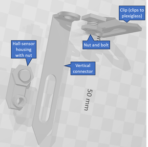

Step 8: Globe Rotation Sensor Assembly
This assembly consists of six 3D-printed parts. Its purpose is to position the globe rotation hall-effect sensor in such a way that it can pick up the passage of the 2 globe rotation magnets mounted inside the globe. Therefore, it allows the hall sensor to be moved horizontally (by moving the 'vertical connector' part forward or backward) and vertically (by sliding the 'hall-sensor housing' up or down in its slot). Once in position, two nuts keep the hall-effect sensor firmly in place.
The hall sensor itself is placed inside the small tube at the lower end of the 'hall-sensor housing'. A precision-contact receptacle is glued to the back side of it (I used Loctite superglue) to receive the three hall sensor leads.
This allows for easy fine tuning the sensor position because the sensor leads are not soldered. Assuming we're using an SS 495A sensor, the stamped side must be facing up (the Arduino program assumes it).
Mounting the hall-effect sensor is a simple task: just bend the 3 leads in a 90° position, slide the sensor inside the small tube (from back to front) and, using tweezers, place the 3 sensor leads in the receptacles with precision-contacts.
The globe rotation sensor assembly STL file (needed for 3D printing one yourself) is available for 3D viewing and downloading through this link: Sketchfab globe rotation assembly 3D model (you will need to create a free account first).

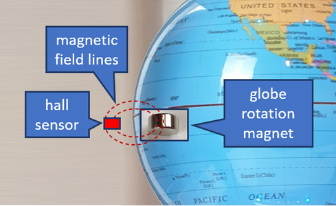

Step 9: Globe Rotation Control System
As explained already, the rotation coils beneath the globe will exert a tiny torque on the globe (because of the two small magnets mounted inside the globe). This torque is so small, that it will only keep the globe's rotation synced with ('locked to') the rotating magnetic field (caused by the six coils) if the two speeds (of magnetic field and globe) are not too far apart.
As a side note, it is certainly not helping that we also have the earth magnetic field trying to turn the globe into a compass: indeed, if the coils are switched off, the globe will always position itself with its two magnets pointing to the earth's magnetic North and South Pole. The fact that the rotation magnets are positioned with their poles facing up and down does not prevent that, because the earth magnetic field lines do not run horizontally - in most geographical areas, they have a vertical component !
Anyway - we need some type of control system - but nothing like the lifting control system described earlier (which is based on pure control theory).
First thing is, the controller needs to have knowledge about the globe's rotation speed. We won't measure this speed directly (although methods exist to do that) but we will measure the time of each globe rotation. As you will have guessed, the rotation hall sensor provides this input. It only detects passage of the 'Greenwich anti-meridian' magnet - the other rotation magnet (at the Greenwich meridian) passes quietly.
The circuit around opamps IC8A and IC8D takes the rotation hall sensor as input (oscilloscope screenshot - blue channel) and provides a pulse (yellow channel) which is then further shaped by a Schmitt trigger (IC8C). The Schmitt trigger output (not shown) is sampled by the Arduino Nano and used as controller input.
If the globe rotation speed is currently too low (lower than the desired speed), the rotating magnetic field speed will be set to a speed slightly higher than the current globe rotation speed (and vice versa). This process is repeated at each full turn of the globe, until the globe rotation speed reaches a small band around the desired rotation speed. Within that band, the control system is switched off and the rotating magnetic field speed is fixed to the desired rotation speed, for once and for all. Globe rotation is now 'locked to' or 'synced with' the rotating magnetic field.
The control system described here will only work if the phase of the rotating magnetic field is set correctly (with reference to the rotating globe). The program takes care of that, but this requires correct wiring of the coils and correct relative positioning of the coils in the horizontal plane with respect to placement of the hall sensor (see the corresponding picture).

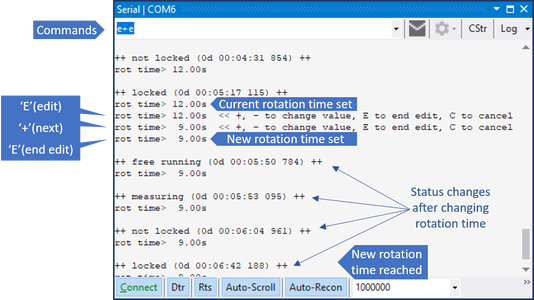

Step 11: Arduino Nano Code
The program is fairly well documented so I will not elaborate too much on it. See the .ino file attached.
The program has been designed for speed. Especially, the interrupt service routines (ISRs) do not make use of floating-point numbers. This means that, for instance, the lifting controller calculations are done with (long) integers, increasing accuracy by adding extra 'binary fraction' digits and removing them at the end of the calculation (shifting values left or right by a number of bits).

This results in an average processor load of about 20%, which is measured by the program and can be verified with the Serial Monitor.

  • polls globe rotation hall-effect sensor

Step 15: Component Placement
The PCB contains quite a lot of components: you'll find a complete list (bill of material) in the file attached
(file '5__2021-globe PCB V1 rev B-BOM').
Parts are clearly indicated on the schematic drawing, the PCB silk screen and in the photograph of the components. I used IC sockets for all chips (female headers for the Arduino Nano) potentially saving me a lot of trouble in case a chip must be replaced. I used 74HCT logic chips because of the low power consumption, but 74LS chips will work as well (IC1 to 4, IC10).
The VMA404 step down converter is mounted vertically, components facing outward (see figure). The terminals are clearly labelled on the main board and on the stepdown converter board.
Before connecting terminal Out+, the converter's trimpot must be adjusted to obtain an output voltage of 7V—temporarily plugging in the external 24V wall power supply. This voltage setting will guarantee proper functioning of the board without dissipating excess power. When terminal Out+ is connected but before placing the actual chips in their sockets, it is good to use a multimeter or oscilloscope to run a few tests verifying that 5V is obtained where expected across the board.
We will need a connection to the three sensors (temperature and two Hall effect sensors), the electromagnet, the coils and the LED strip—and we'll need power, of course. Power is supplied by an external 24V wall power adapter, plugged into the PCB DC connector. It's a good idea to check the polarity first: 24V(+) is to be delivered to the center pin.
The polarity of the two wires to the electromagnet will be determined later (during testing). If the force exerted will be repelling rather than attracting—the wires need to be switched.
Sensor connectors (J3, J4 and J5 on the schematic) each expect 5V, sensor signal output and GND wires to be connected to the same respective connector pin. So, if a sensor is connected to a wrong connector, nothing will breakdown—although the board won't function, of course.
For the lifting Hall effect sensor (connector J3) I did not use a connector at all but soldered the wires directly to the board, not making them longer than needed, because the voltage variations measured are small (less than 0.5mV).
For connection to the rotation coils (10-pin header—only 6 pins used), corresponding signal names are clearly indicated on the two figures indicating globe rotation coils connections and corresponding PCB connections.
The PCB LED strip connector has 5 pins. The pin closest to the DC power jack, pin 1, delivers 5V. Pin 2 and pin 3 are data lines for lower and upper LED strip (currently supplying the same data). Pin 4 delivers the clock signal and pin 5 is GND.

Test 4: power off, connect the rotation hall-effect sensor as well and power on. Hang the globe into position again and give it a slight turn (counterclockwise).
  • Connect an oscilloscope to IC8A pin 9 (Schmitt trigger input) and verify that the waveform you see looks like the yellow waveform in the figure showing Greenwich magnet passage pulse shaping in step 'Globe rotation control system'. If it's not, then try to obtain this waveform by adjusting the horizontal and vertical position of the rotation hall sensor (loosening the two nuts - see section 'Rotation sensor assembly assembly).
  • Tune Schmitt trigger output: connect oscilloscope channel 2 to IC8C pin 8 (Schmitt trigger output). By adjusting trimpot R8, set the input threshold voltage (scope channel 1) to 0.8 Volt (more or less). Supposing you gave the globe a rotation speed between somewhere between 10 and 15 seconds, this should produce a pulse between 0.5 and 1 second, each time the 180° meridian passes the rotation hall sensor.

When you power up the system, you can immediately 'hang' the globe in position (some 35 mm below the electromagnet, or approximately 15 mm below the plexiglass plate holding the lifting hall-sensor): just watch the RGB status led mounted on the PCB. If it lights up steady green, you're at the correct height. If it blinks (green), you're either too high or too low. it needs some practice (not too much, though) but it should be fairly easy.
Once the globe floats, give it a slight turn (counterclockwise) and wait... depending on the initial rotation speed you gave it (which is not critical), after some time, the globe will attain its set rotation time (standard 12 seconds).

Step 18: Controlling the Spinning Globe Via USB
By using the Arduino serial monitor (or other properly configured 'terminal' software) via USB, you can print certain information and change a few settings.
The following information ('parameters') can be printed:
  • Currently selected rotation time (setting)
  • Actual rotation time
  • Rotation time sync error: the accumulated globe rotation time error (when locked)
  • 'Globe rotation locked' time. Reset when globe rotation is not locked
  • 'Globe is floating' time. Reset when globe is not floating
  • Temperature (degrees Celsius)
  • Lifting magnet average duty cycle (%)
  • Globe vertical position: reference (setpoint) in millivolts (setting).Note that setpoint values refer to values as read by the ADC, so they are scaled to 10 (or 15 - see PCB section) times the hall-sensor output for the set vertical position
  • Smoothed average of the absolute value of the globe vertical position error in millivolts as read by the ADC
  • Current value of the integration term, calculated by the globe lifting controller
  • Average phase between rotating magnetic field and rotating globe (when locked). Can be used to calibrate the phase between rotating magnetic field and globe, set by the globe rotation controller before locking is obtained
  • Average duration of the 'ADC conversion complete' ISR routine in microseconds (smoothed)
  • Average processor load (smoothed)
In addition, each status change will be printed (e.g. the selected rotation time is reached).
Use the following commands to print parameters and their values or change settings (sending a 'Carriage Return' is not needed, although you might have to press Enter to send your command to the Arduino, depending on the terminal software you use).
  • '+' or '-' : print next or previous parameter. When in edit mode: select next or previous parameter value from list.
  • 'E': edit current parameter. When in edit mode: end editing and save currently selected parameter value in EEPROM memory. Only available for changing rotation time and fine-tuning globe vertical position, no function for other parameters.
  • C': cancel editing without saving. No function when not in editing mode.
  • 'S' to start or stop showing live values. This will start or stop printing the actual value of the currently selected parameter regularly to the serial monitor (for instance the time it took to complete the last globe rotation). Does not apply to settings.
  • 'A': print all parameters at once, as well as current led strip settings.
Additional commands:
  • ?': print available commands (help).
  • 'T': print time stamp (time in milliseconds since last reset - a real time clock is not available).
  • 'LC0' to 'LC5': select a led strip cycle. 0 = Off, 1 = constant brightness white, 2 = constant brightness magenta, 3 = constant brightness blue, 4 = fade between white and blue, 5 = smoothly cycle between all colors (from blue to cyan, green, yellow, red, magenta, and blue again,...). Selection is stored in EEPROM memory.
  • 'LT1' to 'LT4': change led strip cycle time. 1 = fastest (minutes), 4 = slowest (hours). Note that the timing is not relevant for all led strip cycle types. Selection is stored in EEPROM memory.
  • 'R0' and 'R1': apply an optional step to the globe position reference allowing to capture the response. See next section.
Step 19: Measuring Step Response
Serial monitor commands 'R0' and 'R1' let you apply an optional step ('R1') or no step ('R0') to the globe vertical position reference (setpoint) and then sends the measured response (actual globe vertical position) and controller output (PWM duty cycle) to the serial monitor where it can be logged for evaluation in excel etc.
The step applied ('R1' command only) increases the vertical position setpoint with 100 ADC steps. Expressed in millivolts at the hall sensor output: 100 ADC steps * (5000 millivolts / 1023 ADC steps) / 10 = 49 millivolts (if the analog gain is set to 10 - see section 'PCB').
The Arduino starts sending data to the serial monitor, 1 second before the step is applied ('R1' command) and continues sending data for 20 seconds.Every millisecond, a line containing three values is sent, the values being separated by a semicolon. Value 1: millisecond (1 to 20000)Value 2: lifting hall-effect sensor value read (in ADC steps)Value 3: controller output (PWM duty cycle as a value from 0 to 999 = 100%). See the excel step response chart attached as picture.
A few notes on the use of the 'R0' and 'R1' commands:
  • The 'Rn' command requires a high baud rate: the baud rate set by the program is 1000000, so this shouldn't e a problem.
  • The value of the integration term (see section 'Globe lifting control system') including extra accuracy digits (see section ('Arduino Nano code') at the start of the 'Rn' output (first millisecond) is printed to the serial monitor as well. This allows 'replaying' controller calculations in excel based on logged hall-effect sensor values (in ADC steps), verifying that the calculated controller output in excel is identical to the logged controller output.
  • When sending step response data has ended, the globe vertical position is gently brought back to its original setting.
  • Do not use this command while you are showing Live values (see 'S' command)
