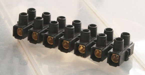

1. 4 Electric clamps (those small black ones, actually the color doesn't matter)

3. Make 4 rope clamps: Take the electric clamps and CAREFULLY cut the plastic from them. I held them with the pliers (you can use a vise) and cut them with an X-Acto knife. What we're looking for is the metal part inside them and the screws.
It's easier to remove the plastic when the screws are removed (but don't throw them away!).
