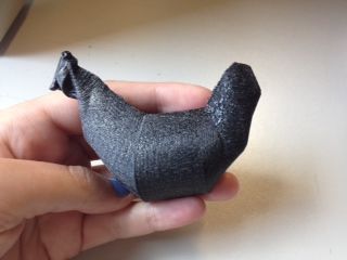

Step 13: Final
The gravure stays visible, even when everything is black.
The skai folds nicely inside thank to the corner-holding.
The underside stays strong and doesn’t fold inside, what I expected from the beginning. It looks pretty like this.
