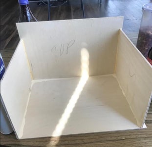

Step 3: Assembly Part 1
Now that we have all the pieces, it is time to build the stage.
- Start with the roof of the stage, and glue the short side of the 2 side walls to the sides of the top. There will be a small overhang.
- Use any weighted items, such as books, and bottles to help support the parts as the glue dries as shown in the first picture.
- Glue this dried piece against the back piece and wait for it to dry, it should look like the second picture.
