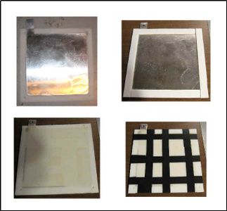

For the switches in this design, aluminum roof flashing is used as the metal contacts. This material is relatively inexpensive, and can be purchased at most hardware stores. The material is typically sold as a long sheet (about 0.008” thick) that is rolled up. It can easily be cut by scoring with a utility knife, by laying a straight edge along the line to cut. It can also be cut with heavy duty scissors.

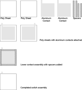

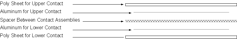

The switches consist of an upper and a lower contact assembly. Each of the contact assemblies are constructed using 1/16” thick polyethylene sheets and aluminum as shown in the diagrams. A metal contact made of roof flashing is attached to each of the two polyethylene sheets. I found that double- sided carpet tape worked well for attaching the aluminum to the poly sheet. It is important that the aluminum be securely attached to the poly sheet, so that it doesn’t come loose and hang down, contacting the aluminum plate on the other switch contact assembly.
Around the base plate a border is created using a non conductive material like cardboard or plastic. This material serves to separate the two plates so that they do not touch when no pressure is present. The material should be only about 1/16” to 1/8” thick, as the upper plate must be able to flex down to contact the lower plate without requiring the user to apply excessive force.
The upper contact assembly is constructed similarly to the base, again securing the aluminum to the non conductive backing with double faced tape. The backing material, be it polyethylene, particle board, or whatever, must be flexible enough to allow the plate to flex down when stepped on, and then flex up when the pressure is removed. So, a rigid material will not work well for the upper plate backing.
The upper contact is assembled on top of the lower contact, with the spacer material in between. Refer to the diagram showing how the layers stack up. Lastly, the whole assembly is held together by wrapping tape around it in both directions. The completed switch assembly is shown in one of the pictures below.
Note that each of the metal contacts has a small tab which protrudes outside of the polyethylene sheets. This tab is used for making connection to the wire leads. The leads cannot be soldered to the tabs, as aluminum cannot be soldered to. To make a reliable electrical connection, I stripped a few inches of the wire, and taped the stripped portion down to the connection tabs on each of the plates. The idea behind stripping a longer length of wire is to provide more surface area of the wire in contact with the aluminum plate.

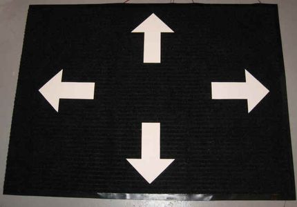

Step 6: Assembling the Game Controller Mat
The switches are arranged underneath the mat as shown in the diagram. A 36 inch by 48 inch floor mat was used to cover the switches. Each switch is held in place to the underside of the floor mat using duct tape.
The picture shows the actual mat, with arrows indicating the location of each switch.
If the mat is going to be moved often for storage or other reasons, then a more robust assembly may be required.  If the switches are simply taped to the underside of the mat as described above, then they may work loose and fall off if the mat is picked up and turned over.  A more robust construction would be to place a sheet of rigid material like plywood or heavy cardboard beneath the switches, and then attach the switches to that.

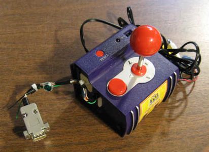

The picture below shows a self contained game controller that includes four classic arcade games. This device attaches to audio and video inputs of your TV, and all the game circuitry is contained in the base of the unit. This system uses a four button joystick, with the switches sharing a common ground, just like the Atari 2600 system. I added an external 9 pin D-sub connector that breaks out the internal switch connections, so that I can play the game as-is or connect an external controller like the mat controller or a standard Atari joy stick.
