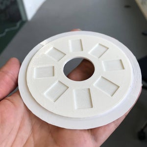

3D print the attached disk for microSD cards and trim it.

Glue the 3D printed disk to the original magnetic disk with acrylic glue like in the picture.
