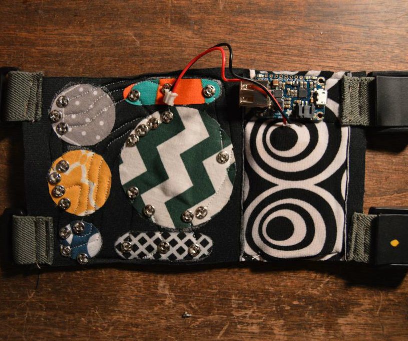

I created this piece so my students could quickly prototype wireless wearable project ideas. As you can see, the armband allows for various sensors to be snapped in and out. In fact, all electronic components are detachable making washing, maintenance and repair much easier. This armband is ideal for rapid prototyping and introducing students to creating wireless projects. In the case of my student's work, they received the sensor data into Max/MSP to develop realtime audio/visual feedback.

Step 2: Helpful Notes Before You Start
A note about the Bluefruit: The only I/O's you will need on the Bluefruit for this project are RX, TX, Vin and Ground.
A note about the Flora: I have had zero luck using the RX/TX I/O's on the Flora. For this project, I use a soft serial library to communicate between the Bluefruit and Flora. For this project, RX = D10 and TX = D9 on the Flora.
A note about sensors: I built this armband to use both Adafruit's Flora wearable sensors and any variable resistor sensors students wanted to use. As you can see in the prototype in Step 3, I built a snap in circle for the Flora wearable sensors, and I dedicated D6 and D12 for analogue input. If you want to use two variable resistors, you will have to add an extra snap to your power and ground lines as I have done. (See image above.)
A note about the electronics layout: The following steps explain how to make the armband in the image above. If I were to make this again, I would rotate all of the electronics 90 degrees so that the band was thinner. I found that this layout worked well on men but was a little bulky on women.

Step 4: Adding Snaps and Sewing With Conductive Thread
Soldering snaps to your Flora and wearable sensors:
The nice thing about most wearable microcontrollers is that you can solder snaps directly onto them. Solder snaps onto both the Flora and onto any Flora wearable sensors you want to play with. If you haven't soldered snaps before, follow Adafruit's tutorial.
Making the Stencil:
Once you've soldered on your snaps, firmly press the Flora/sensors into a notecard until the studs push through and make holes. Use this notecard as your stencil. Lay the stencil onto your felt rectangle and with the fine point sharpie, mark where you will sew the other side of your snaps. Using your prototype as a model, make a dotted line branching out from each snap location. You will use this as a guide for sewing your conductive thread.
Sew the Conductive Thread:
If using a sewing machine, place the conductive thread in your bobbin compartment and regular thread in the top. Sew along the dotted lines leaving long threads on each side. Use the long threads on each side of the stitch to sew down your snaps. You will have to use an embroidery stitch to complete this. When you knot the ends of your conductive thread, don't cut the end right away. Conductive thread has a tendency to "un-knot," coat the knot with clear nail polish or Fray Check to harden the knot. Once it dries, cut the thread end close to the knot to avoid shorting with other knots. For more detail on machine sewing, check out Adafruit's tutorial.
If you do not have a sewing machine, you can hand stitch these lines. Just make sure you use the same piece of conductive thread to sew down your snaps. Stitch down one snap, sew along your dotted line, and then sew down your other snap. You will need a very long piece of thread for this. Here is another great Adafruit tutorial on hand sewing with conductive thread.

Cut strips of felt to make the straps. NOTE: In the future, I would use thin ribbon or trim that will more effectively hold shape when clasped. I would also make more straps to accomodote more arm sizes. Sew down the straps as shown in the image.
