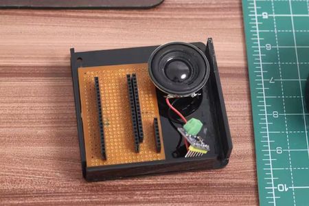

Step 5: Enclosure & Assembly
In this project, we opted to use a 3mm black acrylic sheet as the enclosure for our device. To obtain the desired shape, we collaborated with a local store equipped with laser-cutting capabilities. We provided them with a DXF file, which contains the design specifications for the enclosure. The laser cutter precisely followed the instructions in the DXF file to cut the black acrylic sheet, resulting in a custom enclosure for our project. The choice of black acrylic sheet adds a sleek and professional look to the device while providing durability and protection for the internal components.
To fit the controller and the amplifier we used a perf board with the female headers. Then the speaker was glued to the acrylic directly.
