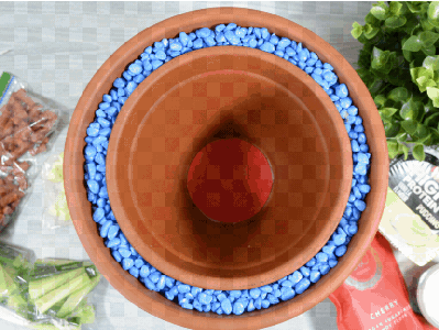

Step 4: SAND FILL
ONCE THE GLUE IS DRY FILL THE OUTER SPACE OF THE POT WITH SAND.
COVER THE INNER POT WITH A PLATE OR FOIL.
USE A FUNNEL OF A PIECE OF PAPER TO ACT AS ONE AND POUR THE SAND IN.
HALF WAY THROUGH THE POT, YOU SHOULD STOP, PICK UP THE POT AND SHAKE /TAP EVERYTHING GENTLY - IT WILL HELP DISTRIBUTE EVERYTHING EVENLY.
TOP IT OFF WITH MORE SAND, LEAVE ABOUT 1CM SPACE BETWEEN THE SAND AND THE LIP OF THE INNER TERRACOTTA POT- YOU NEED SPACE FOR PEBBLES AND AN OVERFLOW OF WATER.
Step 5: ADD WATER
SLOWLY ADD WATER TO THE SAND.
YOU DON'T HAVE TO ROTATE THE POT, YOU CAN POUR FROM ONE SIDE, THE WATER WILL SPREAD THROUGHOUT ON ITS OWN. YOU MIGHT SEE SOME BUBBLING.
IF YOU THINK YOU'VE ADDED ENOUGH WATER, STOP AND LEAVE IT TO SETTLE FOR A FEW MINUTES, THEN TRY ADDING MORE WATER.
IF YOU END UP WITH A LAYER OF WATER POOLING AT THE TOP OF THE SAND- THAT'S YOUR QUE TO STOP ADDING WATER.

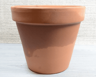

WHEN WATER IS BEING DISTRIBUTED, IT WILL SEEP FROM THE TOP TO THE BOTTOM AND YOU WILL BE ABLE TO SEE THE PROGRESSION FROM THE OUTSIDE- VISIBLE DARK PATCHES CULMINATING IN AN EVEN, DARKER COLOUR OF THE POT. IT'S COMPLETELY NORMAL, TERRACOTTA IS UNGLAZED AND POROUS, SO IT WILL ABSORB WATER .

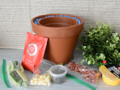

Step 8: FINAL TOUCHES
WHEN WATER HAD SOME TIME TO SETTLE, YOU CAN DECORATE THE TOP LAYER WITH PEBBLES.
IF YOU CAN, GLUE THE PLANTER FEET TO THE BOTTOM OF THE BIG POT - THE PLANTER HAS TO BE ELEVATED TO ALLOW FOR A GOOD AIR FLOW.
Step 9:
HERE IT IS- MY SNEAKY SNACK NOOK. NO-ONE WOULD EVER SUSPECT THERE IS A CACHE OF FOOD HIDING INSIDE.
