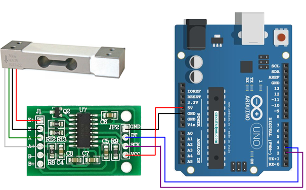

For that initial idea I wanted to have a big flowerpot with the flower in it and a smaller pot that the user could put little blocks in to that corresponded with their tasks. A weight sensor would give me the data I'd need to progress the steps and the leaves of the flower would open by servos that would rotate, eventually the last block added to the weight sensor would trigger LEDs in the center of the flower.
(image below is the weight sensor setup I tried out)
When I tried this out it didn't really do what I wanted, I couldn't get the weight sensor to work the way I wanted to and servo movement ended up being more constricted than I thought, causing the steps to be very minimal, which wouldn't be good for showing progress.

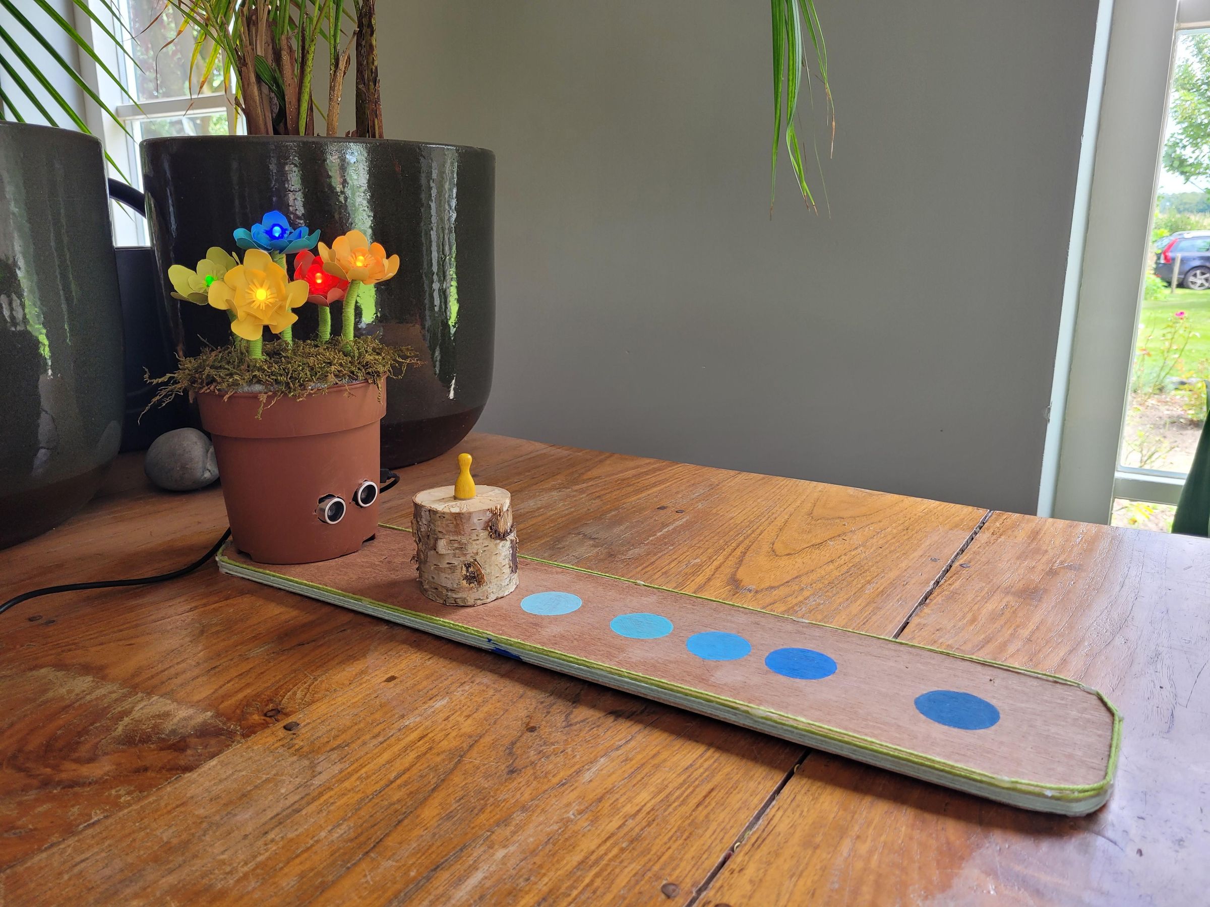

That idea is the one I went with in the end; a distance sensor that lets one flower core made with a LED light up everytime the player pawn gets moved forward on to the next task area. This way the user of the tool has a physical way to track their progress and gets rewarded with real life visuals, which hopefully stimulates their productivity a bit.
(Image below shows the final setup with multiple flowers and the 'playing board')

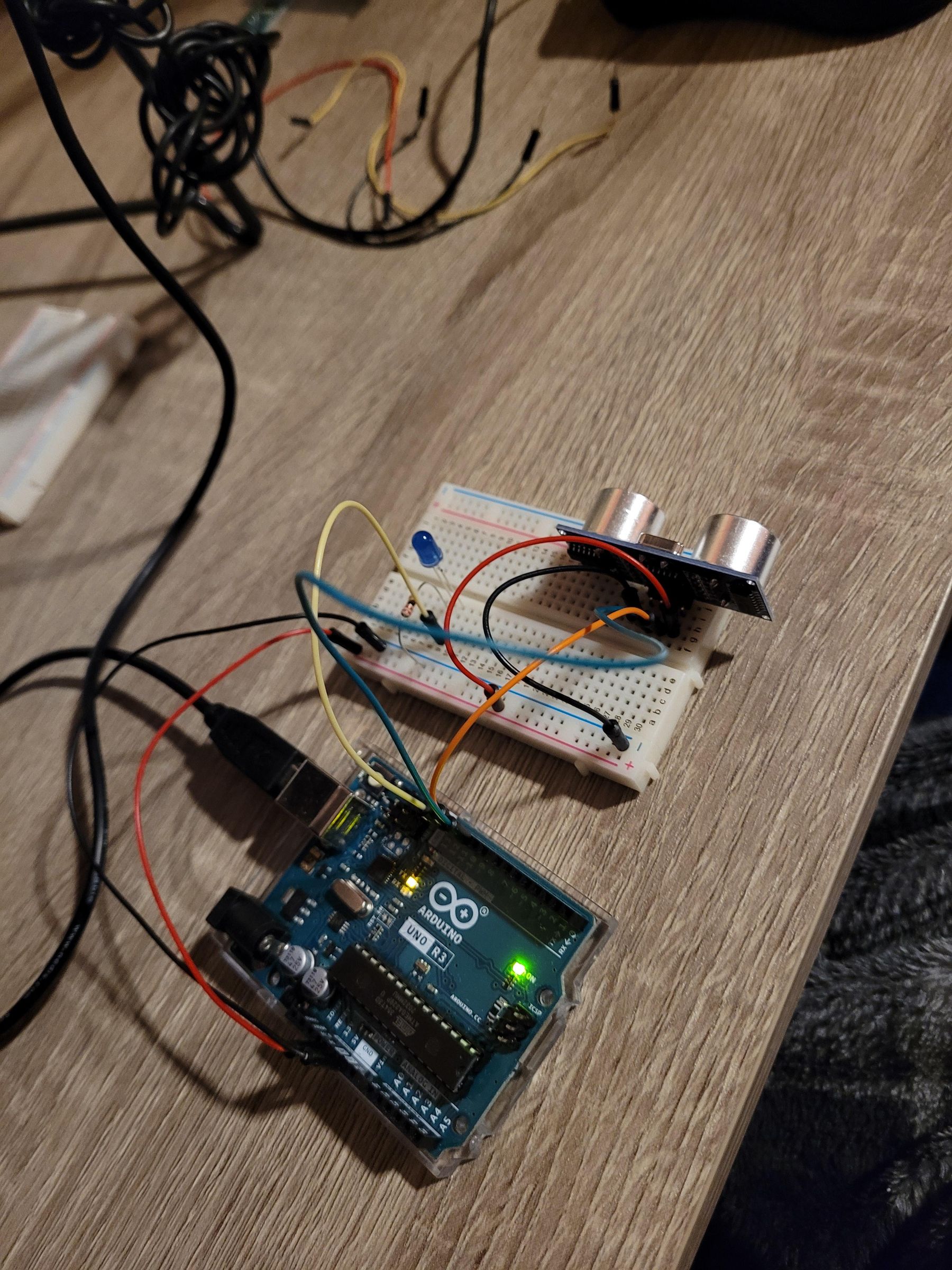

When I had a definite concept to work towards, I could start testing and assembling the electrical parts of the concept. I started with a circuit we worked on in class which lights just one LED consistently. I had managed to do that in class and recreating it again at home went smoothly.
(Image below is the single LED in class)
After I knew how to get a LED to turn on, I needed to figure out how to connect it to a distance sensor. I knew that in our class materials there was information on the distance sensor and I used that to create a circuit in which a certain distance activates the LED.
(Image below is the distance sensor connected to a LED)

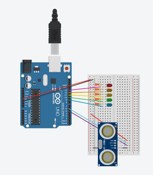

From there I had to create a way to make multiple LEDs turn on sequentially. After looking some projects up on having multiple LEDs in a row it appeared that doing so wasn't very complicated; you had to duplicate the setup for the single LED next to it and place it into a seperate pin on the arduino. Then the next thing to do was to alter the code for the single LED by adding more instances that correspond with the pins used for the other LEDs. Then in the Void Loop you add more if statements with different distances; I used distances from 30cm to 10cm. Within those different if statements with their different distances, you add all the lights in the right order that need to be on when the player pawn is at that distance. So if 20cm from the sensor is 3 steps with the pawn, you list the 3 pins with their corresponding LEDs to that if statement and set their mode to HIGH to turn them on.
When that works you can get started on soldering and putting the elements in place.
(Images below is of distance sensor with sequential light set-up; distance sensor is missing in the first picture but is supposed to be plugged in below the red, orange, green and black wires)

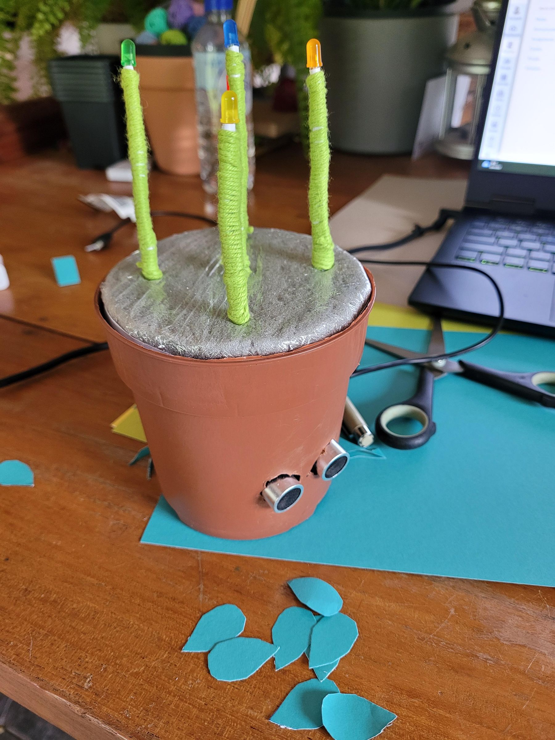

Since at the start the cables and connections were pretty frail and easy to damage I had to work carefully and guide the cables through a foam layer, but after several layers of tape and covering the stems in coloured yarn afterwards it was all a little easier and secure to work with. When the stems were thicker and coloured by the yarn I could start working on the flowers.
(Image below is of stems made more secure with tape and yarn)

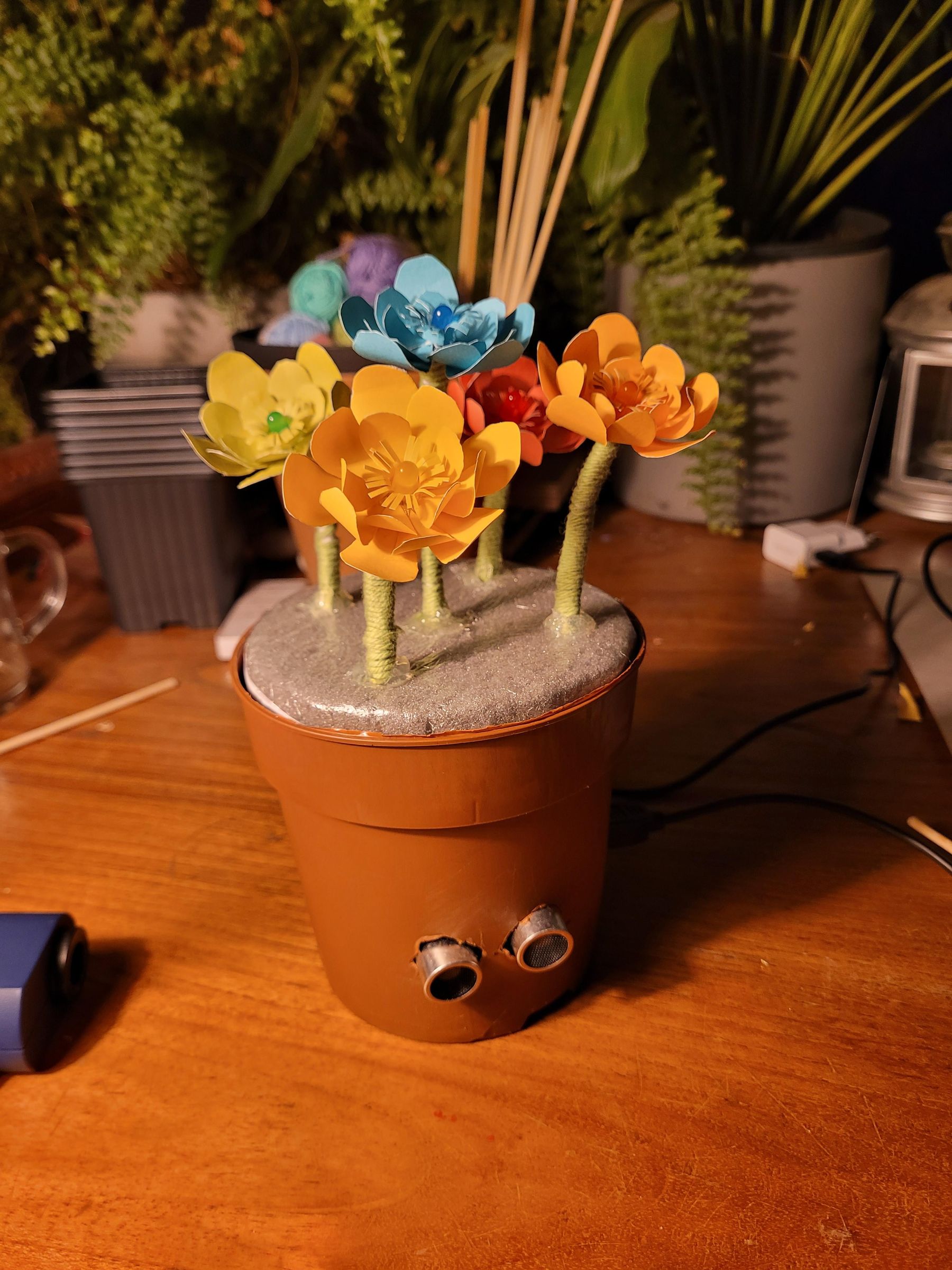

The flowers I made from coloured paper; I cut out small petals in three different sizes and used a glue gun to secure them to a round piece of paper. After doing so I had to create a hole that the LEDs could fit through, which was difficult as the paper would easily tear and rip, but after a couple tries I got a method that worked decently. Finally with all the flowers in place I could add little frill details around the LEDs. The last part of the flower pot itself was to cover the foam with dried moss to finish the look.
(Image below is how the flowers look when finished)

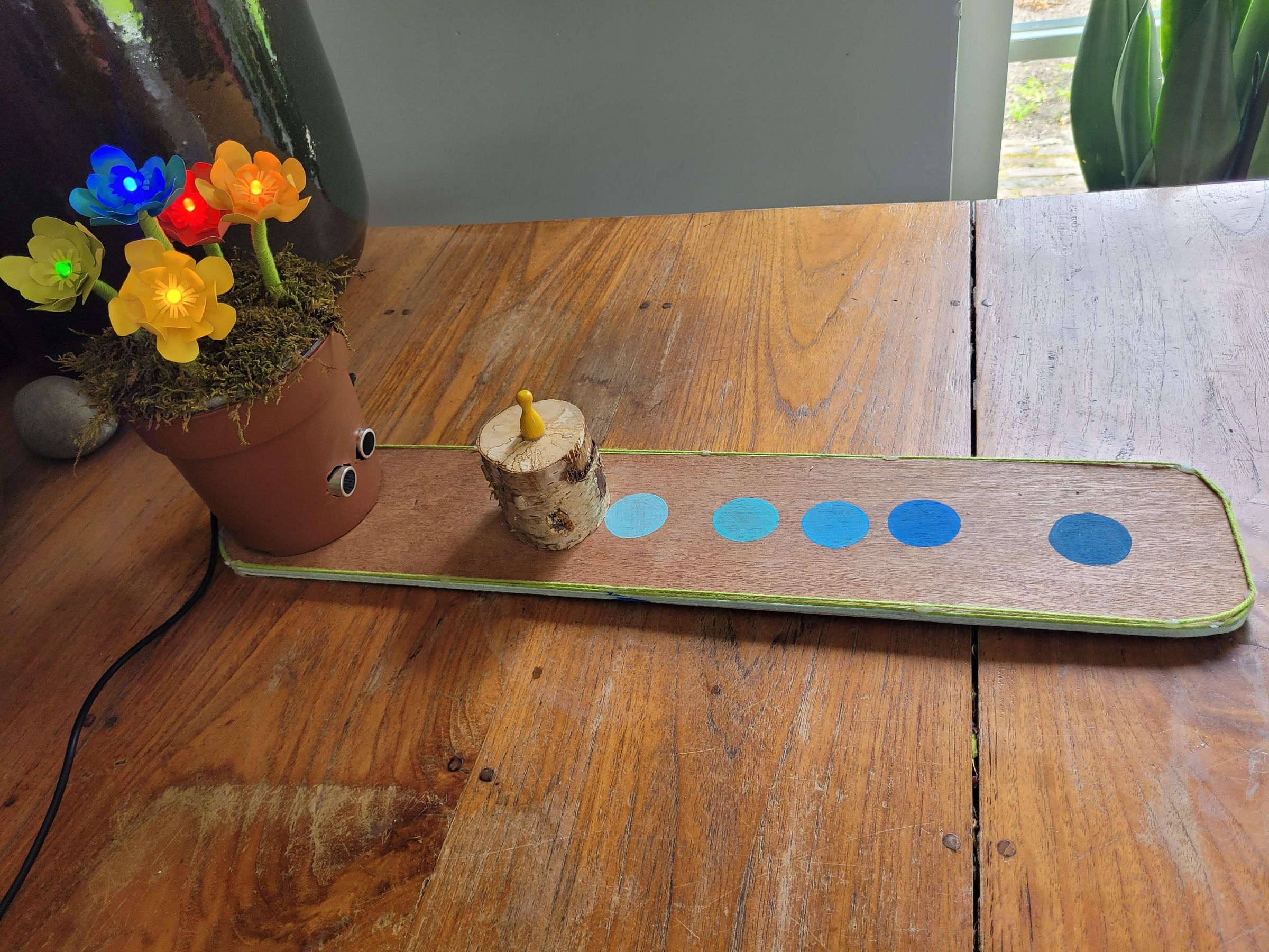

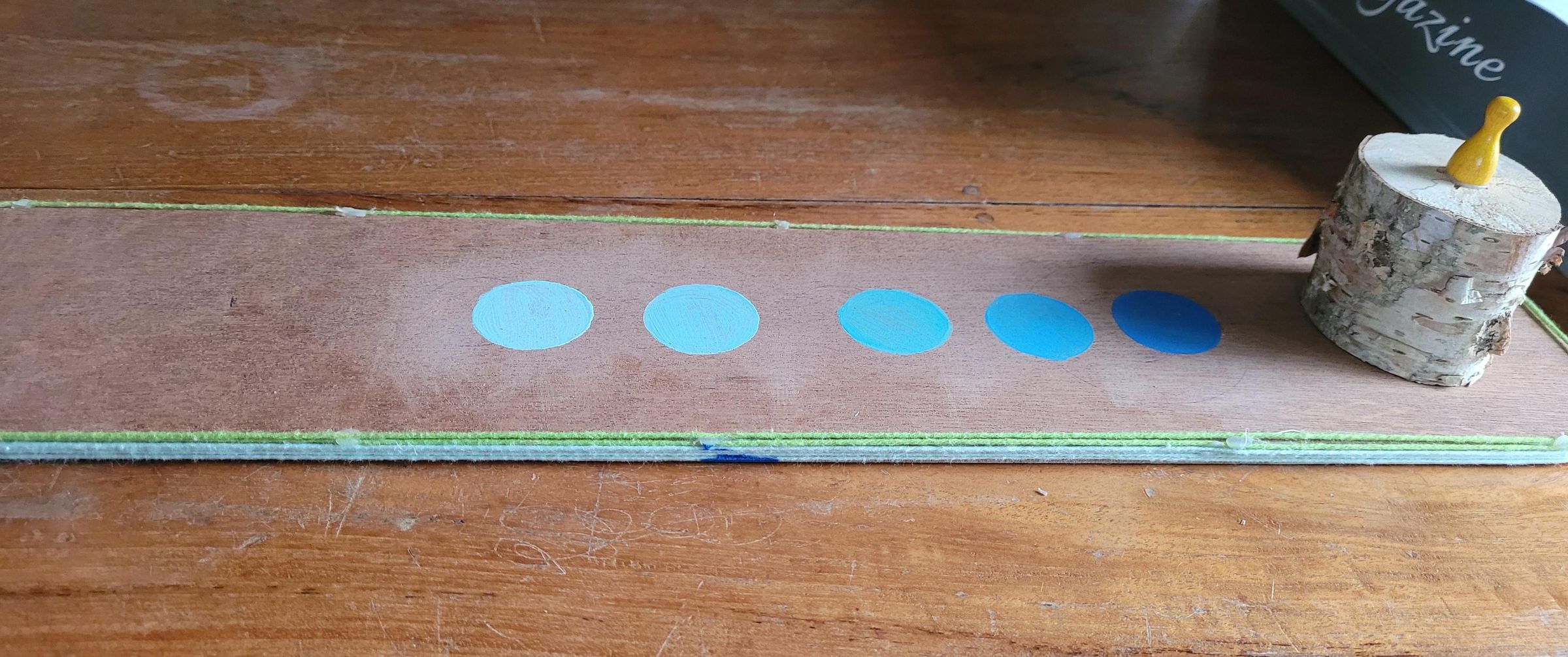

With that part done, the only other thing to do was the board on which the user can move their pawn closer to the sensor. To do this I took a thin wooden plank that was 10cm x 50cm and rounded the corners to connect the round shapes of the flower pot to the player board. Next I had to measure exactly where the sensor readings gave the most stable results with the lights so that I could paint circles on the board that indicate the steps the user can take with their pawn. I made the circles a gradient from darkblue to lightblue as blue is a calming colour and fit the set-up well, especially since the center flower in the pot is also blue and it binds it all together.
Finally it was time to create the pawn which consisted of cutting a piece of a 4cm diameter birch branch, sanding it down a bit and using the glue gun to glue a small Ludo pawn on top of the birch piece. It doesn't necessarily have to be a birch branch, it could also be a big rock etc. As long as the user can tell that it is their piece they can move to track the progress (hence the recogniseable Ludo pawn) and the object is wide and high enough for the sensor to properly pick it up as just a Ludo pawn for example would be too small, causing flickerings in the light.
As a final touch I added some of the coloured yarn on the sides of the plank since I felt it made the entire set-up more of a whole and gave it a bit more life.
(Image below shows pawn and board)
Then this was what everything together looked like:
