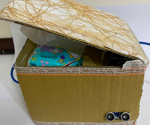

Introduction: Flowing LED Lights Pillow
In this experiment, I am doing a flowing LED light pillow. The project demands several simple components to make for it. The lights inside the pillow are with white and yellow colors, which will let you chill and have a good mood before sleeping.
- Arduino Leonardo board * 1
- USB cable * 1
- Resistor (220Ω) * 8
- LED * 8 ( 4 white & 4 yellow lights)
- Breadboard * 1
- Jumper wires
- Pillow * 1
- scissor
Step 1: Build the Circuit
Follow the circuit in the pictures above.
Step 2: Type the Code In
The part I changed is the time that the LED shines, I changed it from 100ms to 200ms

Step 3: Put the LED Lights in the Pillow
Use a scissor to cut holes on the sides of the pillow, then put the LED lights inside
Step 4: Done!
It should look like this!
