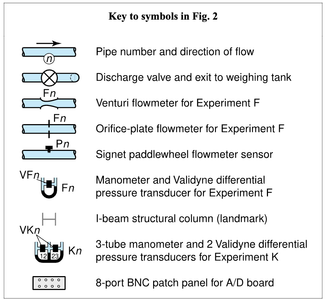

  1. Talbot Laboratory pipe system
  2. Orifice hydraulic flowmeter
  3. Paddlewheel flowmeter
  4. LABView software
  5. Water-mercury height differential manometer
  6. Weighing tank
  7. Stopwatch

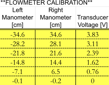

We now need to calibrate the Validyne differential pressure transducer. To prevent fluctuations in the measurement this should be done without any flow in the system. Using the interface box zero the transducer to start. To create artificial pressure differentials open the manometers CAL VALVE and use LabVIEW software to record the corresponding transducer voltage(in volts) and manometer readings(in centimeters). Take at least five measurements ranging from the maximum permitted differential to zero pressure.
