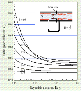

Step 3: Obtaining a Relation Between Discharge Coefficient and Reynolds Number
The discharge coefficient, Cd, can be plotted with respect to the Reynolds number, Re, where the discharge coefficient axis has a linear scale while the Reynolds number scale is logarithmic. Both of these values were found through using the full pipe diameter, D, the Reynolds number can be found using the following relation: Re=V1*D/v. V1 is the pipe velocity while v is the viscosity. Furthermore, the discharge coefficient can be found through equation seven listed above where Beta is the quotient of the orifice diameter, d, and full pipe diameter while Q is the flow rate. An example plot can be found above as well.
Step 4: Hydraulic Flowmeter Discharge Coefficient Information
As seen in step three, the discharge coefficient remained relatively constant throughout the range of Reynold's numbers utilized during experimentation, although this value is not the ideal, theoretical value of one for the discharge coefficient. Instead, it remained at 0.7 which is still relatively close. The reasoning for the difference between the theoretical and experimental values is related to the assumed ideal conditions which are not necessarily true, such as no friction present in the system. Consequently, to obtain more accurate theoretical results, the Reynolds number should decrease as the discharge coefficient increases, as seen in the figure above, which can occur when a smaller flow rate is achieved. Although, if the flow rate is too small, data collection may become a challenge and therefore may not be possible through the experiment completed in this tutorial.
