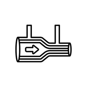

Step 2: Plot the Discharge Coefficient As a Function of the Reynold's Number
For Venturi and Orifice Plate Flowmeters: Using values from the calibration curve created in the previous step, plot the discharge coefficient as a function of Reynold's number on Linear-Log scales. See attached picture for example. Reynolds Number: Re = V1*D/v where V1 is the fluid velocity, D is the full pipe diameter, and v is the viscosity. You may notice that the discharge coefficient may appear to be relatively constant or have an unexpected variation over the range of Reynold's numbers tested. This is because flow separation occurs as the fluid passes through the reduced diameter section of the flowmeter, which is not accounted for in the theoretical derivation of the Discharge Coefficient, which causes deviation from the theoretical value of 1.
