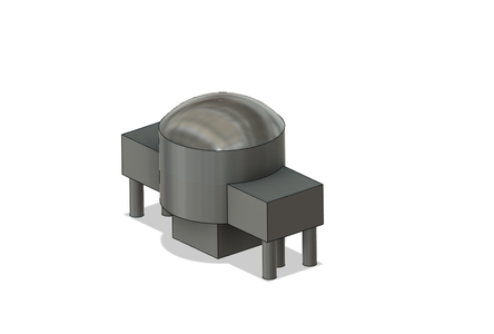

Step 4: CAD Design: Laying Outline
The following steps all pertain to the CAD Design, which I did in Fusion 360 software with student access. For said steps, I will merely be covering the specific steps that I took in order to bring about the design, but you can make adjustments along the way if you hope to scale this design or hope to create a design of your own. For this particular design, I used inches as I wanted it to match the scale of the prototype I planned to create, but you can scale this if you have more material constraints.

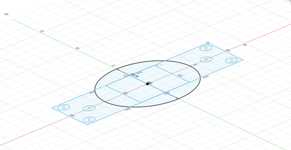

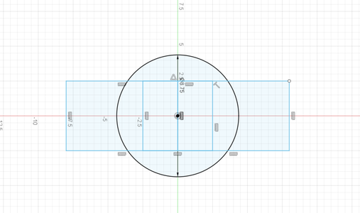

  1. Create a new drawing on the top face, create a circle of 8.75 inch diameter, create a central square with length 5, and create a large rectangle of 16x5 for the extending rooms
  2. Create 6 circles for the pillars, near the ends of the extending rooms, and establish layers for walls around the latent objects
  3. Extrude the 6 pillars upward 3 inches, whilst also extruding the central support mechanism 3 inches as well.

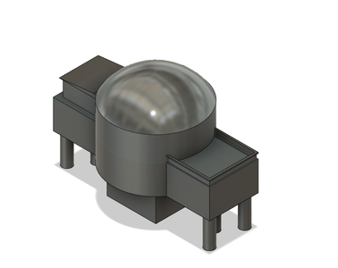

Step 5: CAD Design: Establishing Floors
This was a step that I included to show that aspirations and design conditions can change and be altered through the design process itself. I initially planned to make the floors crossed, but had a temporarily idea to create the second floor upward as well and decided to pursue this. However, upon realizing that my previous design was more substantiated, allowed for more of my initial factors, and introduced additional support and aesthetic for the building, I decided to return back to that design.
  1. Extrude the base of the design, located above the pillars, upward nearly half an inch
  2. Extrude the walls of the design another 3 inches further past the base and ensure to draw the borders for these walls in the corners if you had not done so previously
  3. Create yet another half inch enclosure for the second floor floor and base
Step 6: CAD Design: Final Developments

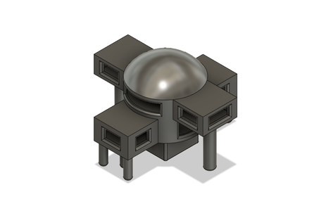

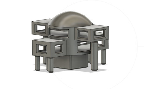

  1. Hide the previous base drawing and create a new one on the top plane but resting atop the ceiling of the first floor. Create the circle and extending rectangle to the same specifications mentioned initially.
  2. Extend both of these upward 3 inches, and crate the final 0.5 inch barrier between the second and third floor.
  3. Go the front view and create an arc along half of the width of the house from the ceiling of the second floor. Make sure to make this a whole and complete shape
  4. Revolve the arc by the central axis and create the dome structure included within the design. You can adjust the size of the dome to your liking, especially the height, but I set it at around 2 inches.
  5. Fillet and chamfer as needed, I filleted the connections between the pillars and the button of the base as those allowed for greater extensions and became more capable of handling support loads. I also filleted the edges in order to save on material costs while also making the design more aerodynamic as planned and not compromising any of the structural integrity of the design itself.

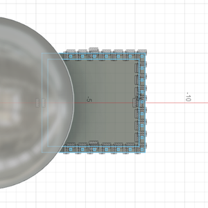

  6. Next step involves adding lighting. This is a seemingly simple task as well, simply take the LED strip that you have, which I had around 10 feet of with 1 inch spacing, and then circle all of the base areas on the Fluidome structure to represent the external flood lighting and emergency system. I did not use all 10 feet, I used around 6 and the rest of the strip I cut for use in another project.
  7. Optionally, you can add a USB solar panel as well to siphon electrical power for the particular system, which I added on the second floor and then routed so it moves down and into the enclosure. This USB solar panel didn't work the best, but it is an optional addition to get closer to the real design that would use this form of sustainable energy and it helps to show how the emergency lighting and flood lighting can be stored and released.
  8. Once you have finished the LEDs, connect the LED strips to the power supply, which is housed within the enclosure that can be placed at the base of the design or in the circuit box. The circular cutout was poised for this addition and you can simple insert the power supply wire into the LED control enclosure and then have a lighting solution with no loose wires or such. This is a representation of underwater cables and transmission.
