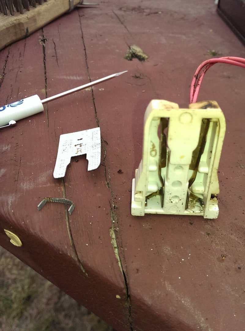

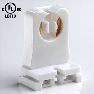

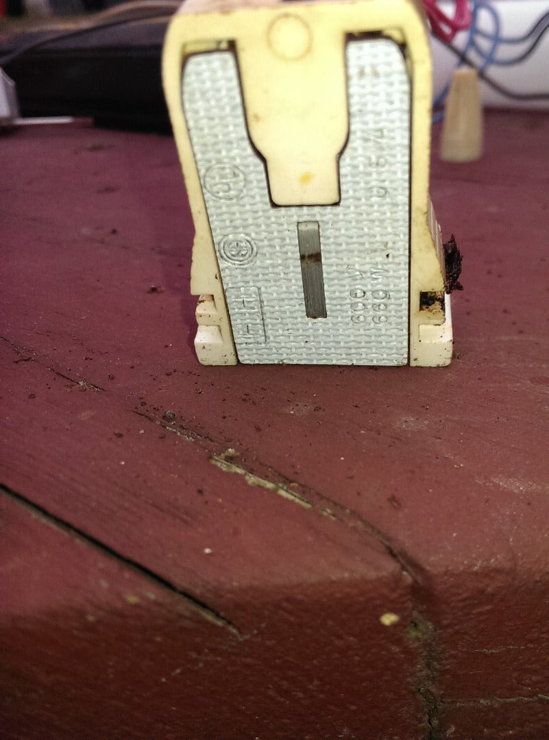

There are a couple of important things to check to see if the process will be easy. The connector at the ends of the tubes are what you need to check. These bi-pin connectors are commonly referred to as "tombstone" connectors because of their shape. These have two different styles: shunted and non-shunted. For the work I am showing, we want non-shunted connectors. The primary difference is whether or not the 2 pins are electrically connected.
The type of fluorescent tube will also help identify the connector type. My fixture uses T12 tubes. This type of tube is pretty old and has been replaced by a newer, more efficient T8 size. The good news is both sizes will fit in a fixture designed for T12 tubes. The bad news is they're not always interchangeable because the ballast inside the fixture usually works for only one type of tube.
This Instructable shows installation of a fluorescent ballast that uses non-shunted tombstone connectors, and the connectors in my fixtures happened to be non-shunted. The fixture I show had an old ballast that used T12 tubes, while the new ballast only works for the T8 size.

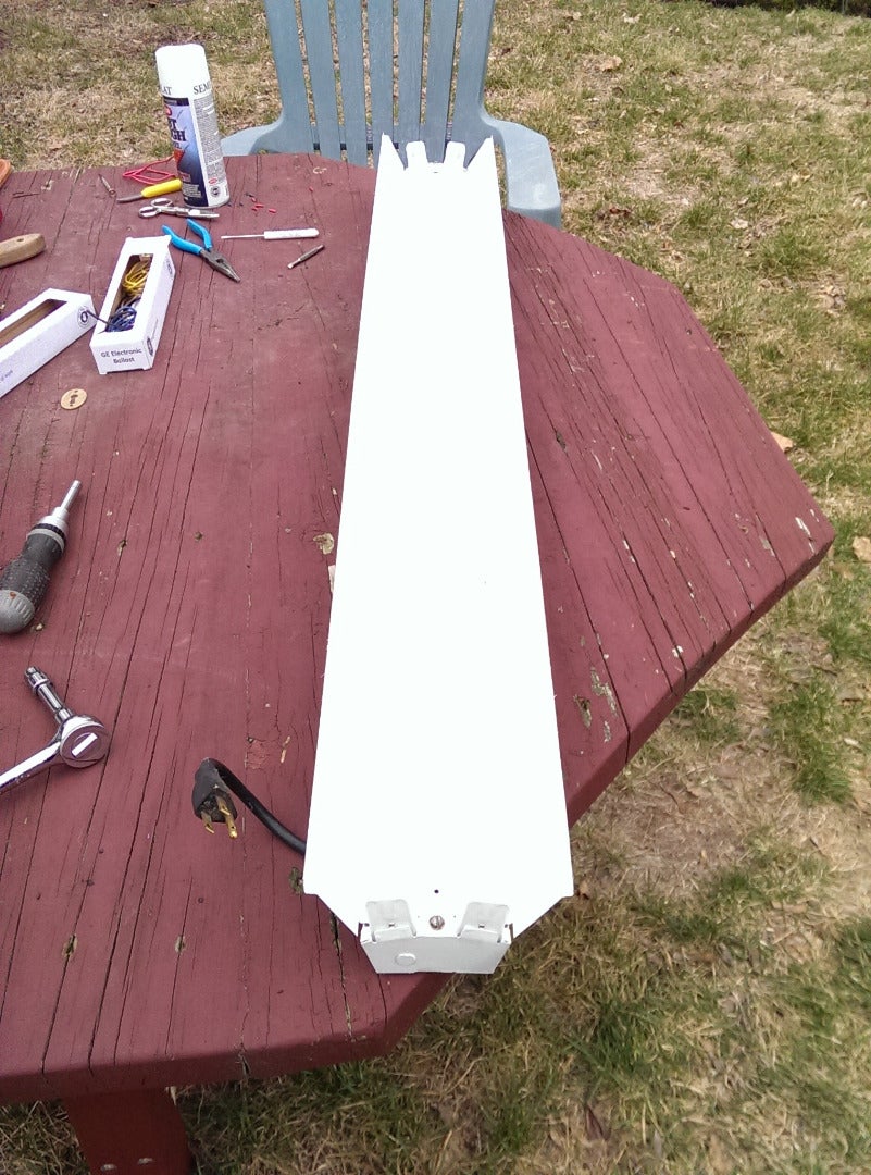

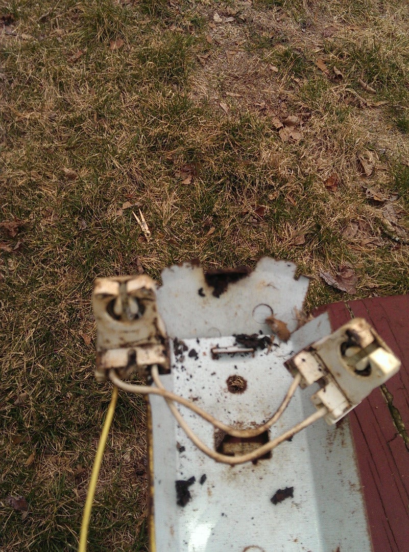

Step 3: Never Fails, There's Always More Work Than You Thought...

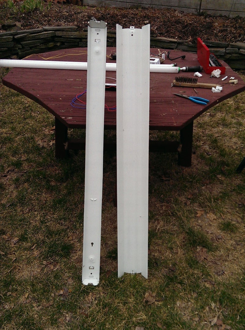

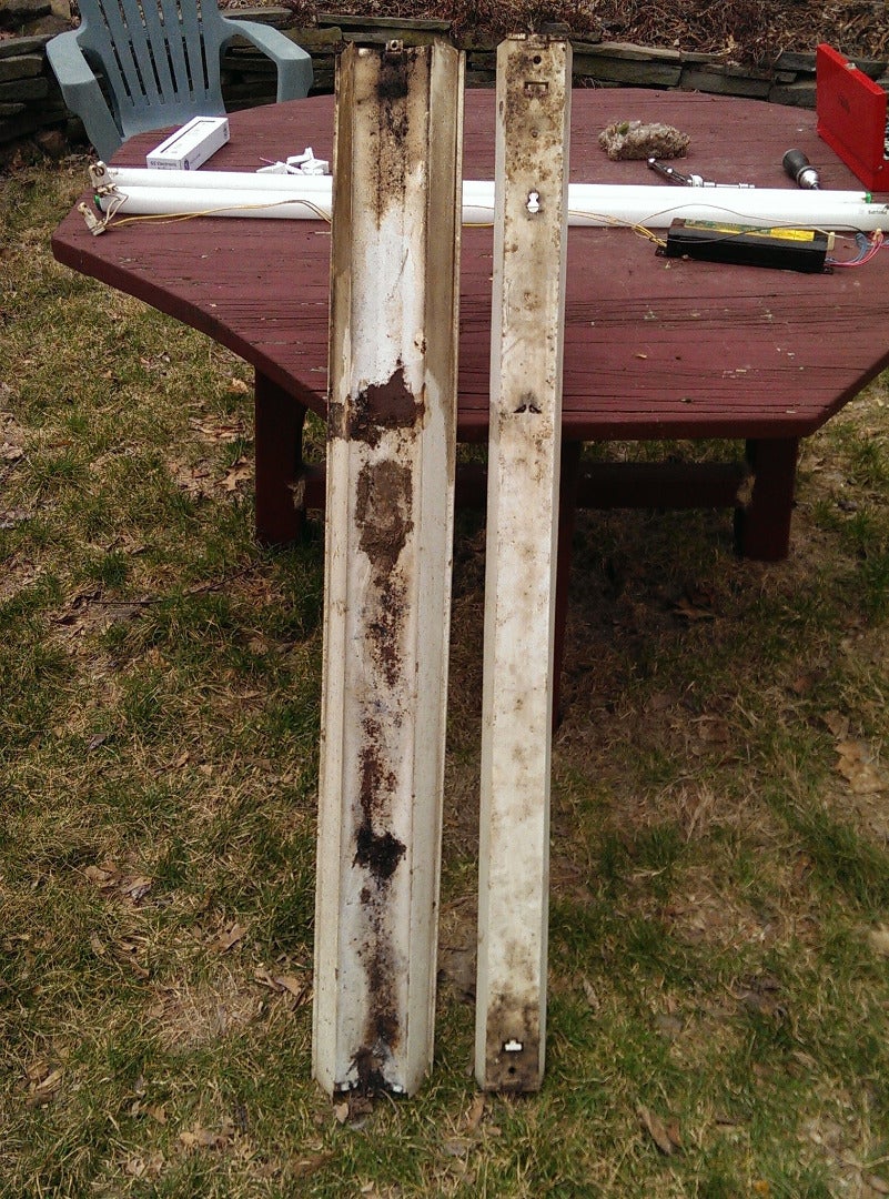

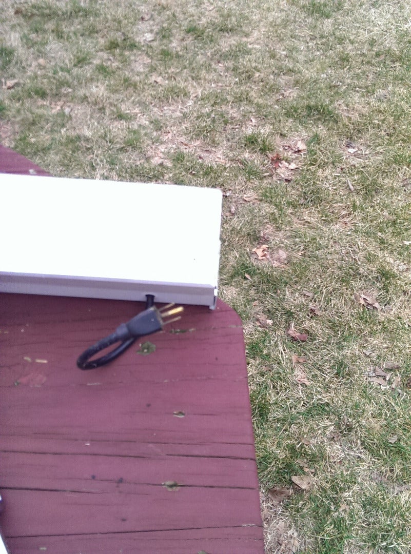

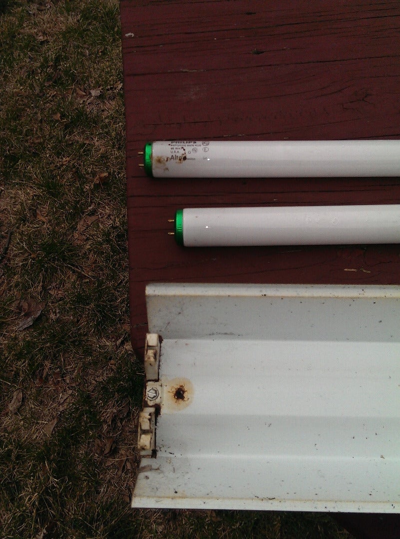

The first time I tried this replacement, I worked on a ceiling fixture in my basement and it was clean and simple. Of course I didn't document that process. When I decided to document the process for an Instructable I used the plug-in fixture that had been out in the backyard shed for many years. It was beat up and really needed some remedial care. The pictures show you how much of a fire hazard it really was! It was a wonder it hadn't shorted out and burned down the shed long ago.
I pulled it apart, cleaned up the housing and repainted it. Big difference! Now I had a shell worth upgrading.

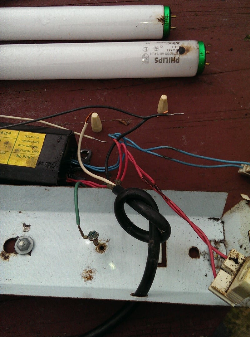

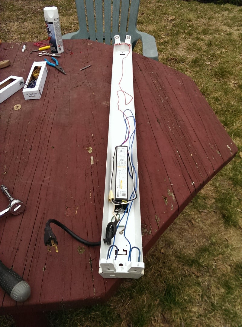

Step 4: Open the Fixture, Remove the Components
Fluorescent fixtures are usually extremely easy to service. They're designed to be opened up and dismantled, often without tools. My fixture requires only a screwdriver and a small socket to remove the ballast, the rest can be removed without tools.
Important: First things first: Either unplug the fixture, or find the circuit breaker to which the fixture is attached and open it to cut power from the fixture. Make sure the power is off to the fixture before proceeding.
  1. Open the fixture and remove the tubes.
  2. Look for a way to remove the service panel that covers the ballast and wiring. Some fixtures have wingnuts. Some have Screws. Remove the panel and set any fasteners aside for replacement.

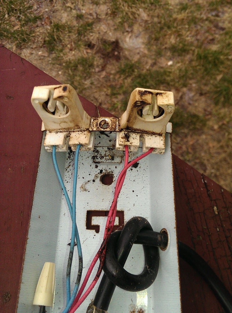

  3. Disconnect the black (hot) and white (neutral) conductors form the ballast. It's likely that they're connected with wire nuts like this one.

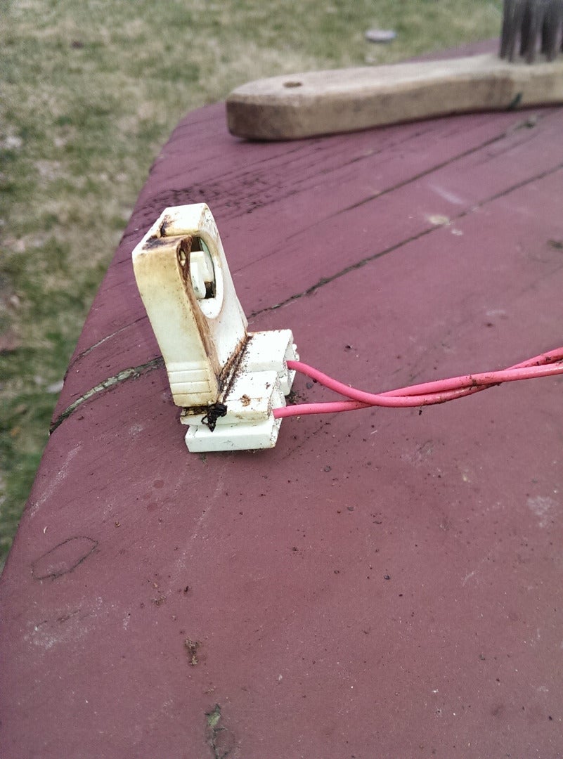

  4. The tombstone connectors should be able to be removed.
  5. Remove the ballast fasteners and the ballast should come out easily.

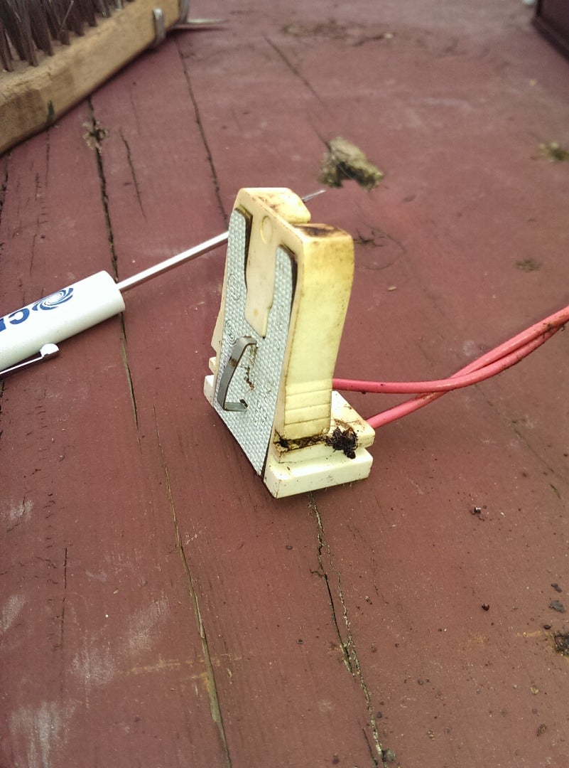

For reference, the ballast will likely have a wiring diagram printed right on the ballast itself. Follow the diagram and connect the different colors to the connectors. It's important to use the proper gauge of wire. 18AWG or 18-gauge is probably what the old ballast has in place. I believe most residential wiring codes require the use of solid core insulated wire.
These tombstone connectors are really easy to work with, and the connections are made by stripping the end of the conductor and pushing it into the hole. The wire pushes in but doesn't pull back out. There is a slot beside each hole where a small slotted screwdriver can be inserted to release the connector and allow the wire to be removed without having to open up the connector.
These connectors also allow for short conductors to be used as "jumpers" to complete the circuits described in the wiring diagram. Cut short lengths of wire, strip a bit of insulation from both ends and complete the connections according to the diagram. Pay close attention to which wires go where and where jumpers are needed.
I used the wiring from an old ballast for jumpers.
Leave the wires extended to full length at this point. Until the components are replaced, it's not clear how much slack there will be once the ballast is installed. after everything has been put back into the fixture, you can bundle the wires and make them neat.
Double-check your work and make sure everything is connected correctly. Now is the time to fix any mistakes while the wiring is accessible.

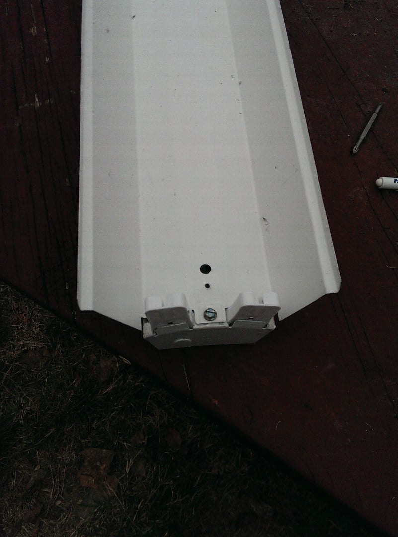

Step 6: Reassemble the Fixture
Now it's time to reverse the process. The new ballast is now connected to the tombstone connectors according to the wiring diagram.
  1. If you're working in a ceiling fixture, have a helper support the ballast while you replace the panels holding the connectors.
  2. Examine the way the ballast is secured to the fixture. It may simply use the same mounting hardware as the old one, but if it doesn't fit in the old mounting holes, drill a couple of small holes for sheet metal screws and fasten the ballast.
  3. Draw the wires together and neaten up the wiring paths to both ends. I used tie wraps to bundle them.
  4. Reconnect the hot and neutral conductors to the corresponding conductors on the ballast. Make sure the wire nuts (or whatever fastener you use) are secure. Don't forget the ground, too.
    Check your work one more time and make sure everything is installed correctly and neatly.
  5. Replace the service panel and carefully insert the new tubes.
