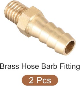

  1. M8-1.25 Male x 8mm barbed hose fitting
  2. 8mm ID hose
  3. 14mm spring band hose clamp
  4. 8mm barb x 3/4" GHT Female Garden Hose Adapter

You'll need to run a hose of some sort from your water source into the port that had been covered by the screw. It's a M8-1.25 metric thread. I bought a couple of M8-1.25 x 8mm barbed hose fittings. The screw into the port with no issue.
I found it easiest to screw in the fitting bare, then to install the hose and hose clamp afterwards, than to try to get the whole hose to rotate while threading it in.

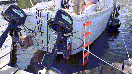

I'm doing this in a slip, with dockside water, so the other end of my hose is a standard hose adapter. If your fresh water source is something different, you may need a different adapter.
Step 3:
With the hose connected, turn on the water. You should see water spraying out of the cooling water intake.
This is, if you think about it, flooding the area of the lower around the impeller. So go and run the motor. The prop should spin, and the impeller should spin, and the impeller should push water up through the water cooling passages, through the motor, and out the pee hole.
Make sure, of course, before you run the motor, that you're not going to cut anything or anybody with the prop.
