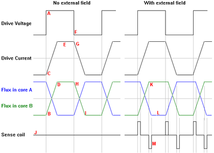

The timing diagrams above show the process in detail:
The square wave drive voltage produced by the Arduino is positive (A). The magnetic flux inside the ring starts to rise (B) and the current through the drive coil starts to rise (C). The slope of the rise in current (in amps per second) is equal to
- dI/dT = V / L
So the bigger the inductance, the slower the current rises. The current is being used to build the magnetisation inside the core. The flux density is proportional to the current.
Eventually, the core saturates (D). The magnetic flux in the core can't get any stronger. The drive current is limited by the resistance of the coil (E).
The square-wave drive voltage changes to negative (F). The current drops rapidly (G). The core starts to de-saturate (H). And the whole sequence repeats in the other direction (I).
You should think of the core having two halves – the upper half (“core A”) and the lower half (“core B”). The two halves are magnetised in opposite directions: left to right or right to left.
The voltage in the sense coil (J) is proportional to the rate of change of the flux. As far as the sense coil is concerned, the flux in the upper half of the core (“core A”) is to the left whereas the flux in the lower half of the core (“core B”) is to the right. They cancel out and no voltage is generated in the sense coil.
In the presence of an external field, the upper half of the core (K) saturates before the lower half does (L). When that happens, the two changing fluxes no longer cancel and a signal is produced in the sense coil (M). In this example, there is a short positive pulse in the sense coil just before the square (driving) wave goes negative and a short negative pulse in the sense coil just after. If the external field were in the other direction, the order of the pulses would be reversed.
In practice, the waveforms are more complicated than I’ve described. The current in the coil exponentially approaches a maximum rather than rises linearly (C). The sense coil picks up spikes from the drive coil rather than just from the core (J,M). When the core is saturated, the current in the drive coil can rises faster because it is no longer having to use its energy to make more magnetic field (E).
So the circuitry must be able to produce a square wave for the drive coil and be able to measure the sense coil pulses.

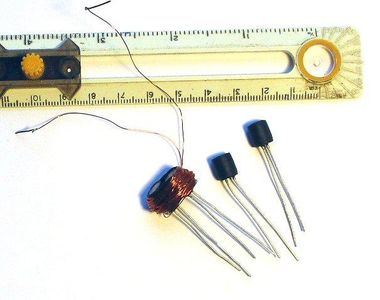

Step 4: Does a Ferrite Toroid Work?
You want the core to saturate - that's how a fluxgate magnetometer works. This Step explains the factors involved in choosing a core.
The toroidal cores you buy on eBay or wherever are being sold to make switched-mode power supplies or for transient suppression and the users don't want the core to saturate. You could make a magnetometer using such a core but you would need a huge current or a huge number of turns to saturate it.
How big should the core be? A bigger core is easier to wind. A smaller core is easier to saturate.
It can be cheaper to buy an inductor on eBay than a core. The current they quote in the advert is (usually? always?) the saturation current - it's best to look at the manufacturer's document to be sure. Let's assume you buy:

Let's say you already have a ferrite core you've salvaged from some equipment or bought on eBay. I salvaged a core which had 44 turns and 90uH inductance which gives
- AL = L/(N*N) = 0.00009/(44*44) = 46nH
Be careful of the units of AL in the manufacturer's catalog. I've calculated it in nanoHenries.
My core is
- 12mm outside diameter (OD)
- 8mm inside diameter (ID)
- 4mm thickness (h)
So if you've got a random core, wrap a few turns round it and measure its inductance. Perhaps your multimeter can measure inductance. If not, you should buy an LCR-T4 meter on eBay - it's a tremendously useful device. If you have neither, there are many web pages explaining how to use an oscilloscope or an Arduino to measure inductance.
Or you could go to eBay and buy, e.g., a 100uH inductor and count the turns. But don't. Ferrite (or MPP) cores are not that good for making a fluxgate magnetometer.

Step 5: Bobbin Inductor
Small "bobbin" style inductors are cheap and are already wound. Can we use two of then side-by-side?
I have a range of small inductors from 1mH to 100mH. The data sheet tells us the inductance, the current when the core first begins to saturate and the resistance. From that we can calculate the voltage needed to saturate the core.
L I R V
2.2mH 0.50 2.0 1.000
3.3mH 0.42 2.5 1.050
4.7mH 0.35 3.5 1.225
6.8mH 0.29 5.7 1.653
10mH 0.23 7.3 1.679
15mH 0.19 12 2.280
22mH 0.15 22 3.300
33mH 0.13 26 3.380
47mH 0.11 36 3.960
68mH 0.09 57 5.130
100mH 0.07 90 6.300
I wanted to put the two inductors in series (so the current through them is equal) and I wanted to be sure the core is fully saturated so I chose two 4.7mH inductors.
MuRata and some other manufacturers (but not all) make one lead longer than the other. That tells you the direction in which the coil is wound. If your coil doesn't tell you, put a few mA through it and watch how it affects a compass.
Tape the two cores together and wrap, for instance, a hundred turns around it as a sense coil. Connect the coils in series to the H-bridge driver and send a 1kHz square wave through it. You can use the circuit in the previous Step. Make sure the coils are connected so the fields they produce oppose each other.
After I'd wound the sense coil, I found it picked up slightly more field from one coil than the other so I added a resistor in parallel with one coil to balance them. For me that was 180ohm.
The result? It didn't work.
The sense coil hardly measured any external field. It would sense something if I brought a strong neodymium magnet close to the cores but that was probably because the external field from the neodymium magnet was itself saturating one of the cores.
Why didn't it work? Maybe the MuRata inductor is designed not to leak much field. Inductors are often placed near to each other and you don't want the field from one to affect another. If the inductor doesn't leak much field to the outside then it won’t absorb much field from the outside.

Step 7: Saturated Core Magnetometer
I suspected that the noise in the fluxgate magnetometer to be mostly due to the op-amp and the ADC. It might be due to all the equipment I have nearby but I don’t think so: mu-Metal or electrical shielding made no difference. It also might be Barkhausen noise. Is it possible to make a magnetometer which does not require an ADC?
Imagine a core that is alternately magnetised to saturation in one direction then in the opposite direction. When the driving voltages switches direction, the current through the coil, and hence the degree of magnetisation, will start low and gradually increase. The degree of magnetisation will stop rising when the core saturates. If there is an external magnetic field then the saturation will happen sooner.
As the core saturates, there will be a smaller back-emf generated and the current will rise faster. The back-emf is what makes an inductor have inductance so a smaller back-emf means a smaller inductance. We could measure the inductance and, when we see it fall, we know the core has saturated. The amount by which it has fallen is a measure of the external field. Alternatively, we could measure the current through the coil. It will rise faster on saturation so we could measure the current to measure the external field. Or we could measure the rate of decay of the field when it the coil is switched off. Magnetometers using all of these effects exist but I'd prefer one using less analogue circuitry.
Perhaps we can use the timing of the saturation to measure the external field. If there is an external field, it will happen sooner in one direction than the other.
We now wrap a second "sensing" coil around the "driving" coil to make a transformer. The voltage in the sensing coil is proportional to the rate of change of the magnetic field in the core; there's also a smaller contribution directly from the driving coil.
The field increases more or less linearly until saturation at which time it stops increasing. So the sensing coil will produce a square pulse which drops to zero on saturation. The width of that pulse will depend on the external field. It will be shorter when the external field is in the same direction as the driving field and longer when the external field is in the opposite direction.
I wound a driving coil of 600 turns of 0.25mm wire on a 4mm*0.2mm "electrical steel" core. (The steel from a transformer in Step NNN.) Then I wound a sensing coil round it of 100 turns. It might have been better to put the sensing coil inside the driving coil - I didn't try that.
The circuit diagram is shown above. The Arduino code is in Magnetometer3.ino (download below, remember to turn off warnings). You can look at the "oscilloscope trace" using Magnetometer.exe on your PC (or you could use an actual oscilloscope).
You can see the pulse from the sensing coil. It varies in length depending on the external field. I think the initial spike is from the field generated directly by the driver coil. The following (fairly) constant voltage is from the field building-up in the core. And the drop is when the core saturates. With an external field, the positive-going pulse gets shorter and the negative-going pulse gets longer (or vice versa).
The Arduino sends the ADC data to the PC to give us an "oscilloscope" trace of the output from the sense coil (using Magnetometer.exe). It allows us to estimate the time-to-saturation. If it's the wrong sense (i.e. positive when it should be negative) then reverse the connections of the sense coil.
The drive pulses are approximately 2000uS long and the time-to-saturation for my coil is approximately 300uS. Your coil may be different. If the time-to-saturation is longer than 2000uS then you should alter the sketch to lengthen the drive pulses - maybe by putting some NOPs in the 'for' loops of the GetADCSamples() function.
If the time-to-saturation is a lot shorter than 300uS then when you measure its length, the resolution will be poor. You should be able to increase the time-to-saturation by adding more turns to the drive coil. The rise-time of the current of the driver is proportional to inductance and inductance is proportional to the number of turns squared.

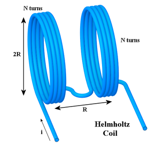

Step 9: A Helmholtz Coil
So far, I’ve used the Earth’s magnetic field to calibrate the magnetometer. A better way is to use a Helmholtz coil.
A Helmholtz coil can be made from copper wire wound onto a piece of plastic pipe. The coils are close-wound with the distance between them equal to the radius of the pipe. The space inside the pipe contains a fairly uniform field whose strength is:
- B = 0.9 * N * I / r
where
- r: radius of the coils in mm
- N: number of turns in each coil
- I: the current in mA
- B: field in uT
The correct value of the constant “0.9” depends on who you ask. It may be 0.899176. The field is only uniform to within 1% over the central region so your calibration will never be better than that.

It’s possible to make a magnetometer by winding your own coils on a core made of “electrical steel”. The magnetometers are easily capable of measuring the Earth’s magnetic field (50uT). The noise level is around 0.5uT.
Is it worth it? Probably not. I compared the results with the output from a HMC5883L 3-axis magnetometer chip using the sketch kindly published by Adafruit. You can see the result above.
I measured a noise level of around 0.2uT which is what the datasheet says.
The HMC5883L is not the most sensitive chip available, it’s just the one I happened to have. I tried to make a list of available magnetometers and their noise level.
