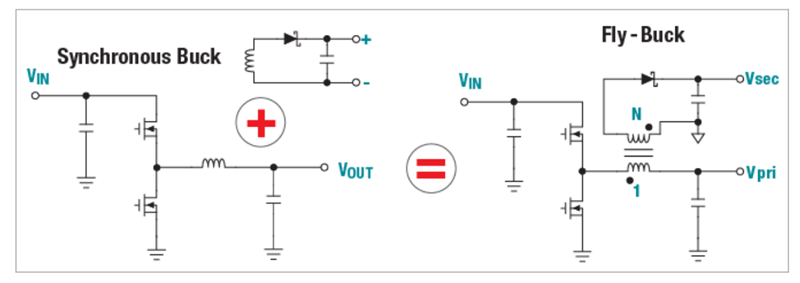

Step 2: Fly-Buck Converter:
The fly buck converter can provide an isolated voltage output which is why it is also named an isolated buck converter. A simple buck converter with the addition of another winding inductor to form a coupled inductor, a Schottky diode, and a capacitor forms a fly buck converter. One side of the inductor is primary and the other side is secondary. This converter is useful where multiple outputs are required from a single output supply like +/- 5V, +/-9V can be created from a single fly buck converter. It is a low-power, low EMI buck converter.

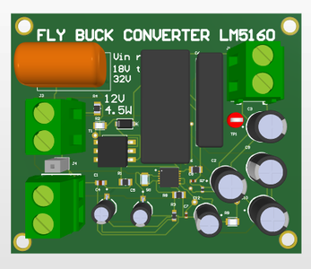

Step 6: Schematic:
For the schematic diagram, I have used Altium software. First, I have designed symbols and footprints of each component because it’s a good practice to start with designing symbols and footprints. Then I have uploaded my symbols and footprints libraries online on Inventhub where users can view them, download them, or use them in their design implementation. Users do not need to design the components for their design. Thus, it can save time.
After completing the designing of components. I have used them in my schematic to complete my design. I have uploaded my schematic file for the users and viewers on Inventhub.
Step 7: PCB:
To fabricate my PCB, I have converted my schematic file to the PCB file so that I can design a board, connect my components, and can visually view my board in 3D. Along with it, I have uploaded my PCB file on Inventhub where the manufacturer can view or download my PCB file for fabrication of my board.
For the manufacturer, I have created a release of my project which contains all design files including schematic, PCB, and their component libraries. Instead of visiting my manufacturer, I can send him the release of my design files. He can view or download files in ZIP format and can fabricate my PCB without any errors.
