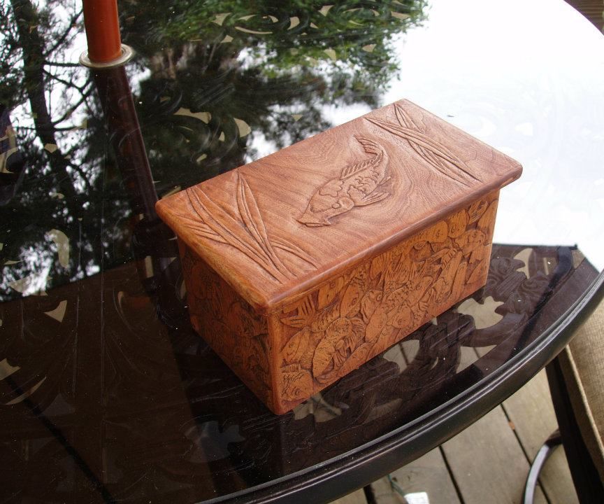

At this point in the process use the CnC to engrave the lid, you may want to add a design or image to the lid of the box. This can also be done in the CAD software, there are many ways to center the image or design. On my Box I just left the natural grain and did not engrave it. But that is personal choice, and the ones I sent out as gifts I used the CnC engraver or Laser etched an image.
