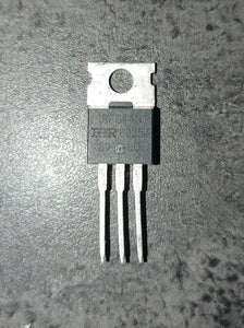

3. IRFZ44N or IRFZ46N mosfet

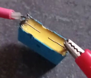

4. A 3.3uf 2000V-10000V high voltage capacitor (for nice loud sparks)

Add a 3.3uf 2000V-10000V Ceramic capacitor to the output and make a spark gap (mine jumps from around a centimeter on a fully charged battery).
This should give you louder sparks.

- The mosfet gets really hot really fast (I fried 2 within 20 seconds of continuous runtime without a heatsink).
