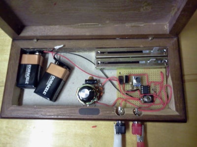

so i thought i would set out to make a plasma speaker! SO one chip i know well is a LM555 so this is my base! one pin most often skiped on this chip is pin5 it s the voltage control oscillator. all that is needed is an audio signal to this pin to get pwm

Step 1: Parts List
99% of the parts can be obtained from http://www.allelectronics.com/
1 3.5MM MONO OPEN AUDIO PHONE JACK
1 SPDT ON-ON MINI TOGGLE SWITCH
2 9V BATTERY SNAP, I-TYPE
1 Heatsink
1 Lm555
1 8pin socket for the 555
2 20k pots
1 10k trim pot
1 100ohm pot
2 1n4148 diode
2 1k 1/2 watt risistor
1 ADJ. POS. REG.
1 2n3055
1 .001uf cap
1 .03uf cap
1 Gi2404 diode
othere parts needed
2 9v batteries
1 16v 3 amp DC power supply
1 FLYBACK TRANSFORMER
1 audio signal you may need some type of amplifier if you use a weak signal like a cell phone or weak mp3(im using an old raidoshack amp)

Step 2: Schematic
note the batts ground and the power supply ground are hooked together

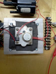

Step 3: Heatsinking
mount 2n3055 and gi2404 diode to a large heat sink

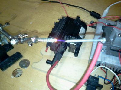

Step 4: Find the Flyback Pin Outs
this set shows you how to find you flybacks pin outs
http://lifters.online.fr/lifters/labhvps/tht.htm
Step 5: Last Chance to Rechk Everything
ok so now that your allset start with the 0v and hv out about 1/4inch apart then slow move back till you get a longer soft spark if it go wild move it closer
