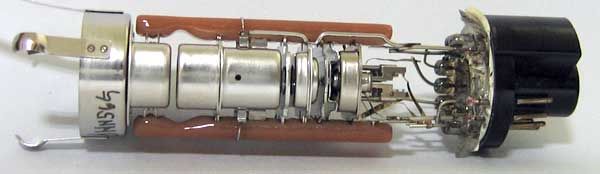

Step 1: Creating an Electron Beam
The electron beam is created in an "electron gun". A wire filament is heated strongly in a vacuum, and in the presence of a high voltage. Electrons liberated by the heat and voltage are accelerated down the tube and attracted to the screen, where they stop suddenly and cause a phosphor to glow.

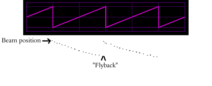

How do we scan the beam ?
Well, an electron beam is a current, a current passing through a magnetic field experiences a force at right angles to the direction of both the field and the current.
So if we create a field, at right angles to the beam, we can cause the beam to bend, and scan.
If a current passes through a coil, it creates a field, if the current increases linearly, the field follows, if the field follows, the bending in the electron beam follows linearly too.
....we need a linearly ramping current
Oh, and at the END of the scan, it would be really nice if the trace flew back VERY quickly, so fast you can't see it happen. That's the "Flyback"
Wikipedia: Raster scanning

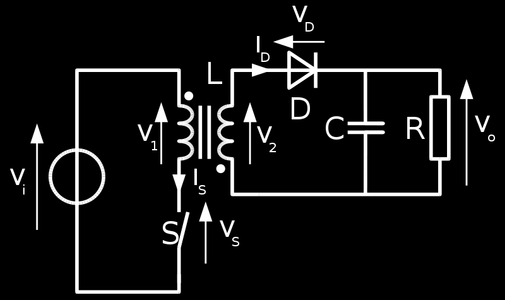

Here is the topology:
The flyback TRANSFORMER is something of a misnomer. In a classic transformer, changing currents in the primary induce changing currents in the secondary. In a flyback they specifically do NOT
WHY not ?
See the diode in the secondary ? Current can ONLY flow in the secondary....when none is flowing in the primary.....EH ?
So, lets start the circuit, and switch on the transistor under the primary - here its a switch, S, what will happen ?
Current will start to flow in the primary (Is). Since the secondary has a diode in series with it, NO CURRENT FLOWS IN THE SECONDARY....and current ramps.....linearly.....
Put the coils to deflect the electron beam in series with the primary, and that beautiful LINEAR ramping current (see step 7) will cause our beam to scan left to right smoothly.
Score +1 - we have a linear ramping current.
Oh, and STORED ENERGY IN THE MAGNETIC FIELD = 1/2 x L x I^2 Remember that bit.
WHY not ?

NOW turn OFF the current. What happens ?
WHERE DOES THE ENERGY GO !!
Step 5: MAGIC !
NOW, there is energy stored in the magnetic field in the core. It has to go SOMEWHERE, and it can't go into the primary, because we switched it off by opening S......
The great trick is the collapsing field will now induce a voltage in the secondary - moderated by the turns ratio - usually very high, and aided by the fact that because we are taking energy from the field, it collapses very quickly.......
.....so the current in the primary FALLS very quickly, and the electron beam jerks suddenly to the left.....
Score +2
Score +2
Step 6: ZAPPED !
The rapidly collapsing field induces a current in the high turns of the secondary.....and the high voltage on the secondary pumps up C is used to drive the electron gun and the tube......

Step 8: Gotchas. That Diode !!
The reverse biased diode on the output is VITAL. It makes the circuit work, and it MUST be connected so that energy ISN'T pumped into the secondary during the charging phase - omit it, and you have a normal transformer.
