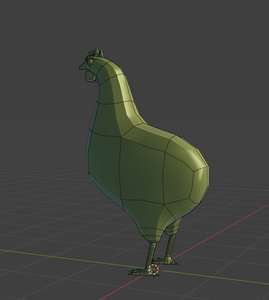

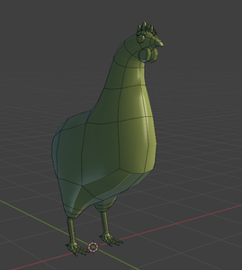

Once i found how my chicken going to look like. Then I start modeling. I started With a cube and went to edit mode to block out the body shape that i want the chicken to look like. I also add subdivided to smooth the shape .
Step 3: Detailing
I didn't add chicken eye. So i just came out with this ideal. As for the wattles and the comb are just simple cube and I make the comb into triangle shape. The beak is add in the end and have to make the mouth into cone shape.

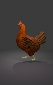

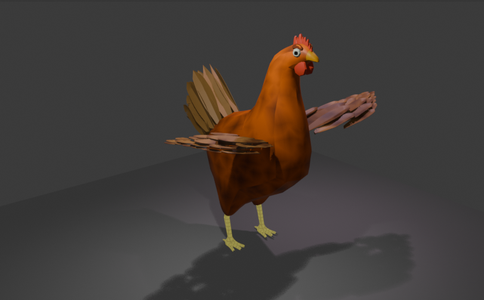

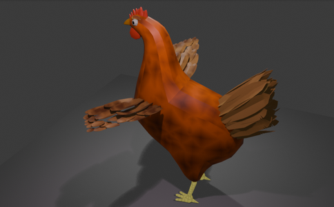

And here is the chicken.

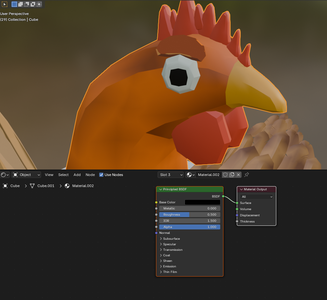

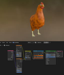

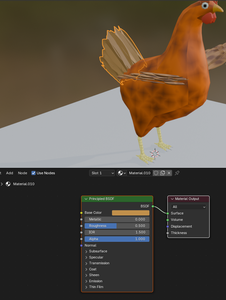

TEXTURE: I learn how to texture by follow and see how people did it on video. I did most of the texture on the chicken and here it is how i did it. This is the chicken body texture.
Now, This is the feet, the pupil, The eye brown, and That is the selera. These texture is same on the toe nail (chicken).
Here is the wing texture and the back feather!

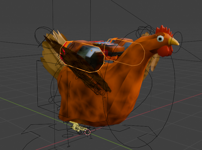

You can see how the chicken looks like on viewport shader.

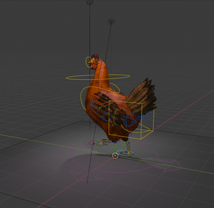

Step 6: The Rig
This is the rig. It have some problem on the rig that need to be weight paint with the chicken.
Once done it should look like this.

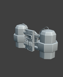

Step 7: ROCKET BOOSTER!
Now for the next modeling that i did. THE ROCKET BOOSTER! This is also see in some few picture form website to model these jet pack.

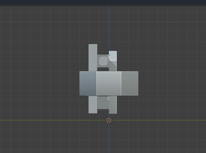

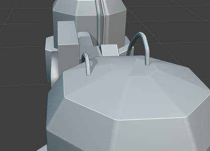

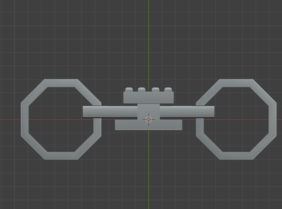

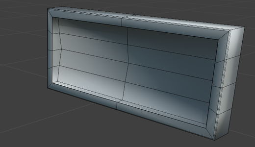

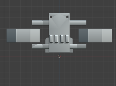

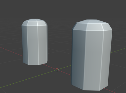

Step 8: Cylinder Shape
Here is the cylinder shape for jet engine.

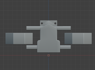

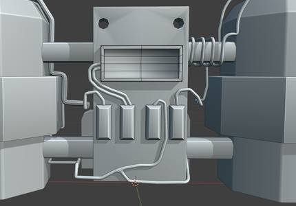

This is the front view where i add as a display monitor behind the jet pack.

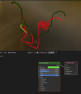

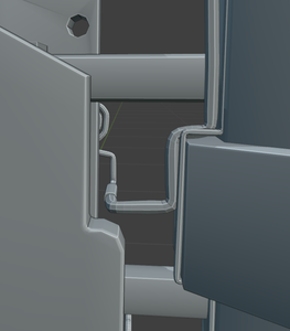

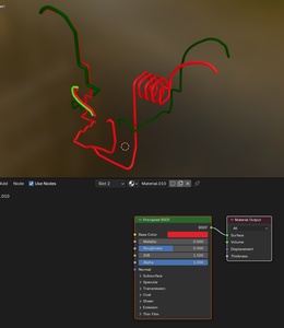

Step 9: Wire
These is the wire that the i model. I add point, skin modifier and subdivide modifier. To make this wire shape.
I add some chicken wire patch over here. Can you see it?

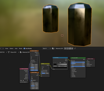

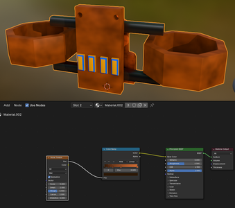

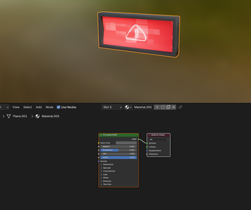

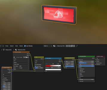

ROCKET BOOSTER TEXTURE: this is the same texture that I use to texture the chicken. But i tweak and play around with the setting to make this cool looking jet pack. So this is the monitor screen texture.
Step 11: Jet Engine Texture

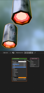

This is the jet engine texture.
Step 12: Fire Texture
This is the the fire texture.

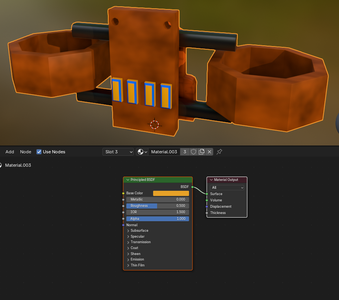

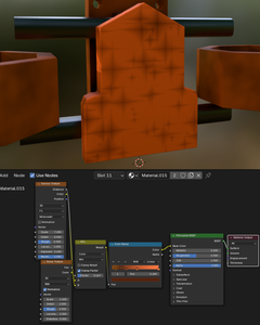

  1. the brown frame that i texture
  2. circuit texture.
  3. chicken back cushion texture.

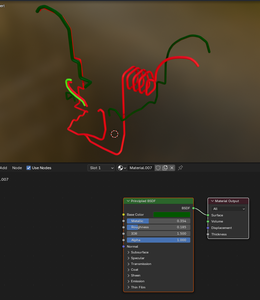

Step 13: The Wire Texture
This is how i texture the wire.

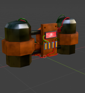

Step 14: Jet Pack Done!
Here is the jet pack picture.

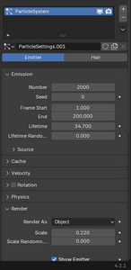

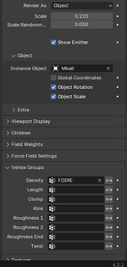

Next is add some effect on the booster. So i click the jet pack engine and go to practical setting .

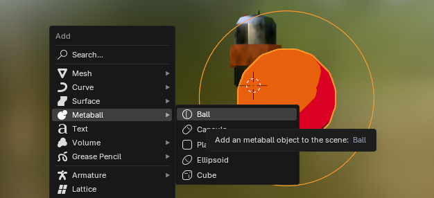

Step 16: Fire Ball Thing!
I add the squish ball thing. Well I went to the add setting and found the Meatball.
This is how i texture this fire looking fluid.

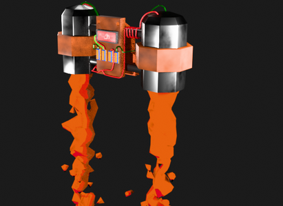

Step 17: Jet Pack
Once this is done, I went to add this to the jet engine and now have fire effect on the jet pack.
Here is the jet pack flying picture and video .

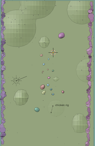

Step 18: ANIMATE
I block out how the scene should look like. But only I want to focus on the chicken. So there are not much thing in the scene.
