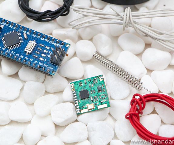

- 1 Receiver HobbyKing OpenLRS 433mhz http://www.hobbyking.com/hobbyking/store/__27096__OrangeRx_Open_LRS_433MHz_9Ch_Receiver.html - price: 20 usd

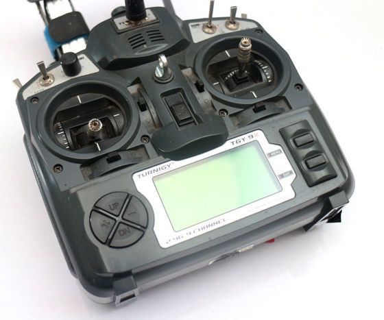

for transmitter you can use cheap Turnigy 9x with 9channel with price tag around 60 usd http://www.hobbyking.com/hobbyking/store/__8992__Turnigy_9X_9Ch_Transmitter_w_Module_8ch_Receiver_Mode_2_v2_Firmware_.html and transmitter 10 usd TX OpenLRS http://www.hobbyking.com/hobbyking/store/__40032__OrangeRX_Open_LRS_433MHz_Transmitter_100mW_compatible_with_Futaba_radio_.html

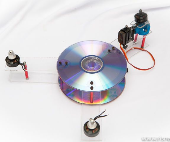

For each arm we must use 2 CD's to make it strong enough when it fly. To cut through these discs you can use mini grinder with carbide. To make it easier you can draw the lines on these discs before cutting it. From top view, you can see that the shape of these arms blended with the center plate. In this steps these arm still very light and easy to bend, just wait until we put the bottom plate.
For each motor we can use acrylic then using 2mm bolts. 3 bolts is required to make the motor stay still in the center of these disc.
Step 4: Bottom Center Plate
There is no much components in this section. I only put the battery 3S 2200mah and OpenLRS receiver. To connect with top center plate use these holes and put 8 spacer. For safety battery strap is used for both side of the battery.
