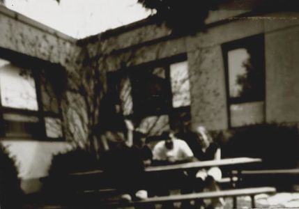

Step 4: Sample Photographs
You can achieve some pretty complex effects even with these very simplistic cameras. You shouldn't expect amazing clarity since your camera doesn't have a lense to focus the light, but you can get some very good pictures.

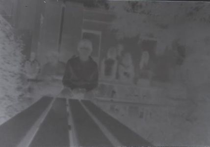

Negatives
Just to clarify, when you actually take a picture (when not using a digital camera) the picture inside the camera is actually called a "negative". This means that the image appears opposite of the real world. This occurs for several reasons. The film captures the image because light bounces off the object you are taking a picture of and enters the aperture (hole in the camera).This light then comes in contact with the film that is covered with a special coating that is light sensitive which turns black. The areas that do not turn black and remain the color of the film occur because light was not reflected off of those areas of the object. These areas are most likely darker colors because darker colors absorb light where light colored objects reflect more light.

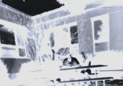

Converting Negatives to Positives
To get a picture that resembles real life or a "positive", the easiest way I have found is to have my students scan the negatives into the computer and use microsoft paint to "invert the colors". By reversing a negative you will get your posistive.

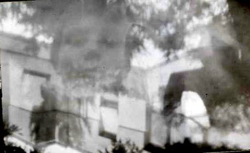

Double Exposures
Double Exposures occur in a camera where the film doesn't shift to the next slide and you essentially take two pictures on top of each other. You can create double exposures with these cameras by doing the following:
- If your f/stop is roughly 30 seconds (how long you leave open the shutter and expose the film to light) you would take the first picture for 15 seconds and then close the shutter. You could then move the camera or leave the camera stationary and move yourself and take a second one.
A good example is the first picture at the top.
