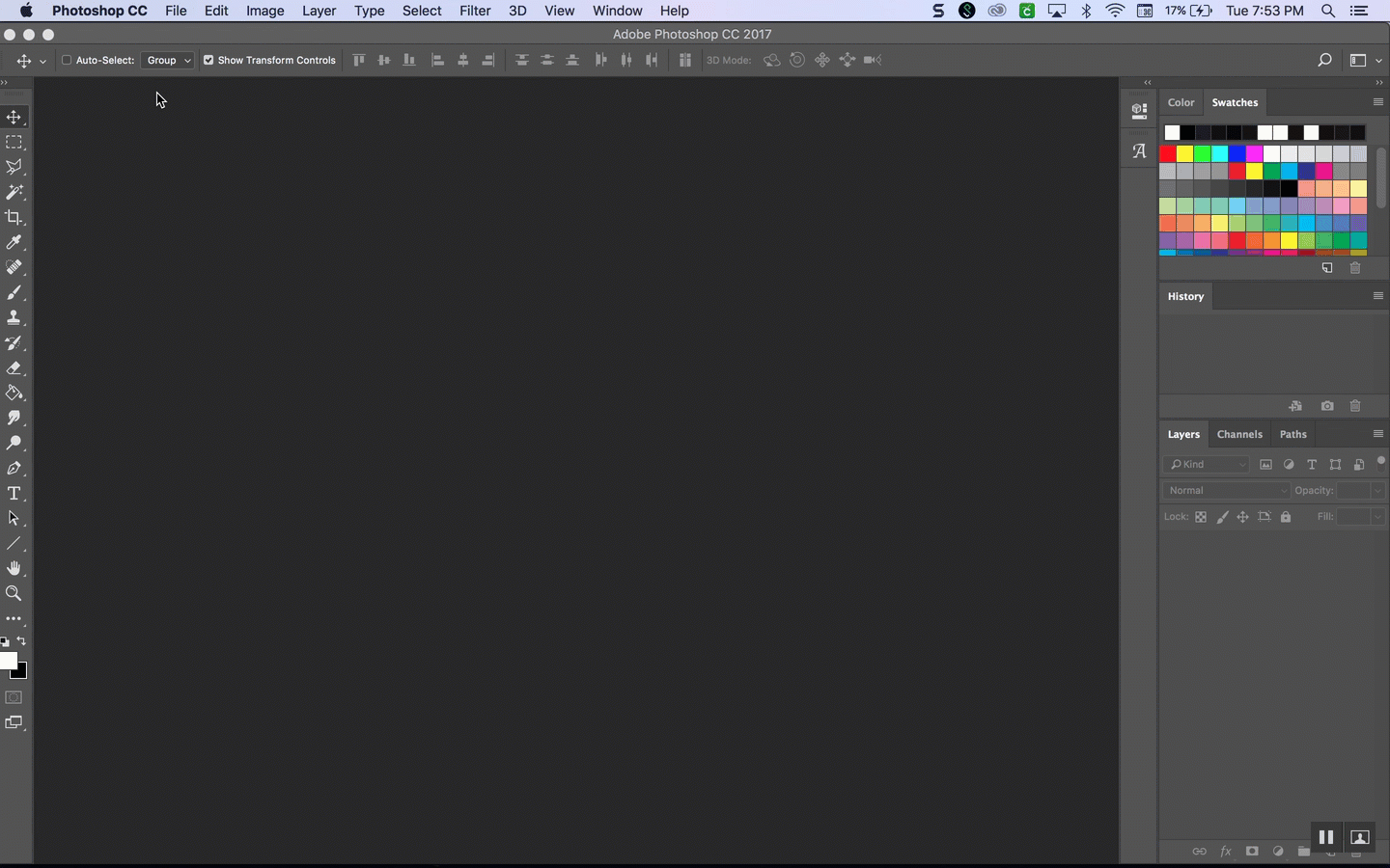

Step 2: Load the Image Sequence
The first step is to load the image sequence into Photoshop as a series of layers.
On the top app menu, navigate to File --> Scripts --> Load Files into Stack...

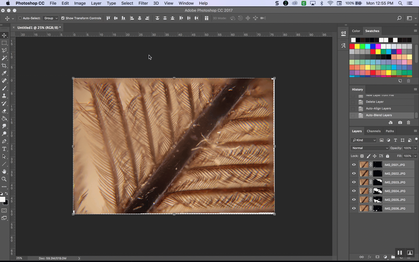

Step 4: Blend the Layers
Now is time to blend all of the layers together into one image.
On the top app menu, navigate to Edit --> Auto-Blend Layers...
When the new window opens make sure that Stack Images is selected and the checkbox on the bottom that says Seamless Tones and Colors. Finally, click OK to blend the layers together.

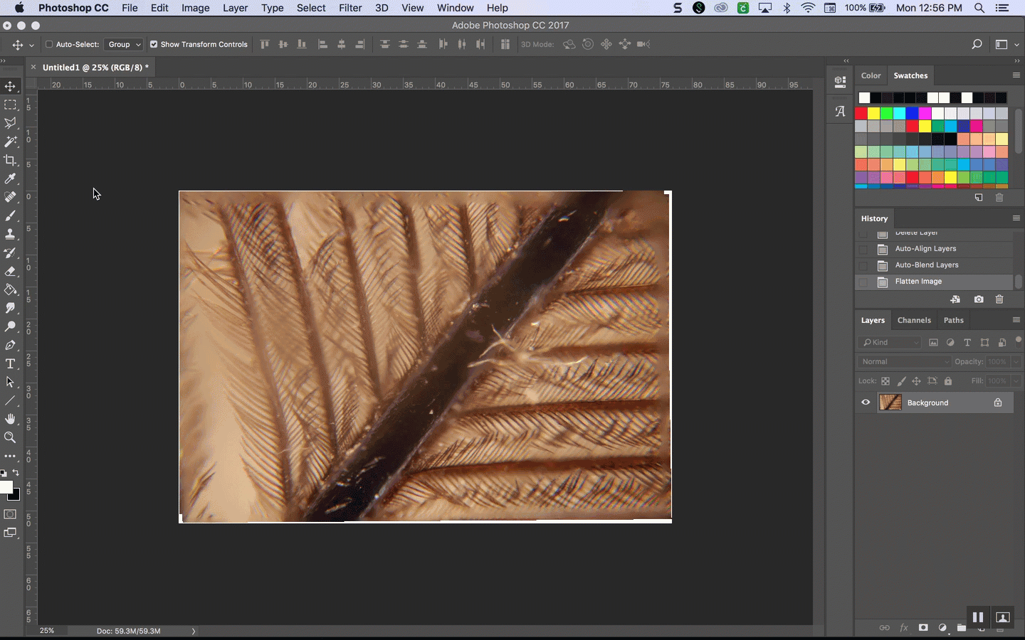

Step 5: Flatten the Image
The next step is to flatten all of the layers by going to Layer --> Flatten Image. This will remove the transparent background and combine the entire image stack into one image.
