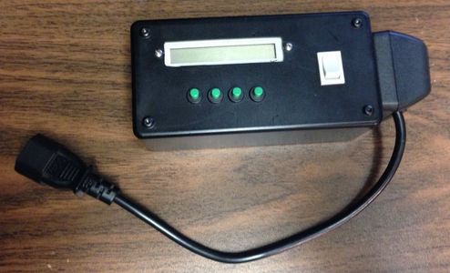

First thing was to see whats inside the remote pendant. Wow, a switch and a light. that's easy. It uses a standard computer IEC connector so I don't even have to hack up the original cable. I had a couple of IEC jumpers laying around.

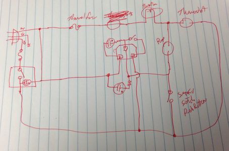

I never take the easy way out when it means there's a gadget that wont be built. From the way it's wired the white and black wire are connected directly to the power line. That's great since it means I can use them to power a small transformer to run the micro-controller. That opens up a whole bunch of possibilities.

There is a warning in the manual to not hit the button before the light goes out. Oddly the pump is wired across the thermostat so it wont get any power until the machine is hot. That kind of eliminates the need for the ready light since the controller can pulse the thing all day long and it wont hurt anything.

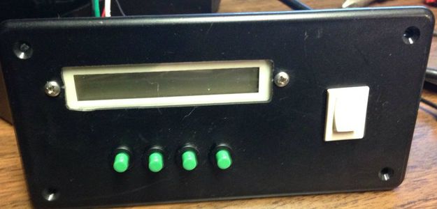

I added it anyway so the LCD can show a status of "Heating" or "Ready" along with the timer settings.
The UI is simple 4 pushbutton switches Dur+ Dur- Int+ Int- to set the duration and interval and a toggle switch to turn it off. The duration is in millisecond increments. and allows for 100 to 1500 milliseconds (.1 to 1.5 Seconds). The interval is in second increments and allows for 30 to 600 seconds between pulses. These limits can easily be changed.

Step 4: Schematics and Code
I wrote this in PicBasicPro. I also uploaded the hex file if you want ot use it as is. There is a free student version of picbasic available online you can use if you want to make changes.
I tried redrawing the schematic but its still a little sketchy....
You can omit the pullup resistors on the front panel switches since the pic has internal weak pullups. I like to add 1K resistors anyway.
I used a 10Mhz ceramic resonator in place of the crystal and 2 caps on pins 9 & 10. Either way is fine. When I tried to test it with a stop watch I got a measured time of 1 minute & 59.96 seconds when set to 120 seconds. Close enough for me....

I used a small wall wart and attached it to the side by using longer screws through the existing screw holes. This keeps it neat and simple.
Its really handy to have some small screwdrivers to get in there and tighten those screws.
Its looks pretty neat and the original cable exit is perfect for the power cord.

The board was left floating in the case. I should mount it but I'll have to wait till after Halloween to do that.
I used a 16F73 micro-controller that doesn't have eeprom so there is no permanent setting storage. The next version will get and upgrade to a 16F876 which has non volatile memory. Then when you change the interval and and duration it will be stored for use at the next power up. Right now it always defaults at power up to 750 mS pulses every 150 Seconds.
The two chips are pin compatible so its just a firmware update needed.
I did add a status led that blinks when it operating so I have a heartbeat. Next version that changes to a bicolor led so its either a green heartbeat, a yellow standby indicator, or a red error indicator...
Its not pretty and nothing is labelled yet but its fully operational in time for Halloween!
