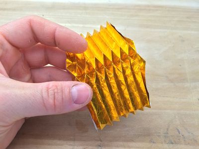

Step 10: Collapse the Central Crease
From here on out, we're going to be using the creases that we've created to fold the model into its final form.
To begin, use the orthogonal creases which run at right angles to the ones that you created in the previous step to fold alternating mountain and valley folds all the way across the paper. Press tightly and then spread the paper back out a bit, but not completely.
Now, use the centermost crease from the previous step to create a valley fold while simultaneously creating locking folds on the underside of the paper. This is a bit tricky, so take a look at the embedded video to see exactly how it is done. When you're finished with this step, the paper should look like a series of ridges with a ninety degree bend across its middle.
Step 11: Fold Down Along the Adjacent Diagonal Creases
Reverse all of the ridges by folding the paper along the zig-zag of diagonal creases immediately adjacent to where you were working in the previous step. This is another tricky fold, but a careful look at the photos should tell you everything you need to know.
Once you've finished all of these folds, press tightly to set them in place and spread the paper back out a bit.
