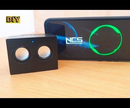

Introduction: Foldable 360 Bluetooth Speaker
Homemade surround fold speaker, multi directional soundbar, check the video above for see it working.

This project was a lot of fun for me to do it, i never seen any speaker like this one before, i guess this is the world first foldable speaker !!
It sounds great and i realy liked the end result :)
