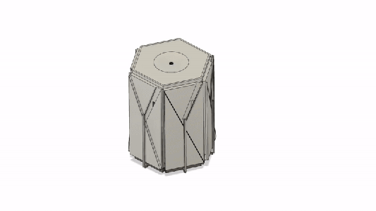

As I sketched my design, I settled on having a central hexagon, and wall and roof segments that fold outwards from this central hexagon.
Step 2: House Design and How It Folds
My design features a central rail system that unfolds from around the central hexagon. The rails play a key role in ensuring the walls are properly aligned. The end of each rail has a wide segment to prevent the walls from sliding too far and falling off.
After the rail system is unfolded, the six primary roof segments must be lifted to approximately 80 degrees. This will allow the walls, which are then slid along the rails, to unfold. Each of the six primary wall segments consists of three accordion folded wall sections. The first panel is trapped at the end of the rail, while the other two, which have wider rail openings to fit over the wide end, are then unfolded to the right. Before the walls are fully unfolded, the twelve separate floor panels must be added in between the walls and the central hexagon.
Next, the primary roof segments can be lowered onto the top of the walls. The two triangles that rest on top of the primary segment are unfolded to either side. Then the six other roof triangles, which are transported separately, are added to fully lock the roof in place.
The last construction step involves attaching the separate triangles that go between the supporting roof and the supporting walls.
To ensure that the design is rigid, I utilized locking hinges throughout the design. I also used what I had learned from my physics class to check that all of the forces would balance. I saw that the roof would want to cause the walls to slide inwards, so I utilized the floor to hold the walls in place.
Step 3: CADing My Design
I CADed my design with Autodesk Fusion 360, as that is the CAD software I have the most experience with. Throughout the process, I learned how to utilize joints to combine components. By making the joints revolve, I was able to simulate the hinges in my design. Thus, my model is able to fold and unfold in Fusion 360.

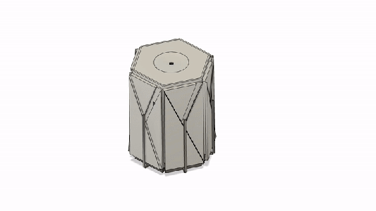

Step 8: Animating My Design
I wanted to showcase how my house folds and decided to use the animation workspace in Fusion 360 to do so. I made sure to animate each step in the order they should be performed in so it is easy to see how my house can be assembled on site. For time and ease of understanding I animated each of the six panels moving together, but in reality this would not be the case. A few people, who do not need to have a construction or engineering background, are able to move one panel at a time to unfold the house. It would be the equivalent of assembling a giant IKEA cabinet.
