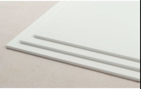

Step 2: Making Body
- paste the body print on acrylic sheet
- cut it out
- you can also use wooden plates
