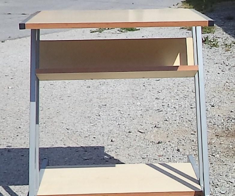

I want to explain to you my way of working. I decided to make sawhorse because I need them for my workshop. I was thinking of a wooden or metal variant. I wanted to make it simple and better. I did not think about how to do it. Then I started to »accidentally« receive the material. I got the housing from the couch, I found a frame cupboard with hinges, I got metal parts from the windows, my friend gave me two decorative battens. So I had everything except small material. When I was watching this material, I got the idea of how to make sawhorse.
1.1.Housing from the couch
1.2.Lower parts of the couch housing
